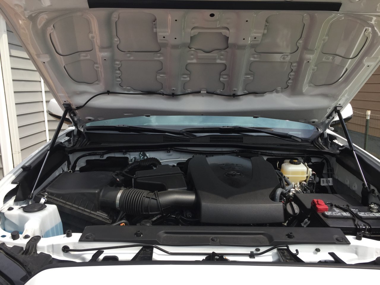

    You know some folks, a competitor I believe, mentioned concerns about hood flex. Now I know I received my engineering degree in the 70's, and maybe the rules have changed. But looking at the above photo shows a darned well reinforced hunk of sheet metal forming the hood.

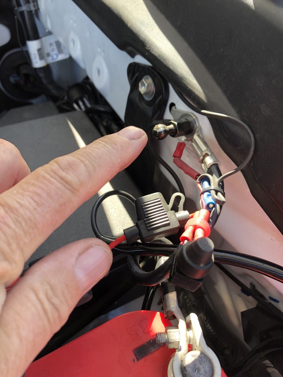

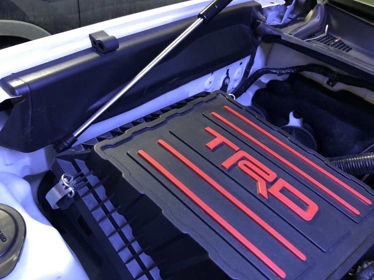

    ED48DB0B-90C0-415C-9B33-9A8F8E845647.jpg 5991D196-71AC-4C5D-B49A-8A39CAEFAA1B.jpg
    I must be a dummy because no matter what side the short one goes on they are both too long with the hood open against the stop. Are they adjustable. Model D2R8.

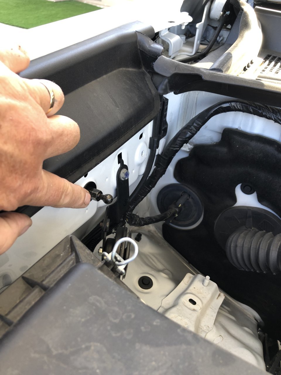

    So you got your passenger side strut anchor ball in the wrong spot. See pic...

    Good Catch - yeah it's the hole above the one you have it in.

    @poopshute
    Odd numbered beers on me! Didnt see that hole under the weatherstrip. Have a great weekend!
