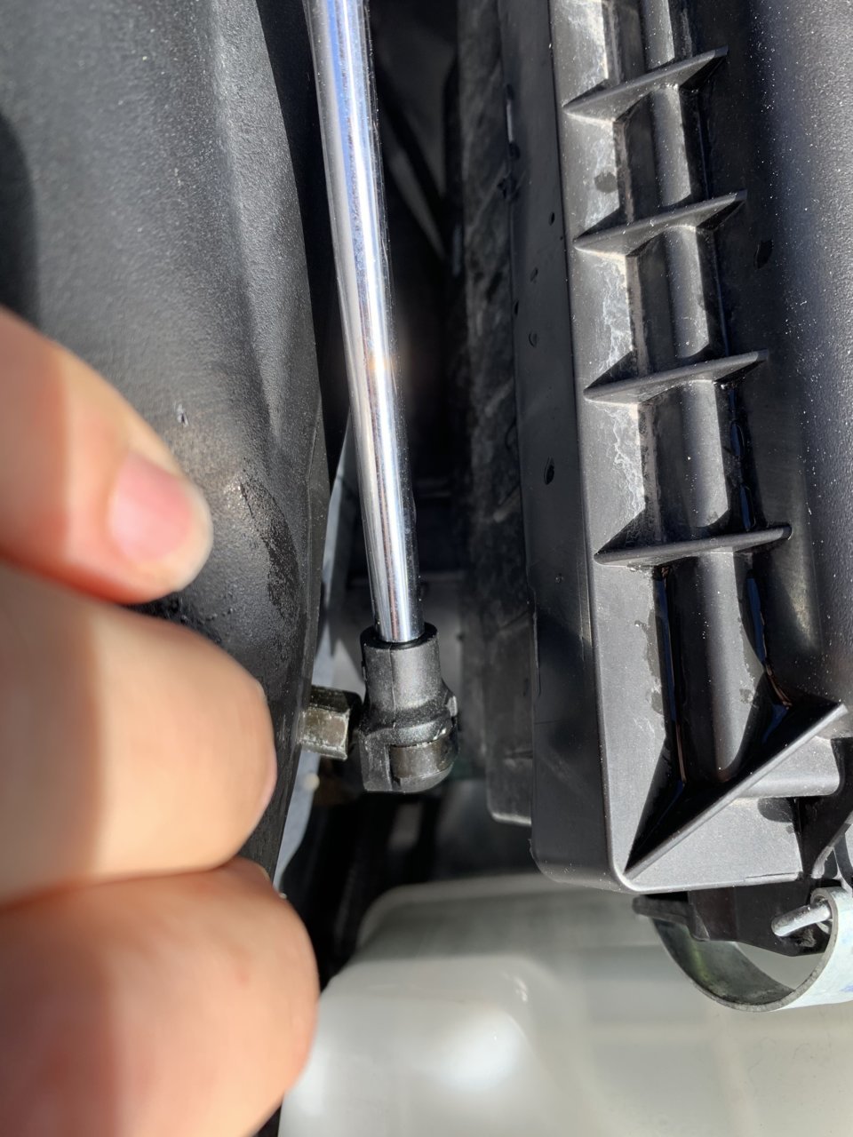

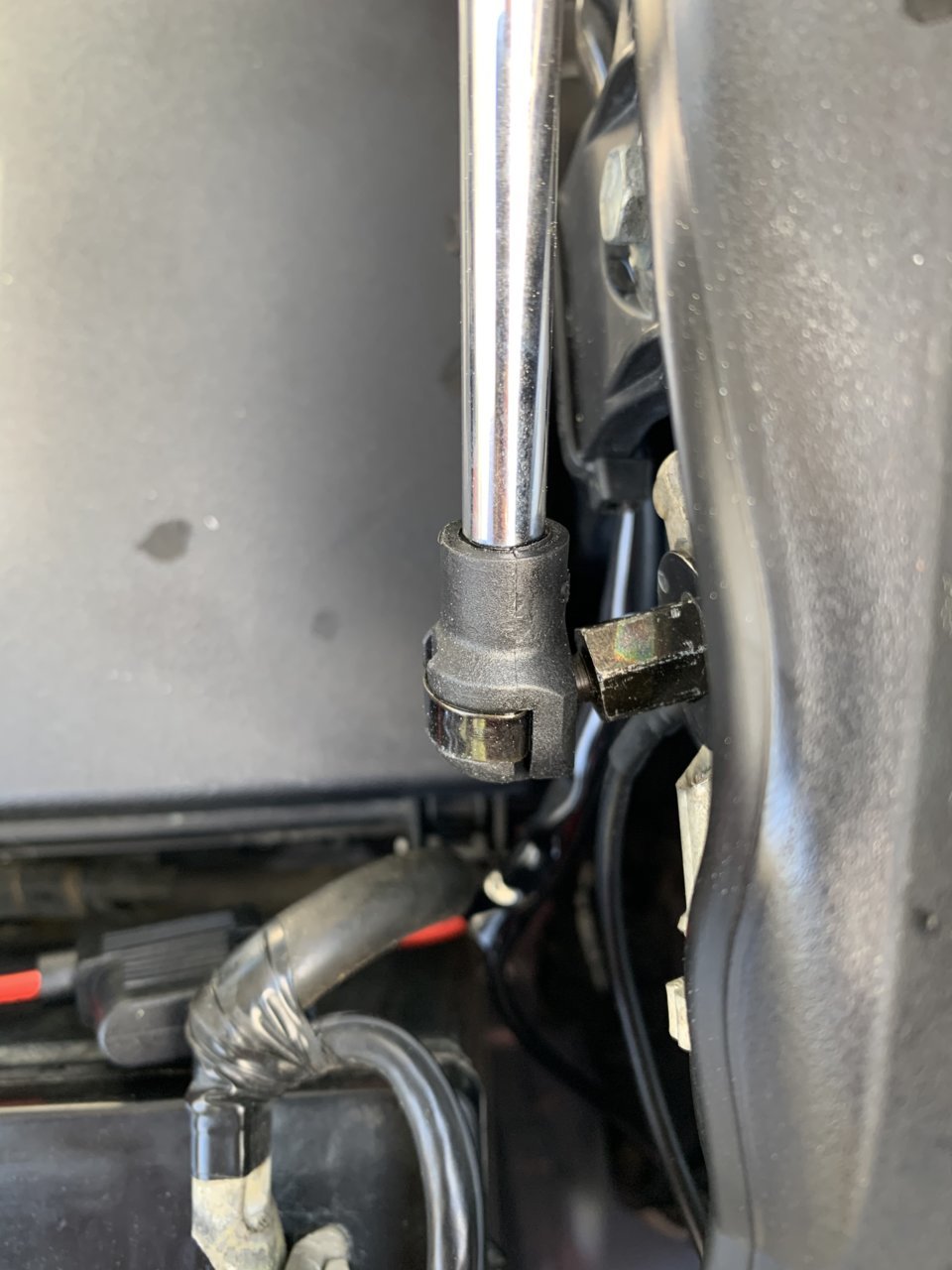

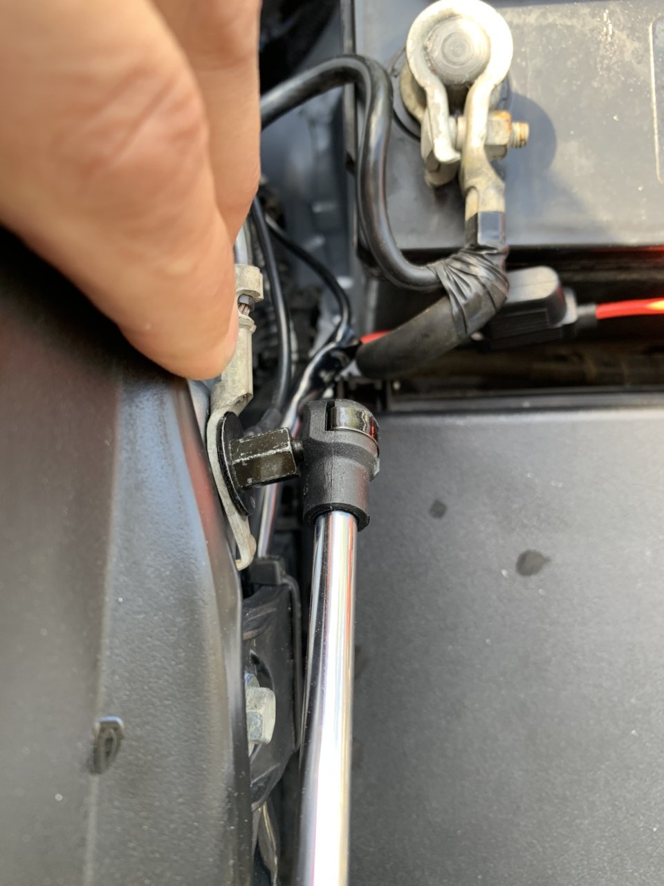

    Hi - new to signup but I’ve been reading the forums since I bought my truck in December. I installed these about a month ago and while I like how they work, I am concerned about the lower mounts. The driver side is worse then the passenger. Here’s some pictures on mine. I hope they hold up. They definitely push the lower mounts forward, but I hope they find their happy spot and just stay like that. We'll see. I dont have any play side to side.

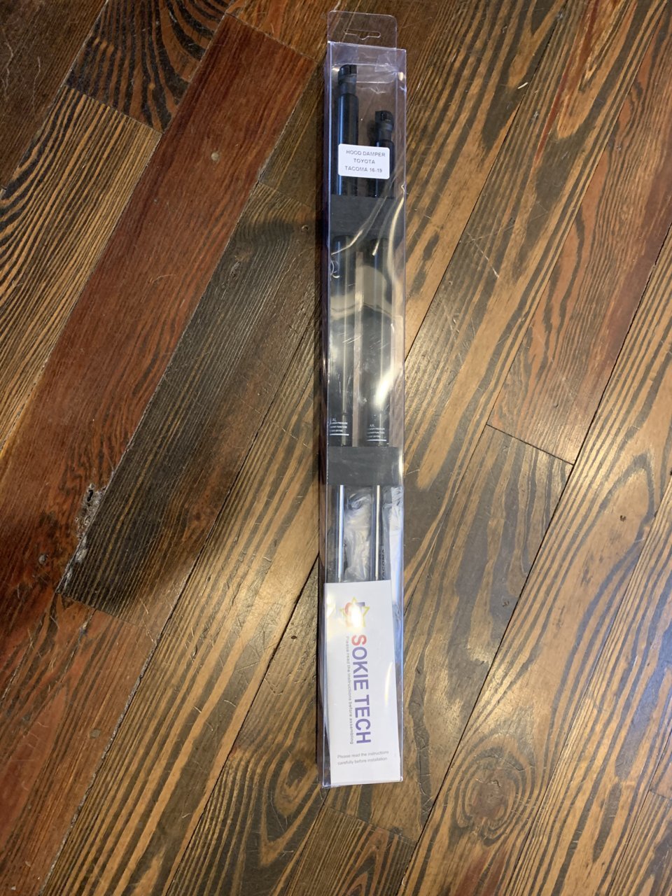

    So I bought a set of these for my 14
    They didn't work for a 2nd gen and after contacting Sokietech they refunded my money
    I have the set just sitting around
    I not sure they are for a 3rd gen, the package has #D2f6 on it
    The only thing I did was bend the large brackets to make them work but they still hit cowl ( which can be bent back).
    If interested I just want shipping, prob $10
    Don't want to screw anybody if they don't fit
