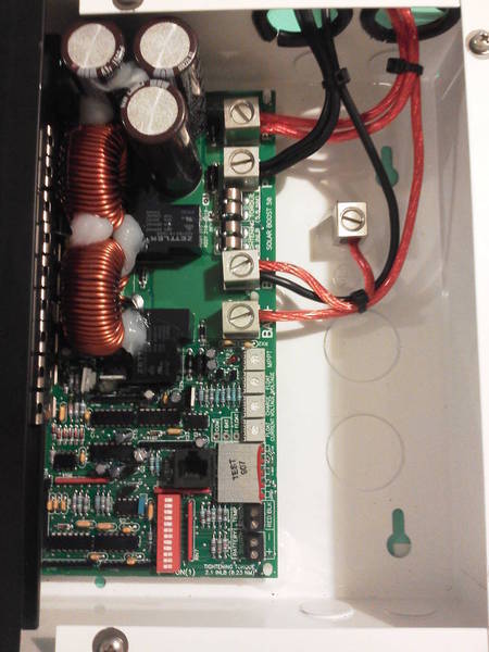

    Nice. Here is my in progress install with a 100w 12v panel:

    Blue sky is a great company. Just used their high voltage $550 box for a different project, running 500 watts through it with 50v coming from the panels, and 12v coming out the other end.

    I just became familiar with BlueSky - but I do like their products. I got the 2512ix-hv. I thinks its rated up to 350w and 50V max. I over built the system with the charge controller and remote I got in case I want to expand in the future.
    I got it all from www.amsolar.com - awesome and knowledgeable guys!

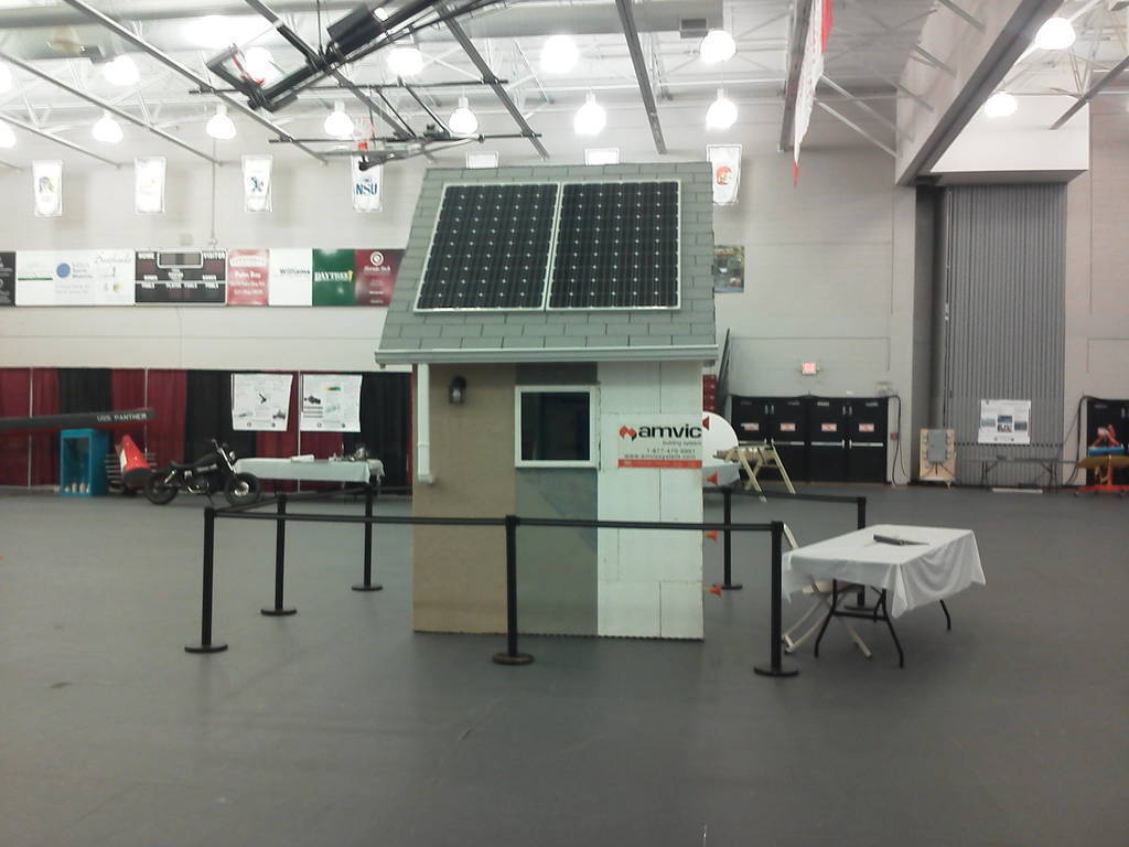

    I actually just won an engineering design competition with a project that incorporated the SB50L. amazing unit. i think i may end up with the 250 watt panel on my off road trailer, and toss the boost regulator in a watertight box with a battery on the tongue.
    about half way wired, without any tuning.
    the project she was installed on

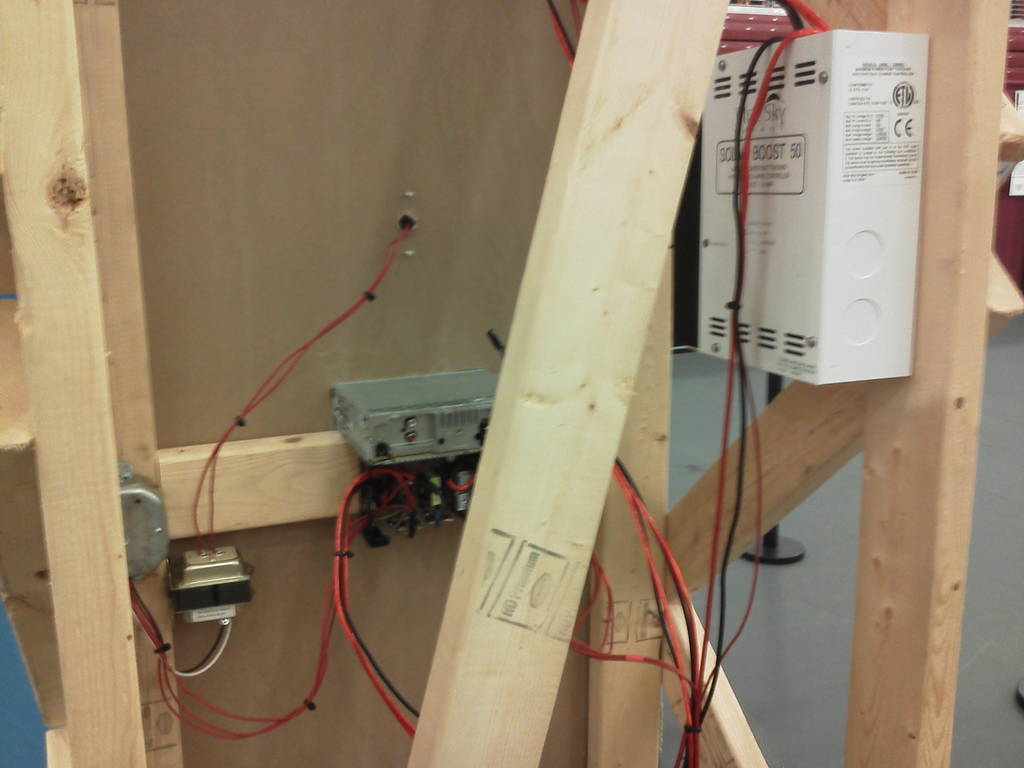

    mid way through final wiring into the sample "house". there's an inverther, transformer, and some other dodads in there as well.

    ^^^ cool stuff - seems like a cool project, was it for efficient homes? I see the AMVIC material also.
    those 250w panels are big. I stayed with a 12v 100w panel for now due to it meeting my current needs and size:
    Pmax = 100 watts @ maximum power​
    Vmpp = 17.7 volts @ maximum power point​
    Impp = 5.7 amps @ maximum power point ​
    Length = 40.8" (1037mm)​
    Width = 20.7" (527mm)​
    Depth = 1.38" (35mm)​
    Weight = 14.5 lbs. (6.6kg)
    With the bluesky MPPT boost - it sees close to 7.5amps to the batteries in good conditions.
    This is used to charge my 100amp/hr aux battery during extended camp stays. It powers my ARB fridge, 600w inverter, LED lights, etc. Figure it feeds back about ~35amp/hr a day on average to keep me topped off nice without ever having to restart.
    I did not fix the panel on the car. I have the option to plug the panel into MC4 connectors I terminated between the bed and cab or use the 25' extension cable (also using MC4's) to move the panel farther away so I can park in the shade and locate the panel in the sun.
    Once the wiring is all cleaned up I will post some more pics.

    it was for an "affordable" net zero home. typical startup costs for a net zero home can mean a 20+ year payback period to break even. through the AMVEC, solar, and a number of other high efficiency methods (some brand new, some old), mixed with some savy investment and banking strategies, we were able to engineer the payback period down to 5 years (and have numbers to support it).
    They are quite large, but at 250 watts and almost 50 volts a piece, they pack a mean punch. with it set up indoors (mathematically equivalent to an overcast day), we were running 3 lights, powering a 200 watt stereo, charging an 18v cordless drill battery, and still charging our battery bank.
    Edit: that's obviously the short version. there's a 500 page report to go along with it.
