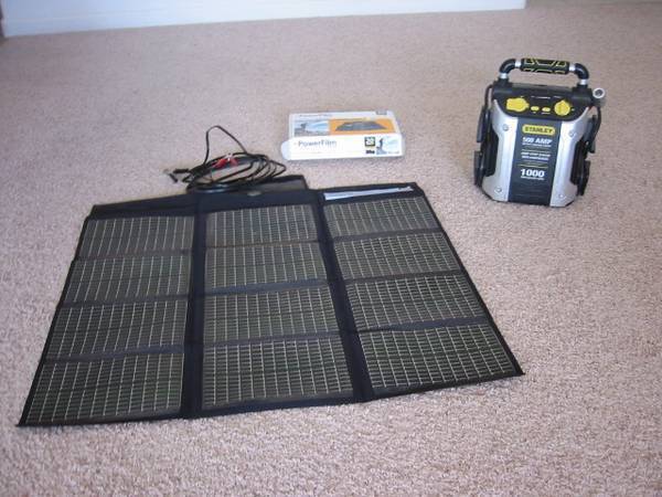

    Yup. Stanley jump starter plus a 20W Powerfilm folding panel that stays with my camping/cruising gear as backup-
    The Stanley is nice because it can be recharged from an AC outlet or a 12V lighter outlet which means once you're started and going down the road, you can recharge the jumper just in case you need it again. I bought the panel for another use, but it also works well as an emergency backup if needed.
