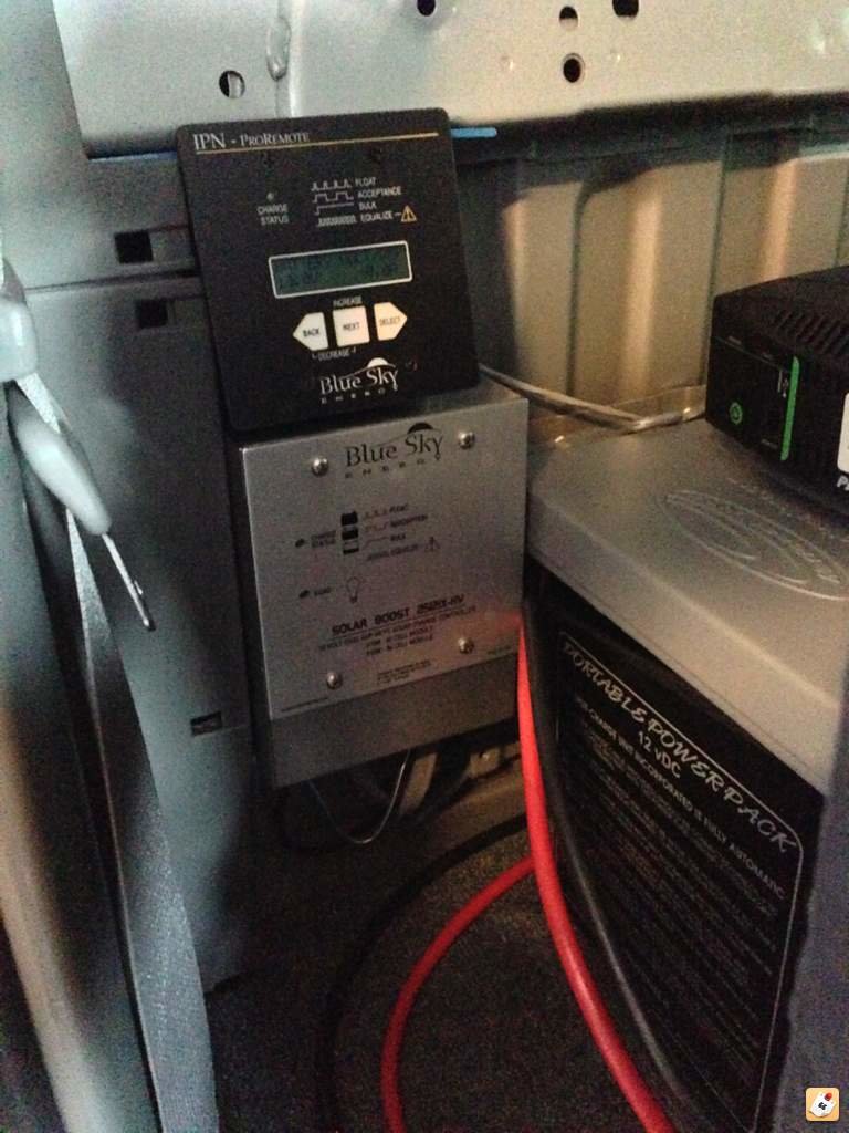

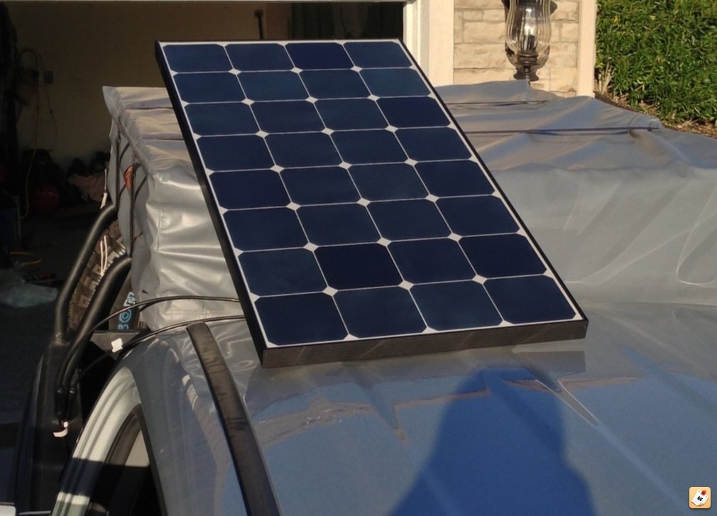

    Looks good. I went with a 100w panel and a national luna power pack with remote meter in front). I got one 100amp/hr group 31 odyssey battery under the hood and one in the power pack. I didn't hard mount my panel so I can use the 25' cord to move it to the sun when I want to park in the shade.
    I used a blue sky energy solar boost 2512ix MPPT with the blue sky pro IPN remote meter. Controler is capable is 300w+ so I can add later if needed.
    Currently it runs my ARB fridge, all nighttime LED lights, 600w inverter and any other accessories I need when camping.
