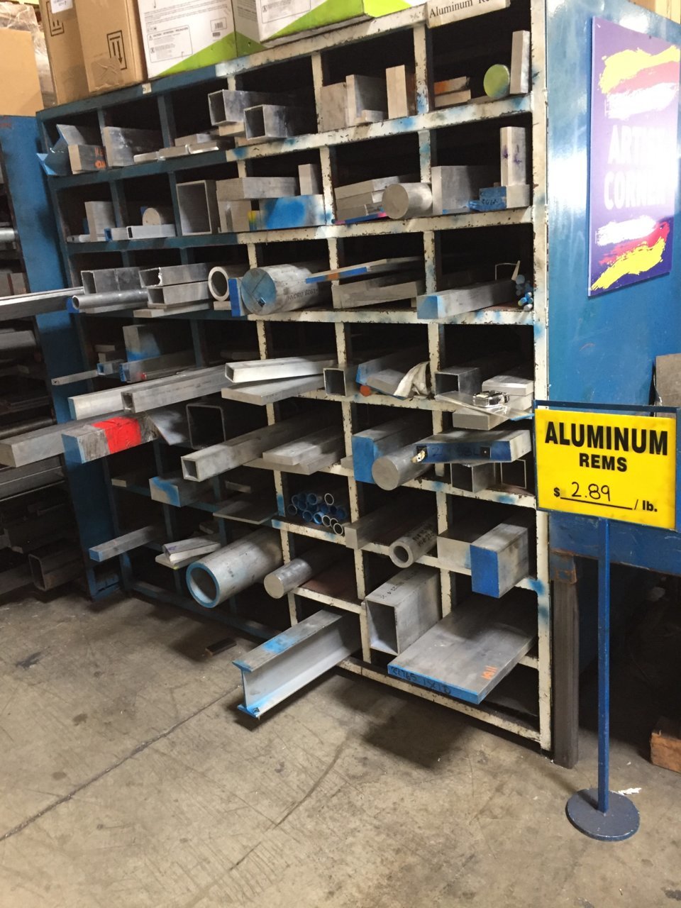

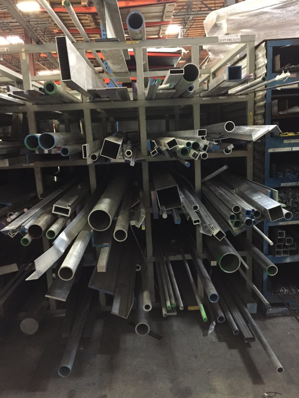

    Great idea! It would have been nice to be able to loosen a few screws and make some adjustments. I thought about using T-slot extrusions for other projects, but the cost was usually the deterring factor. Luckily, I have an Industrial Metal Supply store near me--a candy store for DIYers. I buy aluminum remnants for $2.89 lbs.
    BTW, 100mm is only about 4 inches. Depending upon you panel, you would need at least the 500 mm pack (20" lengths).
