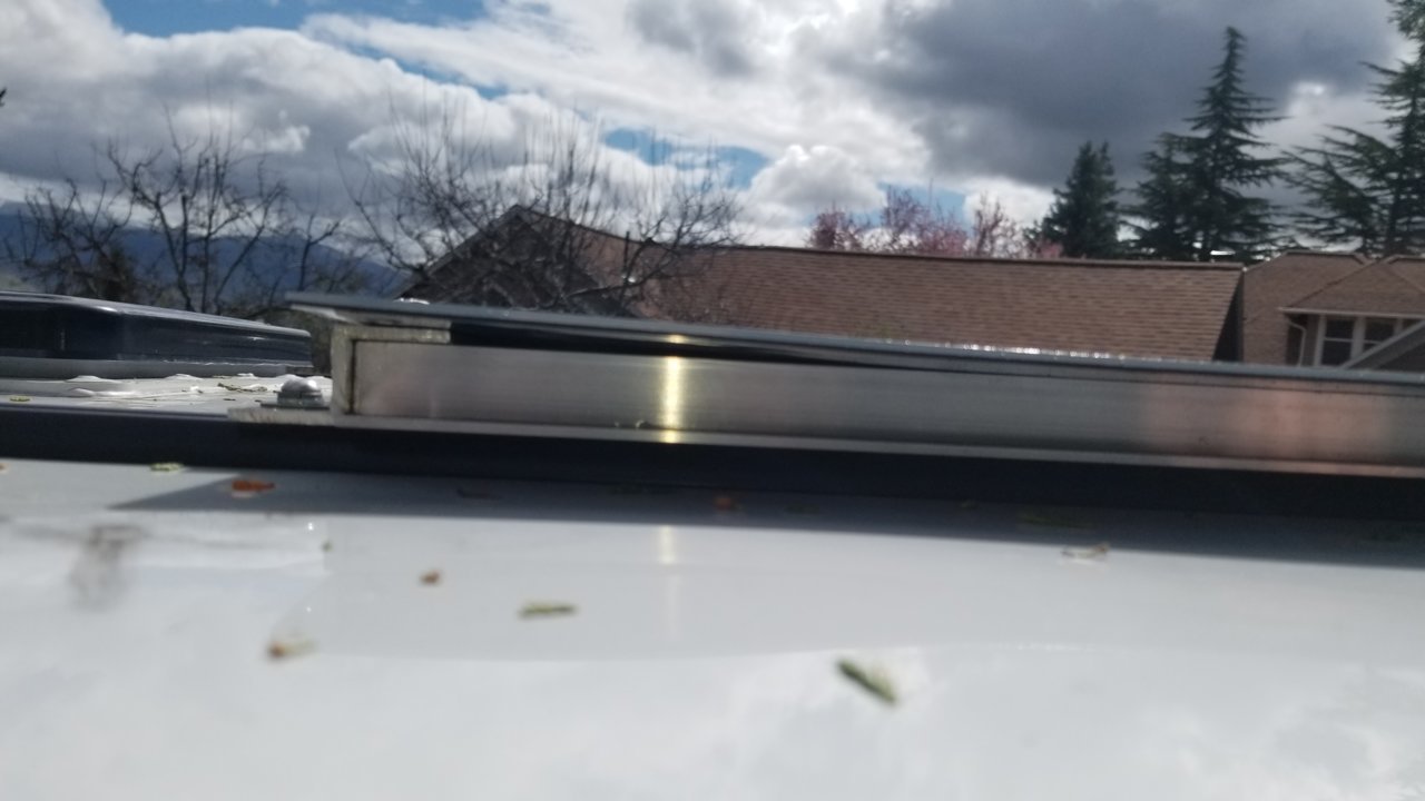

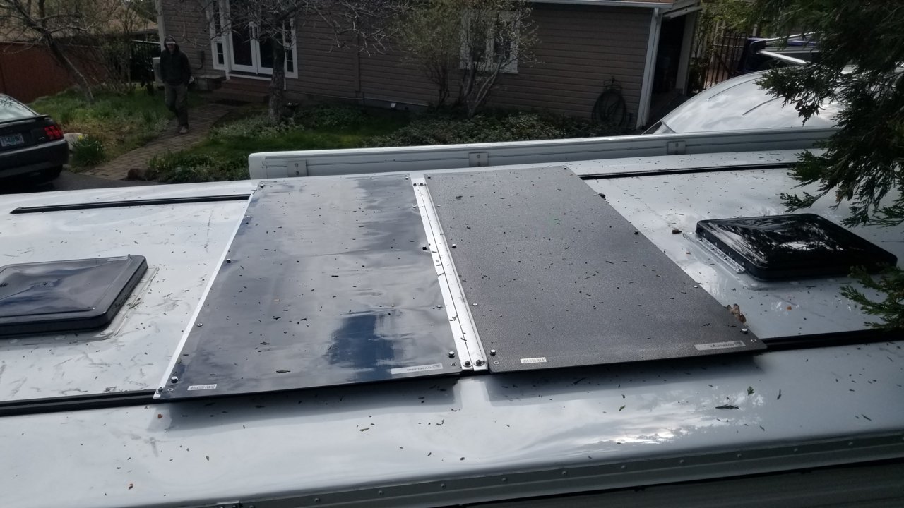

    We’re going to do both. We currently have two Overland Solar 160 watt semi-flexible panels permanently mounted across the roof rack into a Redarc dcdc1225 charge controller. Power is stored in a Battleborn 100ah battery. Since we’re planning on driving only a couple of hours a day the system can also be charged from the alternator.
    Because we’ll be traveling in a lot of hot areas we’ll be hunting for shade when parked so I’m looking for a lightweight flexible panel to set out in the sun. We mounted the flexible panels on Yakima roof tracks with aluminum supports along the edge. They sit above the roof, creating a air gap to cool both the camper and the panels.

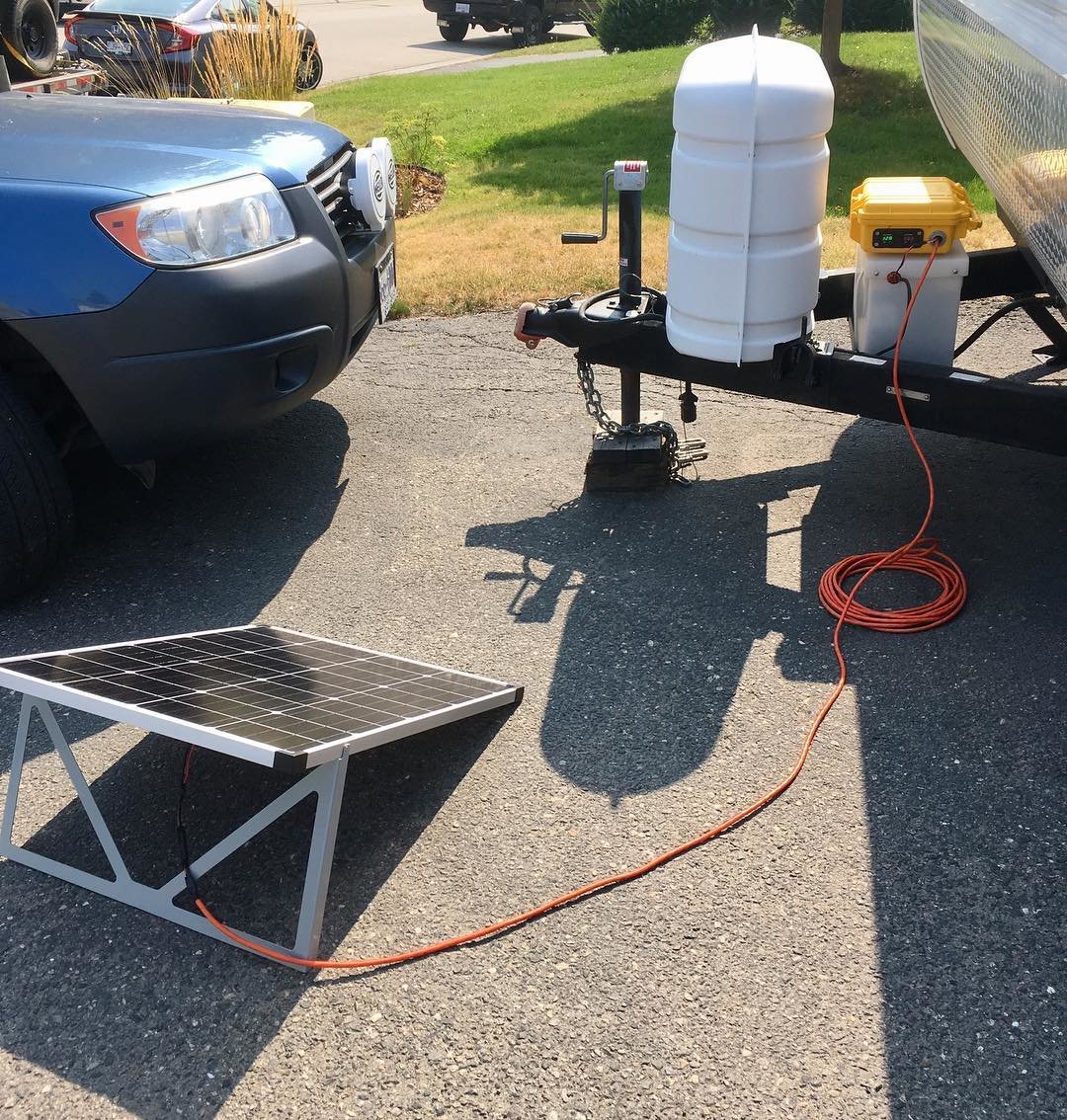

    I just put a solar system (a small one) into my 1st gen. Came out better than I could have hoped and is quite flexible in that it's easy to move around or use in various configurations. All under $400 with quality components.
    Infinite Free Power - Adding Solar to the Tacoma
    TomTwo and Round the world like this.
