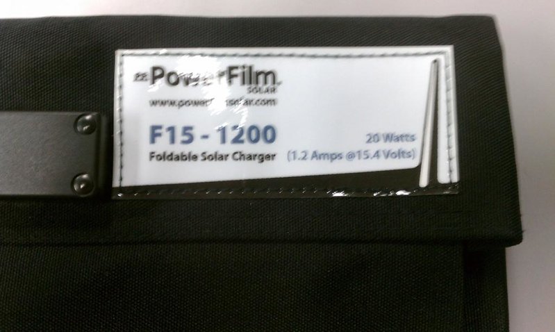

    Here is a pic of the charger laying on my toneau cover. I keep it folded behind my rear seat when not in use. I also use the cig plug adapter to charge the battery when we are camping. I put it in front of the sunshade in the windshield. THis unit will put out 1.2 amps @ 15v or so even on cloudy days. THe best part of the whole setup is the flexible and foldable design, maximum power when you need it, and minimum space when you don't
