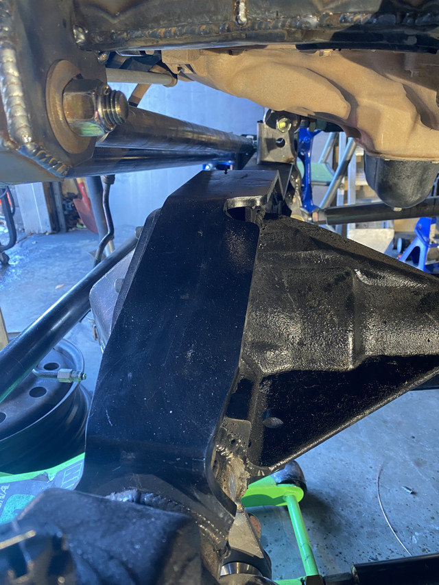

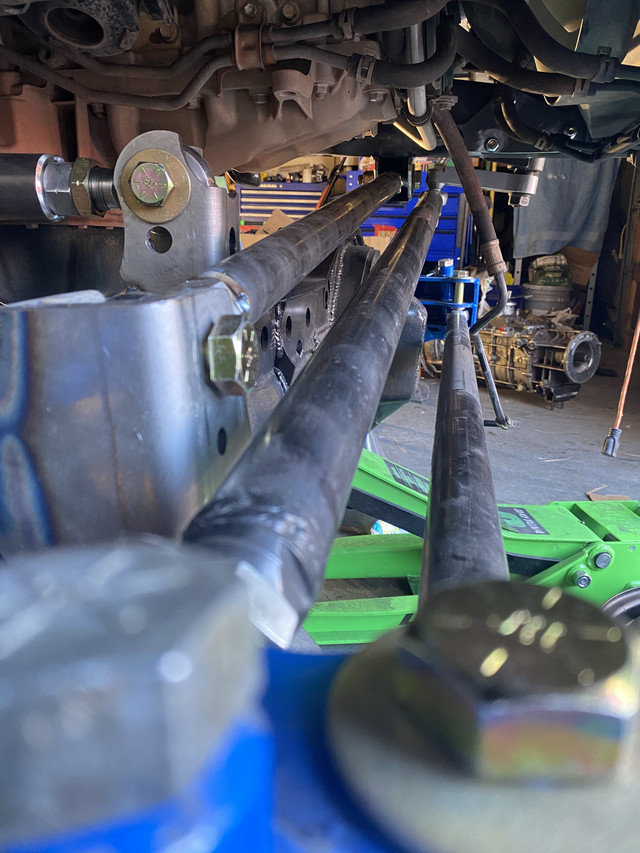

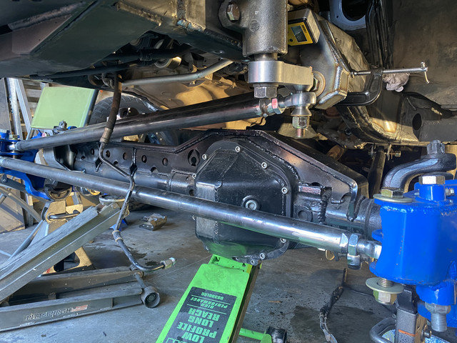

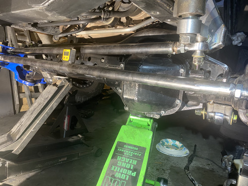

    if I drop driver side down and passenger up it’ll come in contact with the bottom of the engine. I do plan on moving the engine up 1.75-2 inches so it should be fine. The main issue is full bump and driver side up/passenger down the trac bar hits the pumpkin. Picture below is frame at 24” and center of axle at ~17”.

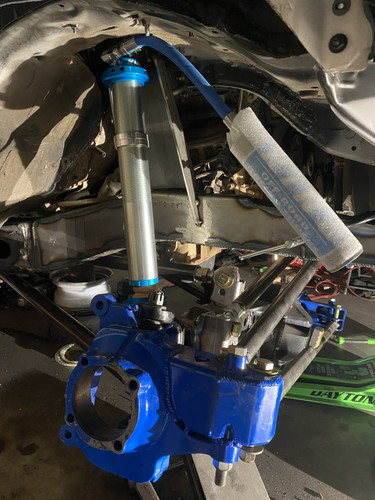

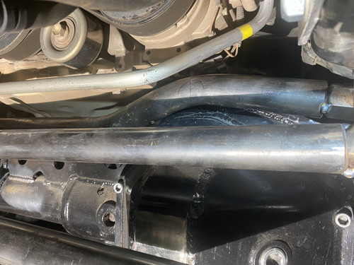

    I gave it a little bend just to see. Got rid of a lot of binding so Im going to tack in the coilovers and see what it does.

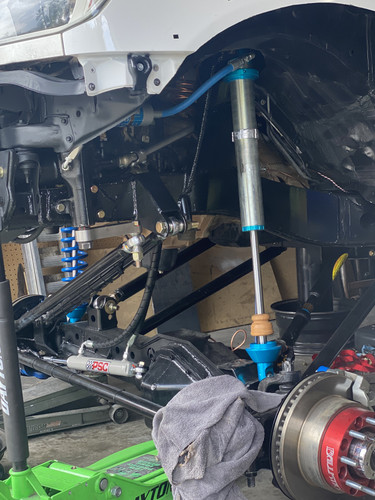

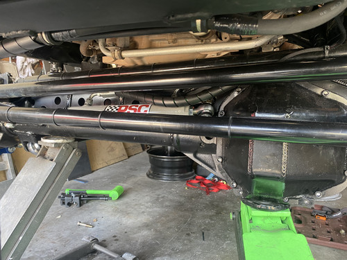

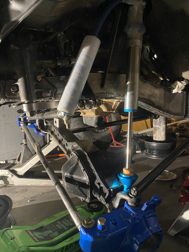

    I was having clearance issues with the passenger coilover so I ended up cutting most tacks and moving things forward more and also went back to a straight track bar thats a little longer.

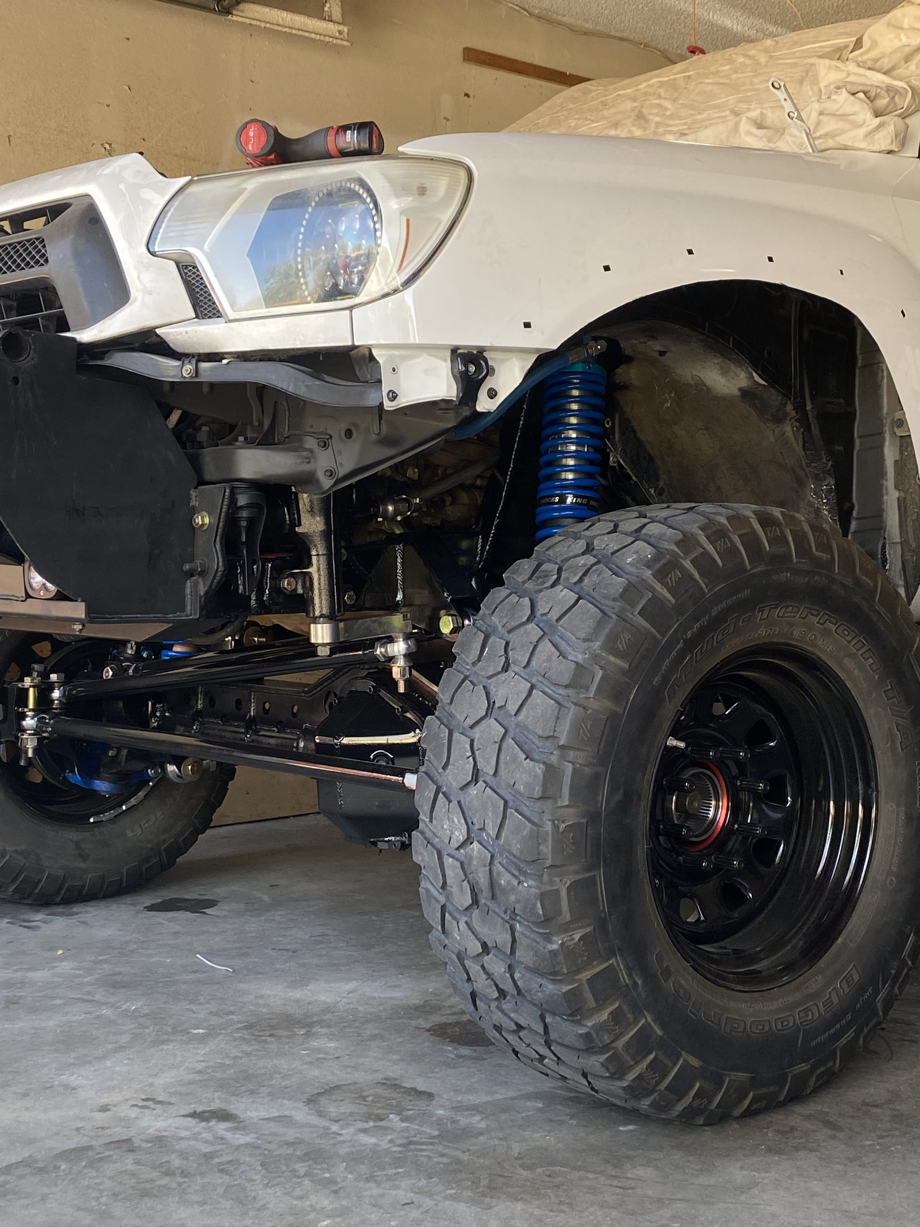

    etting closer. Have a couple things I have to finish up but finally after enough changes she’s on the ground.

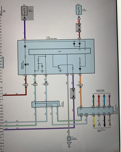

    Used this file figuring out the wiring getting the gauges and dash lights working on a SAS 2014 Tacoma

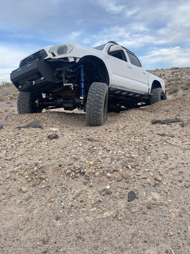

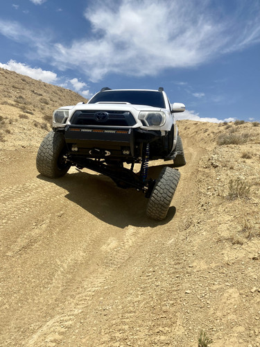

    Went mall crawling near work in the sand to test the front locker.

    Went out for a bit today. Truck handles insanely well overall. Wash board sucks though

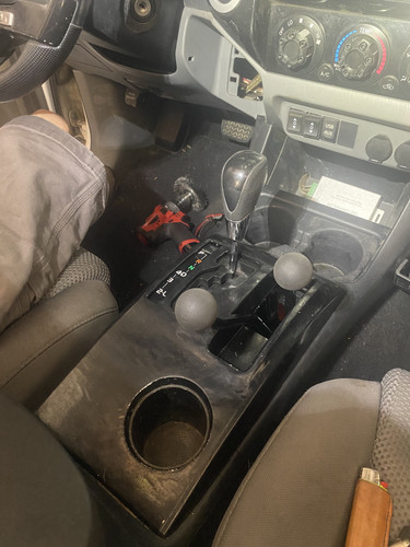

    FJ case and twin stick in, now I need to replace the cover and make a boot. Overall this was one of the easiest things I’ve done lately. :rofl:

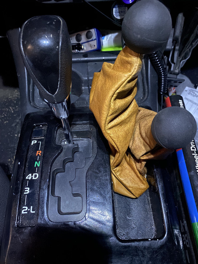

    Got around to my first attempt at making a dual boot for the FJ case.
