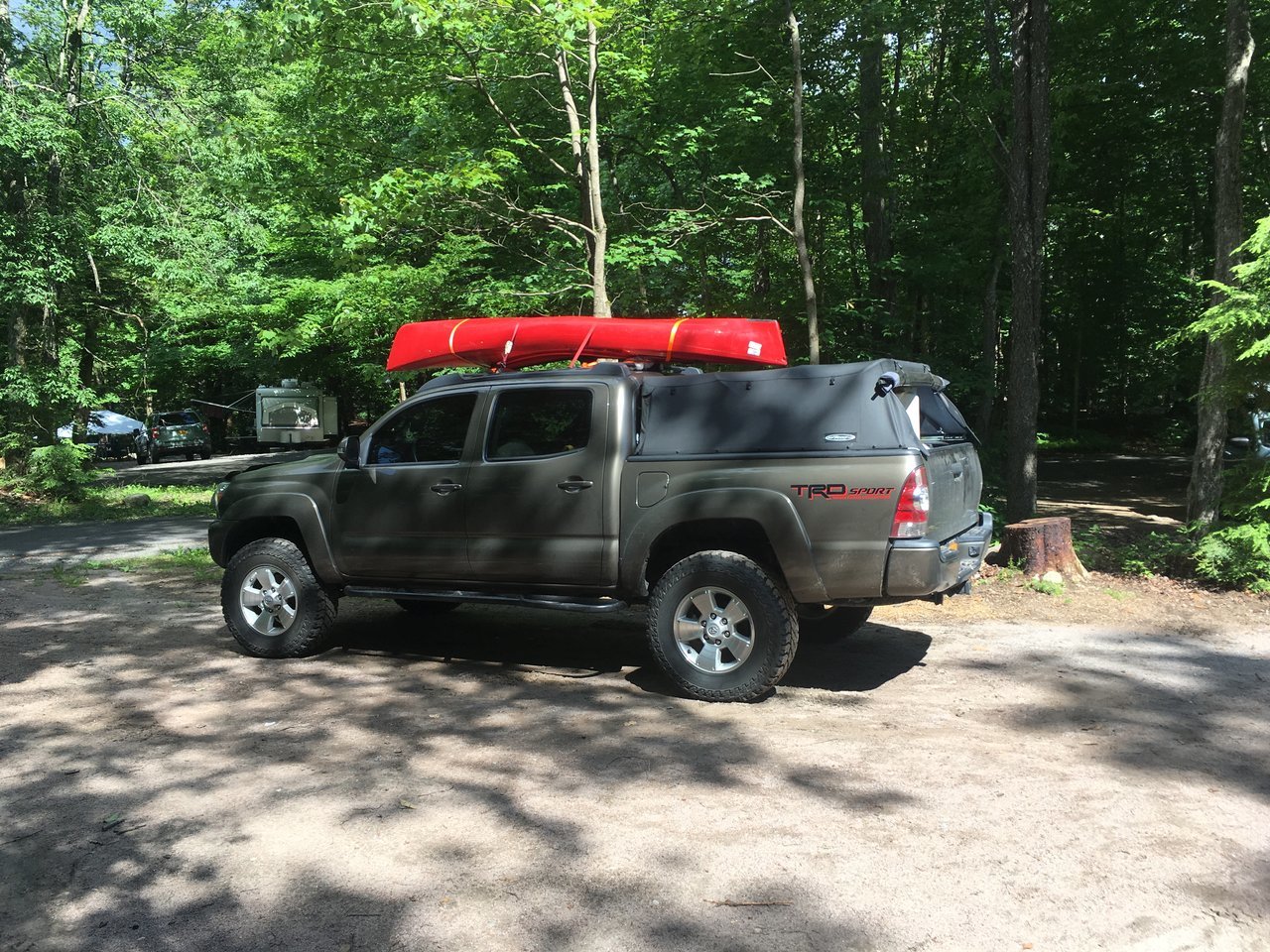

    Had a fun weekend camping. Got rained out the first day so that was pretty shitty. But other then that was a good trip. Realized need a gear strategy re-think. Awing for sure for rain cover. And liking the idea more and more for a roof top tent after seeing my brothers on his Jeep. Other then that just consolidate the gear more better storage and such.

    Looks like fun. Truck looks good....did you end up removing the wheel spacers? If not, any rubbing issues? I'm asking because I recently found that my front passenger tire is just rubbing my mud flap when turned to the right (about half way), when under slight compression. I'll have to figure out what's going on because if it rubs now it will be much worse next year when I switch out to 255/80 tires. Not sure if it happened after my alignment but I just noticed it this morning. Alignment numbers are good with 3.1 and 3.2 castor and JBA UCAs.

    I still have them on. I was planning to remove them when I did the next tire rotation.
    You are still on stock wheels with 265/70R17 right? So I had that issue on my last Tacoma even on a 3 inch lift with camburg upper arms and 265/75R16 but the Level 8 wheels I had were 4.11 back spacing so they stuck out a good amount. You might actually have to ditch the mudflap. Those things do stick out a good amount. Or you'll have to trim them up. Now when you go to the 255s remember is a narrower tire so it actually should help decrease the chance of rubbing in certain situations

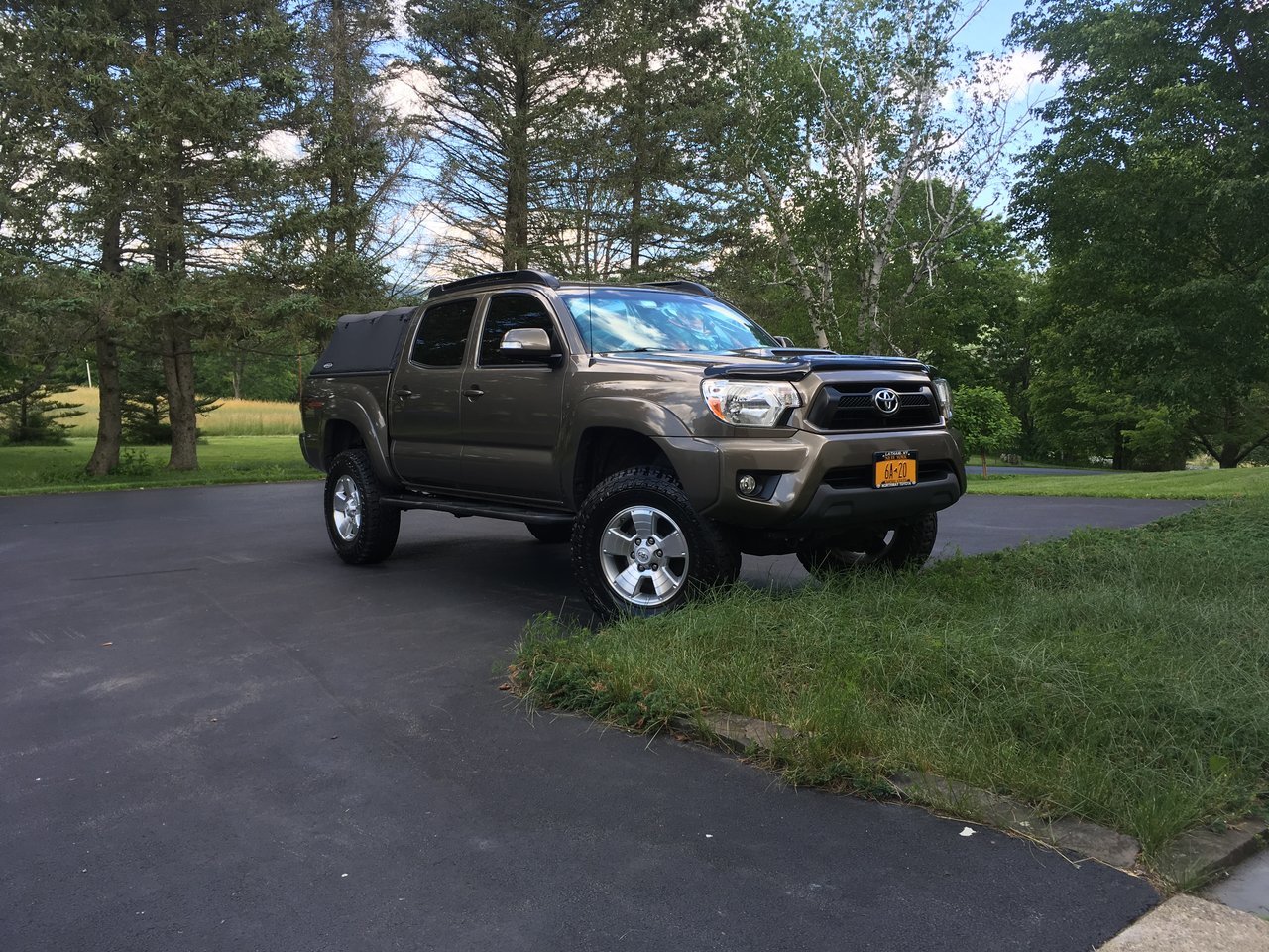

    IMG_5613.jpg Turned out to be a nice day so finally was able to do a deep clean of the taco

    TOO clean.....
