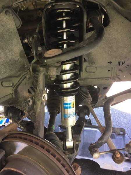

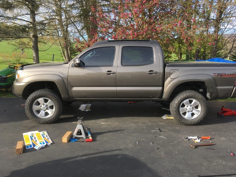

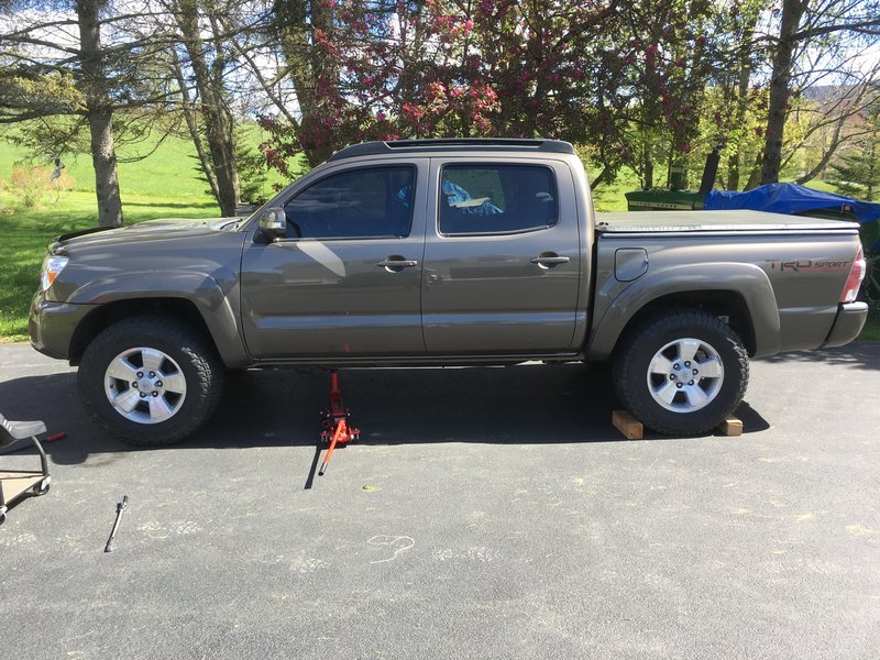

    Ok so after the winter I noticed my driver side looked a little slanted. Checked it and driver side is 22.5” passenger is like 23” rear is 24.25” both sides. So looks like I need to pick up a strut spacer to solve the lean issue. Other then that suspension has held up well little over 20,000 miles on the setup. Probably gonna partake in the Relentless Fab bed rack launch just waiting on a shipping quote to make sure it won’t be to crazy.
    Probably two weeks do the tire swap and oil changes

    Anyone know if the poly spacers are any good?

    Never had experience with them... I would assune the Poly has some give to it so it may have a slightly better to negligible difference in ride quality. If it were me I think I would rather the aluminum for a more solid mounting surface

    Thanks bud. I was having the same kind of thinking. Poly is pretty durable stuff but not as much as aluminum in this case

    Yeah I have the 6112s in the front and Dakar’s and B110s in the rear. I noticed after the winter and 20k the driver side is def leaning and was going to put a 1/4 spacer on the driver side to level it back out
