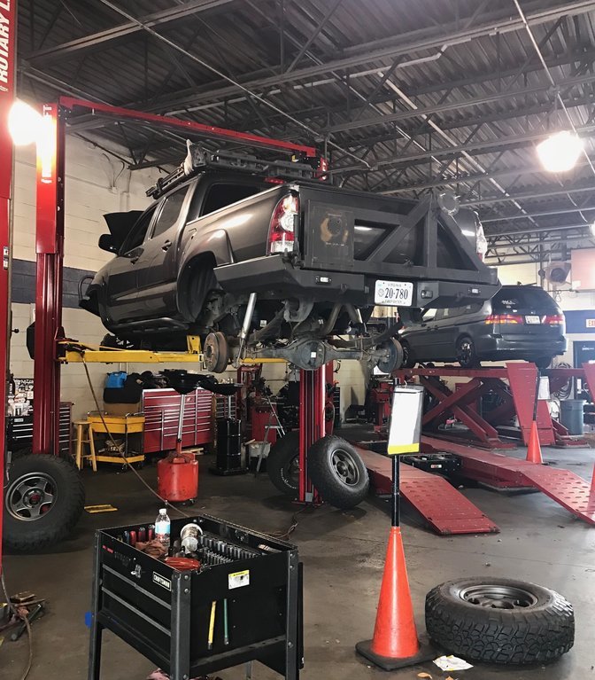

    Stokesdale | NC
    ‘19 Honda Civic Hatchback
    50K oil change/rotation/wiper blades done. Water bottle under the filter drain worked like a charm, zero spillage. Fumoto drains pretty slow but it's nice to have zero mess. I just let it drain while I did the rotation and it was fine.
    I did notice both my balljoint boots are split and leaking grease, but the joint is tight so might not worry about it for now. Also noticed my front tires were cupping a little bit so might get an alignment soon. Sprayed some WD40 in the camber bolts in preparation just in case.
