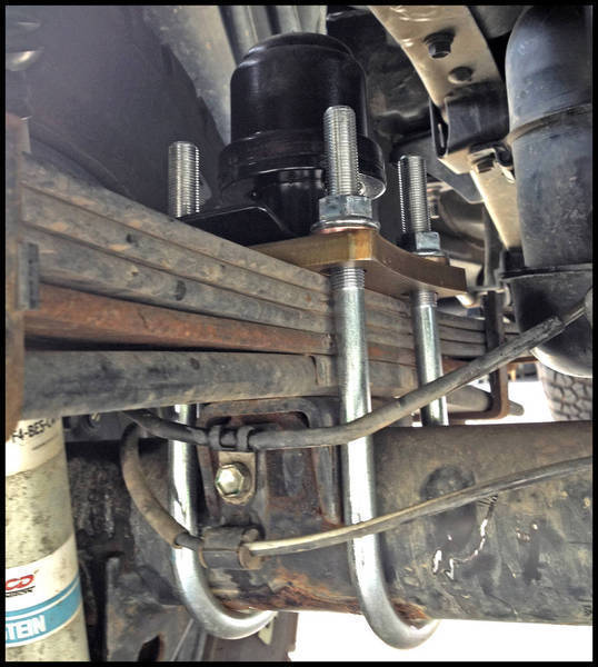

    U-BOLT FLIP KIT, SUPERBUMPS, EXTENDED BRAKE LINES
    Installed the AP U-Bolt Flip Kit, front and rear SuperBumps, along with front and rear extended brake lines with the help of Skygear today. The U-Bolts are a little long, but I think they will be fine with how much the SuperBumps will compress. I don't even think I can flex my suspension enough to get it to that point anyway.

    Not anything significant. :notsure: I was actually surprised when I jacked the truck up and had everything at full droop, my front needed the extended lines more than the rear. The rear actually had maybe another 3/4'' to pull tight, but I needed the front and rear anyway.

    Damn weird design to me having the bolt and bump separate so that the allen key doesn't even fit with the LCA being there. We had to take apart a multi-allen tool to even start the bolt, then twisted the eye on the allen with a screwdriver to finish it. We assumed that Wheeler's must just not integrate the bolt and the bump together so that is easier to sell for multiple vehicles with posible differences.

    Yea, i used a socket allen and an extension :D worked perfect.
    Yea you wont really even feel the contact with the bumps, it just sort of stops compressing. Love them!
