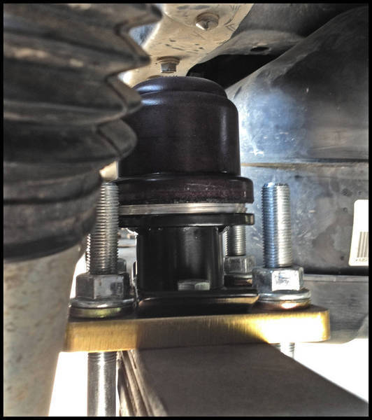

    SHIMMED REAR SUPERBUMPS
    Removed the Toyota grille emblem again...I liked the white but I think it was a little too much, and I really like a clean look now a days.
    Also added some 1/4'' spacers for my rear SuperBumps to keep them from hitting my U-bolts at compression. Huge thanks to Airdog for hooking me up with these. I don't want to cut the bolts because I plan on getting the AP Expo's within a year so it would be pointless to cut them now.

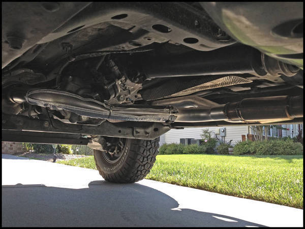

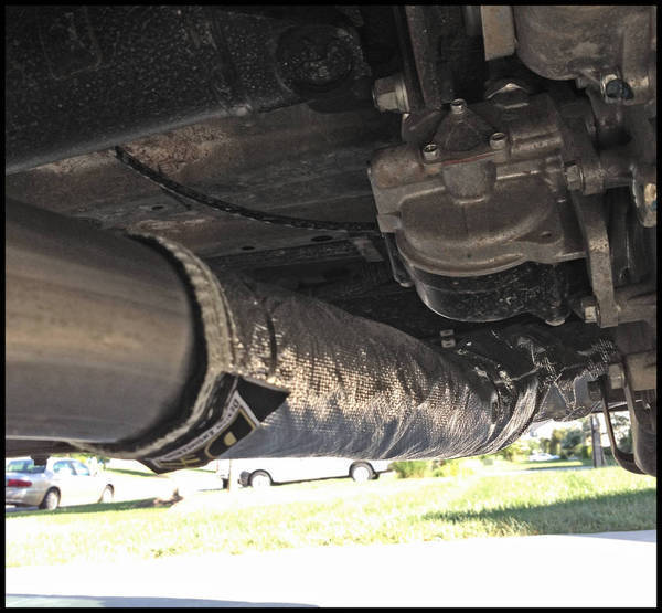

    Got my AP IFS skid off and put on the very beefy ATO IFS skid today. I think I'm going to hold off on putting my transmission and T-case skid on for now because I'm not sure my 885's can handle that much weight. Once I get the 700# Icon's they will be going on.
    Also put a heat wrap on my new exhaust reroute around the transfer case. It was $40, but I think the peace of mind is very worth it, especially considering it is preventing a potentially very expensive problem.

    I had a bit of a scare driving to the firehouse after I put on the heat wrap when I smelled something burning...drove about halfway there, pulled over and made sure my truck wasn't on fire, then continued to the firehouse until I could look at it more in depth. My suspicions were correct and I figured out some Velcro strips on the edges of the wrap were melting. I put on some gloves and scraped the rest of the Velcro off, so hopefully it will be ok now.

    looks good man! My wrap smelled and even smoked a bit for the first few miles...
