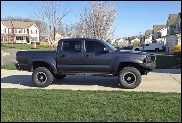

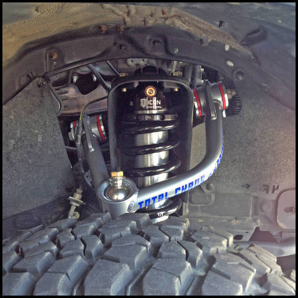

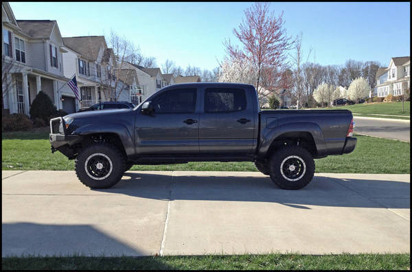

    IVD / AP SUSPENSION INSTALL
    Installed all the suspension today with the help of Skygear, joneill03, FastEddie, and Frogsauce. Huge thanks to those who came out and helped me.
    Alignment is way off. Cranked the coilovers to around 23'' (center hub to fender) and rear is right at 25'' (center hub to fender). I think the rear will settle a little bit, and the Pelfrey bumper in late May-early June will most likely bring it down a little also.
    Getting EBC Stage 5 Brake Kit and alignment done on Monday. Hopefully it will get rid of or at least minimize the weird steering feeling that my brother also has after installing the Icon's up front. I doubt it will because his alignment is perfect and it still feels weird. Maybe it is just how these coilovers make the front end feel? I am PM'ing Icon to see if others have this result.

    a higher caster number will make it harder to steer but it shouldnt feel as extreme as youre mentioning. lift the front of the truck off the ground and with the truck on see if you can turn the tires by grabbing the tire and turning it. That will let you know if there is some binding going on but it seems wierd to me...

    Finished product
    This is the fronts at full droop and tire on. I cranked the coilovers up a little bit after this picture, but nothing big.
    This is right after we got the Expo's on and before putting on the rear IVD's.
    I'm going to get better pictures of the suspension tomorrow. I also finished greasing the UCA bushings and lubing the uniball.
