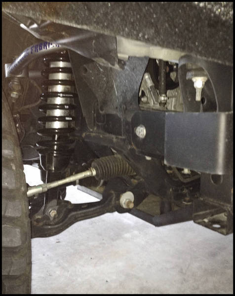

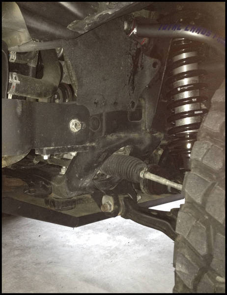

    So, even though I have swaybar relocates, my swaybar is still hitting the coil over seat at complete full lock. Makes a very loud clunk. Any ideas? I'd like to keep the swaybar on but I don't know how else to space the swaybar down if I already have the relocates.

    relocate it...off:p

    The relocate bars space it forward I think. You may be able to find/make a custom spacer but if there isn't room to move the sway bar up any further it wouldn't work.

    I have contemplated that. Did you take it off Superwhite? I just don't want annoying body roll in some of the roads I drive.

    took mine off a long time ago. of course your going to have some extra body roll but it doesnt bother me. just makes you slow down a little more going into a turn. try it out, doesnt take much to remove it

    Prob have to take down your front skid to get it off I would guess. If its too much roll you can always put it back and find someone to fab up a custom relocate for it.

    ULTRAGAUGE RELOCATION AND SWAYBAR REMOVAL
    I greased my UCA bushings again to try and get rid of this weird squeaking / creaking noise when I'm driving normally, but it didn't seem to help. :notsure:
    Relocated my Ultragauge with the help of joneill03 today. The windshield mount kept falling off in the cold mornings and was a PITA to work with.
    Have it mounted under the sun visor by the A-post. My sun visor still goes down all the way, so it's a win-win.
    Also removed my swaybar. It was hitting the coilover seat on my IVD's, even with the relocation blocks, so it had to go. A little more body roll, but the 700# coils keep it under control.
    Hopefully will help with offroad articulation...if I ever make it to a wheeling meet... :anonymous:
