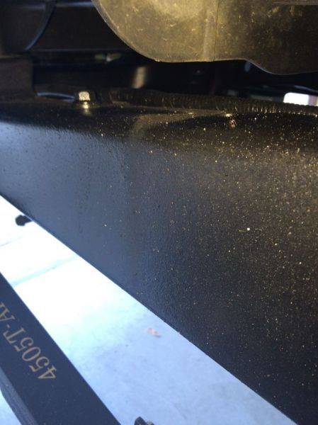

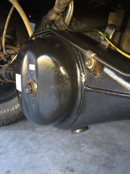

    Here you go AR15...as you can see, depending on the thickness of the coat, the fluid film can be a little more glossy and more of a film. I ran my finger across the film on the rear of the frame (first picture) and it was like a very thin film of grease had been applied. I think I went a little heavier on the axle, so it was more glossy.
    It's not "drippy," but there is a film of it when you run your finger across.
