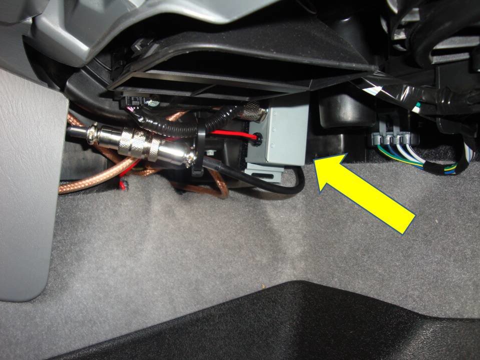

    Some more ideas...
    Under seat:
    Behind pedals:

    Wired up new Cobra 75 with the help of Skygear today. Decided on the under cubby install and then the mic connection through the trim on the driver side console. Even if I have to troubleshoot anything, all I have to do is pop the cupholder trim out. The CB unit actually sits forward of the cupholders under the angled cubby.
    Still working on SWR; Channels 1/19/40 were all reading around 2.5, regardless of antenna height, which is a little confusing, but they are all at least under 3 so the radio is safe to use while I figure it out. Also still working on finalizing the mic connection and then I will ziptie the actual CB unit to keep it from sliding around, ziptie all the wiring, and pop the cupholder trim back in. Need to find a better grommet or solution to keep the mic connection in the plate.
