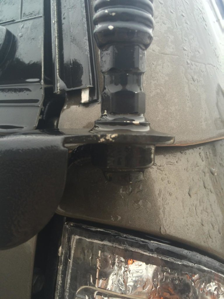

    Give this a try. I had t like this on my old set-up.

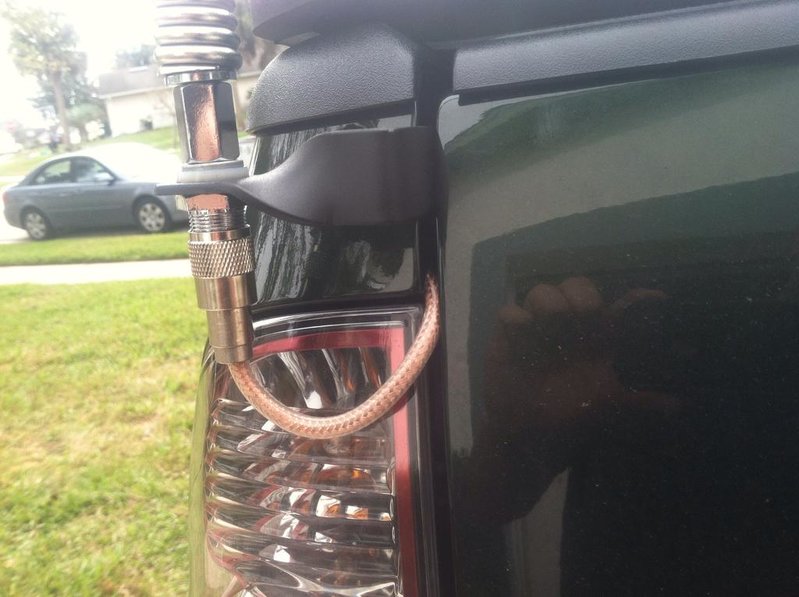

    I am running the BAMF mount as well. Move the washers with the teflon on top of the BAMF mount. Then big washer right above. Its actually just like the picture that Ckeene9 posted above. I had mine like yours and switched to this and all my SWR went away.

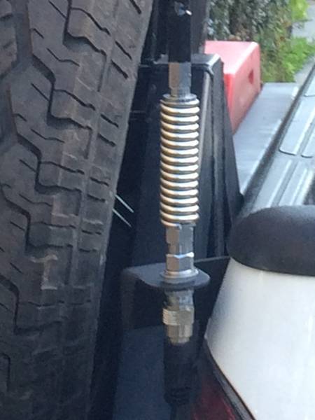

    Tried to move around the washers on the CB mount. Now have PL-259 connection and one metal washer below the BAMF mount, then teflon washer on top of BAMF, followed by another metal washer, then antenna.
    Re-tested SWR, and numbers changed from around 1.7-2.0 depending on antenna height, but the weird thing was that 1/19/40 all read the same SWR just like before. I did not scrape paint off the mount yet because I've got a lot of other higher priority life stuff to take care of but any thoughts by knowledgeable peeps?
