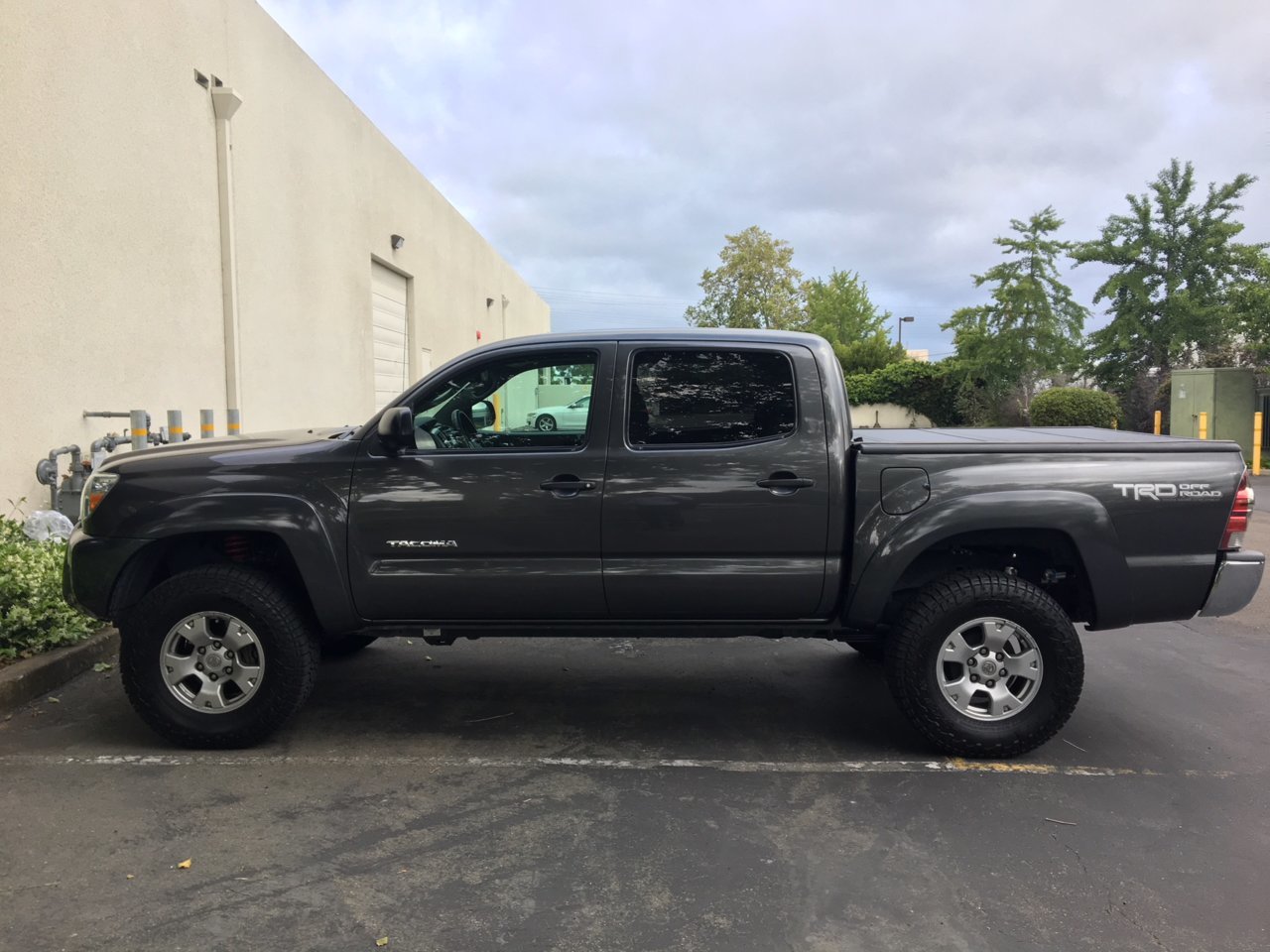

    Thanks. It gained 2.5" in the front and 2.75" in the rear. It started at 21.0" front and 22.5" rear, measured center of hub to fender. The tires are 265/75r16 Falken Wildpeak.

    Still crazy to me that you gained that much in front. We're your fronts failing?

    Mine gained 2.5 in front and then settled to 1.75 after a couple months.

    When is the best time to get an alignment after installing this? I'd imagine that much settling would call for another adjustment

    I waited around a month and most of that settled out by that time.
    If you mark your LCA alignment tabs well and match it up after it seems your caster will be low but everything is pretty close and it's totally drivable.
    Give it a month and make sure to bomb some crappy dirt roads on the weekends to break it in.

    I don't know if the front's were failing, but the ride with the stock suspension was pretty "floaty" . I've got a little over a month and 1k on them, mostly highway miles.

    That was TRD Pro front and rear shocks. No UCA change, this only provides 1.75" lift up front. My LCAs were fine, cam bolts not seized.
    You won't find a set for $600 anymore, unless it's used & abused. You missed the party by 5-6 months.
    At this point you'd be better served buying standard, off the shelf Bilstein 6112 & 5160.
