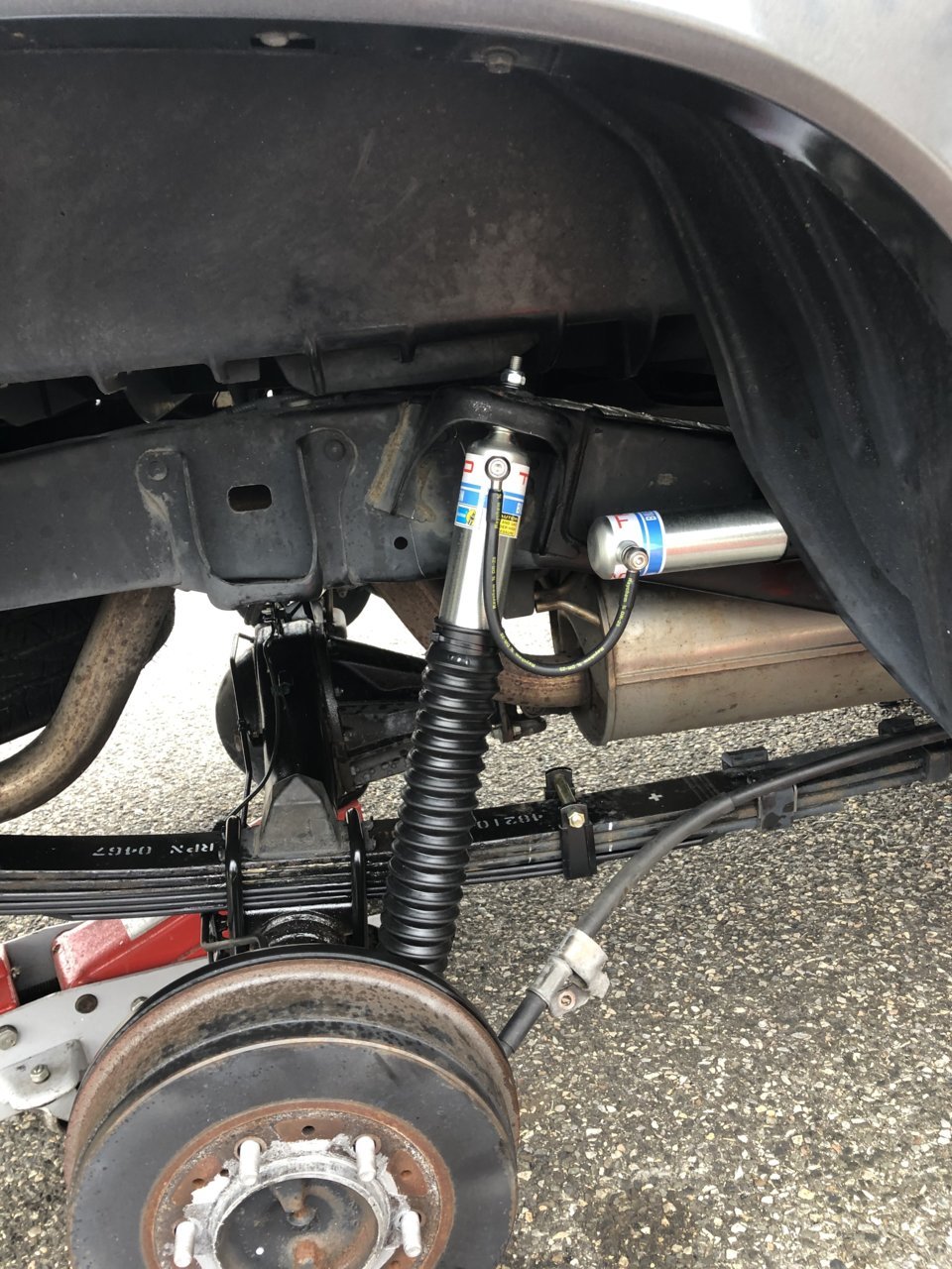

    Hi Guys. I finally installed my rear Bilsteins and added an Icon AAL also. I stress finally- it’s been sitting in my garage for over a year. How did you tighten the nylon nut on the top of the shock? I bought all new bushings and just held the shock body with my hand and tightened the nut with a 17mm wrench. I did not want to damage any threads on the shock. Thanks for the late response!!!

    You'll be very happy, it's a great kit for the money! It looks like you have it tightened down. Obviously, it's a nylock nut, so it's not going to back off, you just want to tighten it until it squishes the rubber bushing slightly in-between the washers, there is no need to torque the nut.

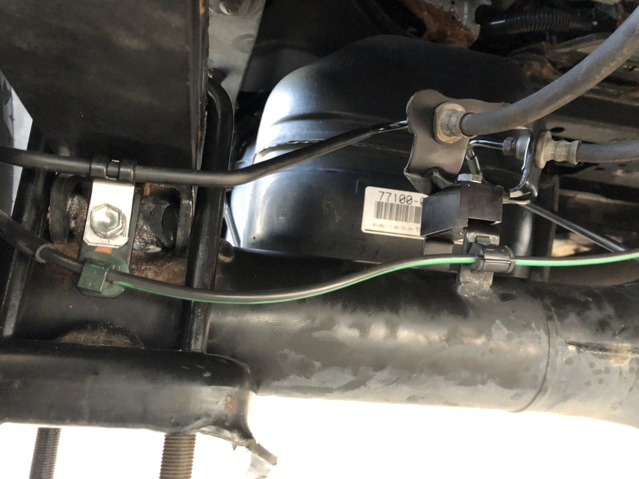

    Another question for those that have installed on a 3rd Gen. Did you guys install the brake line spacer provided with the kit? I’m on the fence with this one. Thanks!!!

    I did.

    It shouldn't even be a question. The spacer is a must.

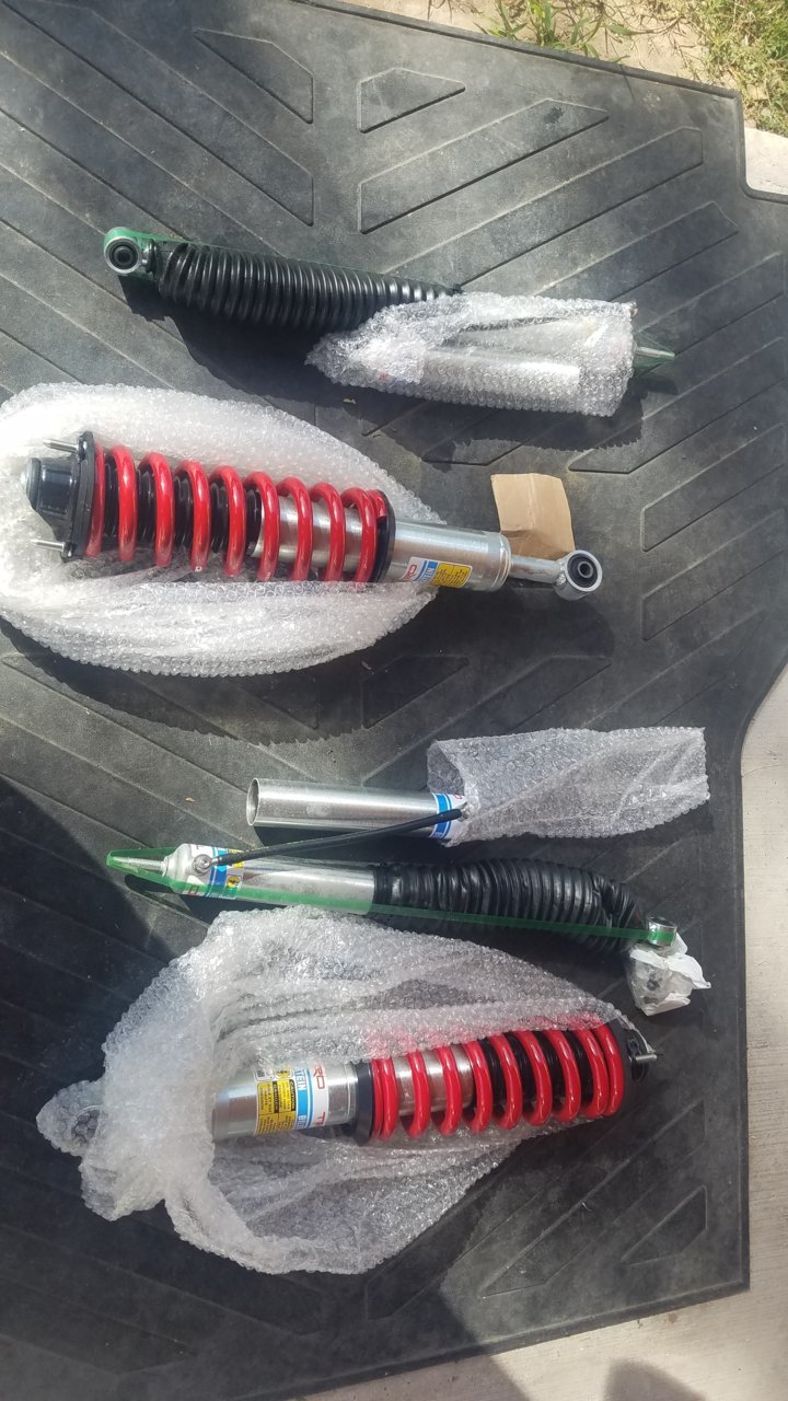

    I have a new setup for sale but I'm in south Texas 78541, the boxes is torn up. I never installed it and sold my tacoma. $850 local pickup is preferred but I can drive up to San Antonio on the weekends. Let me know

    Thanks again. I just did it. Pretty tight lines down there for sure.
