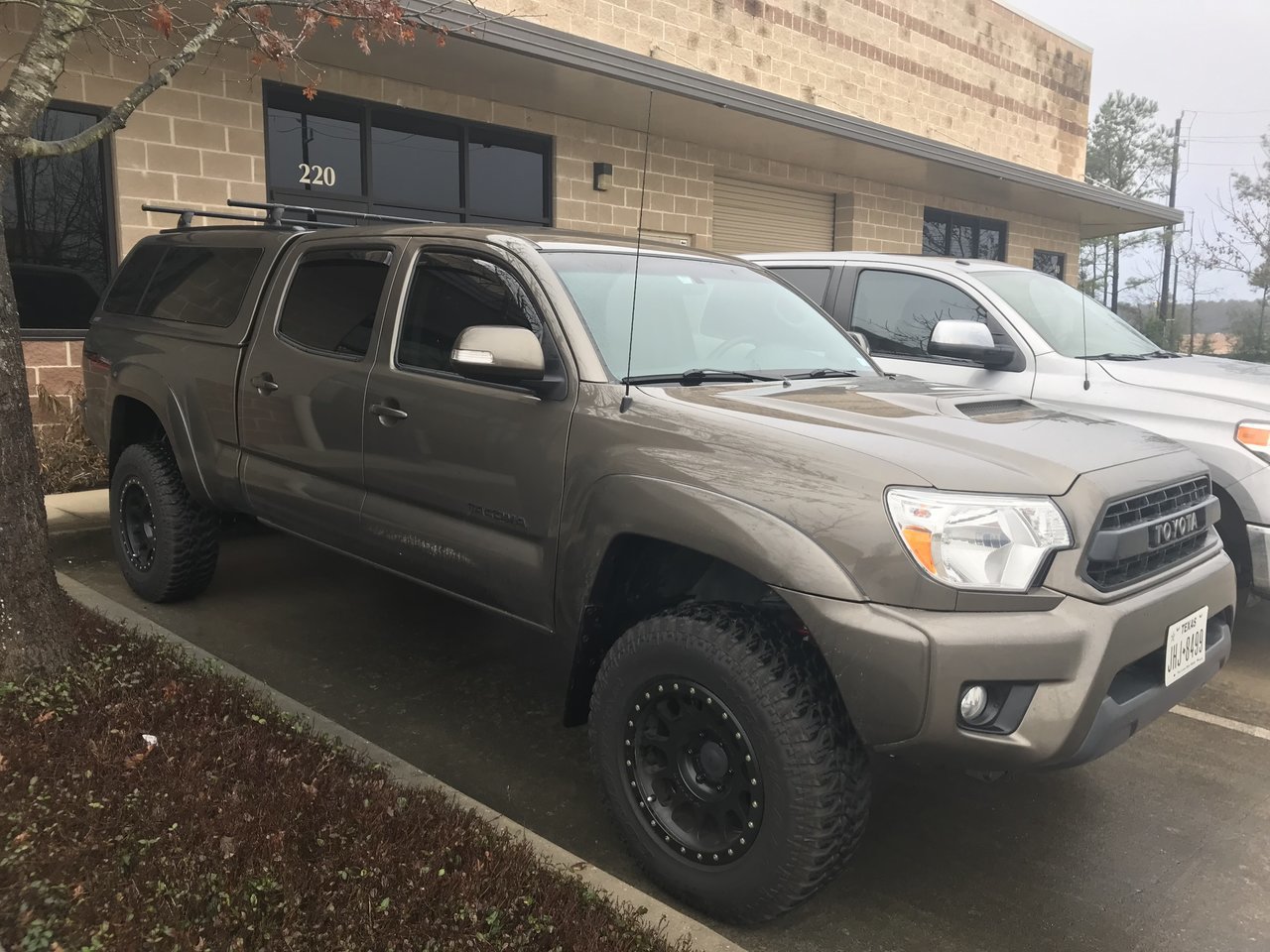

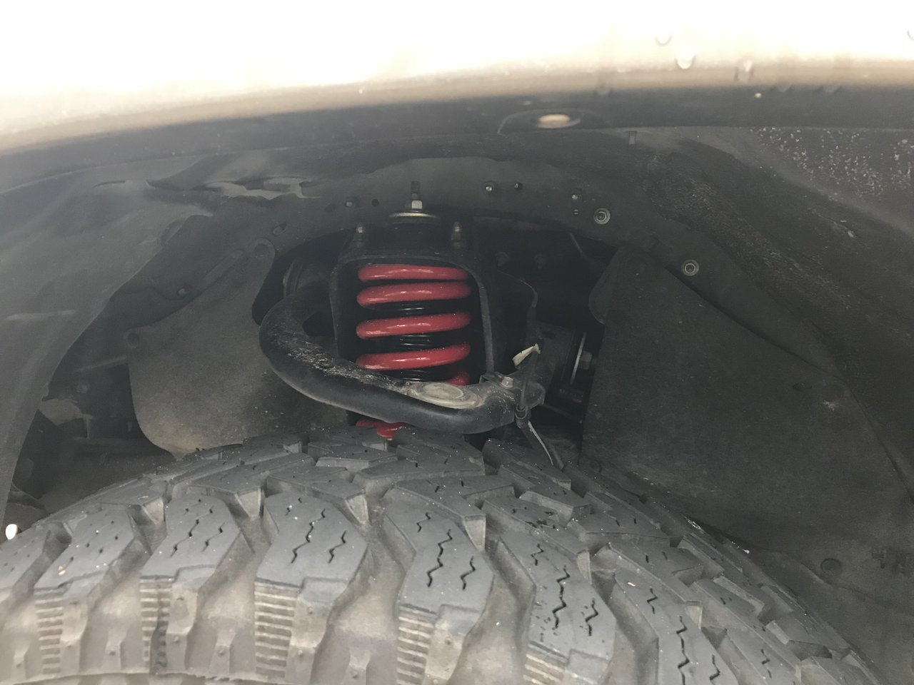

    Still settling in the front since installing last night...I’ll wait a few days to take numbers. 2015 DCLB Sport
    I haven’t taken it for alignment but it drives and tracks just as good if not better than my stock setup (I used to pull slightly right. I know I’ll need more caster. Alignment Wednesday.

  13. Feb 26, 2018 at 7:49 AM

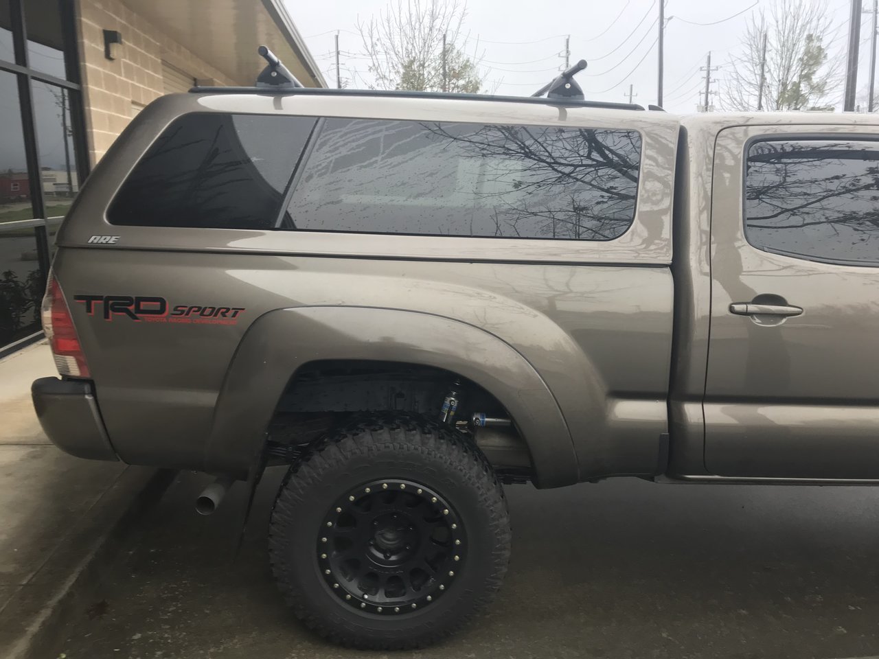

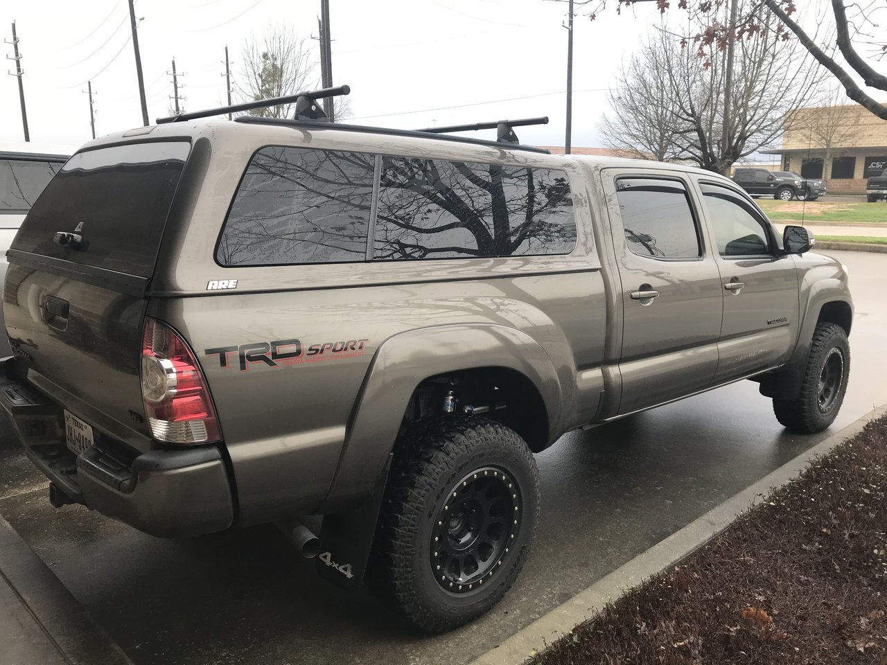

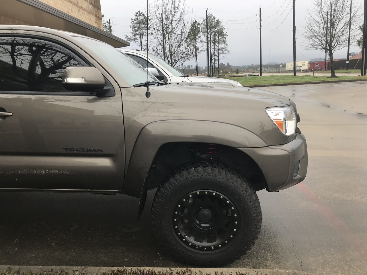

    Man that looks perfect. :thumbsup: Love that color by the way. Are you plus 1 on your tire size?

    Your truck looks great, dig that color.

    Whats your measurement center of rear hub to fender ?

    About 24”...OL kept in and a brand new 2018 Pro leaf pack that had 950mi on it. I’m sure the leaf pack doesn’t have enough miles on it to even have started to settle yet. OEM leaf pack leaves were about 1.055cm thick the pro leaves appear to be about 1.25cm thick. I think they’re slightly heavier and maybe 1/4” taller.
