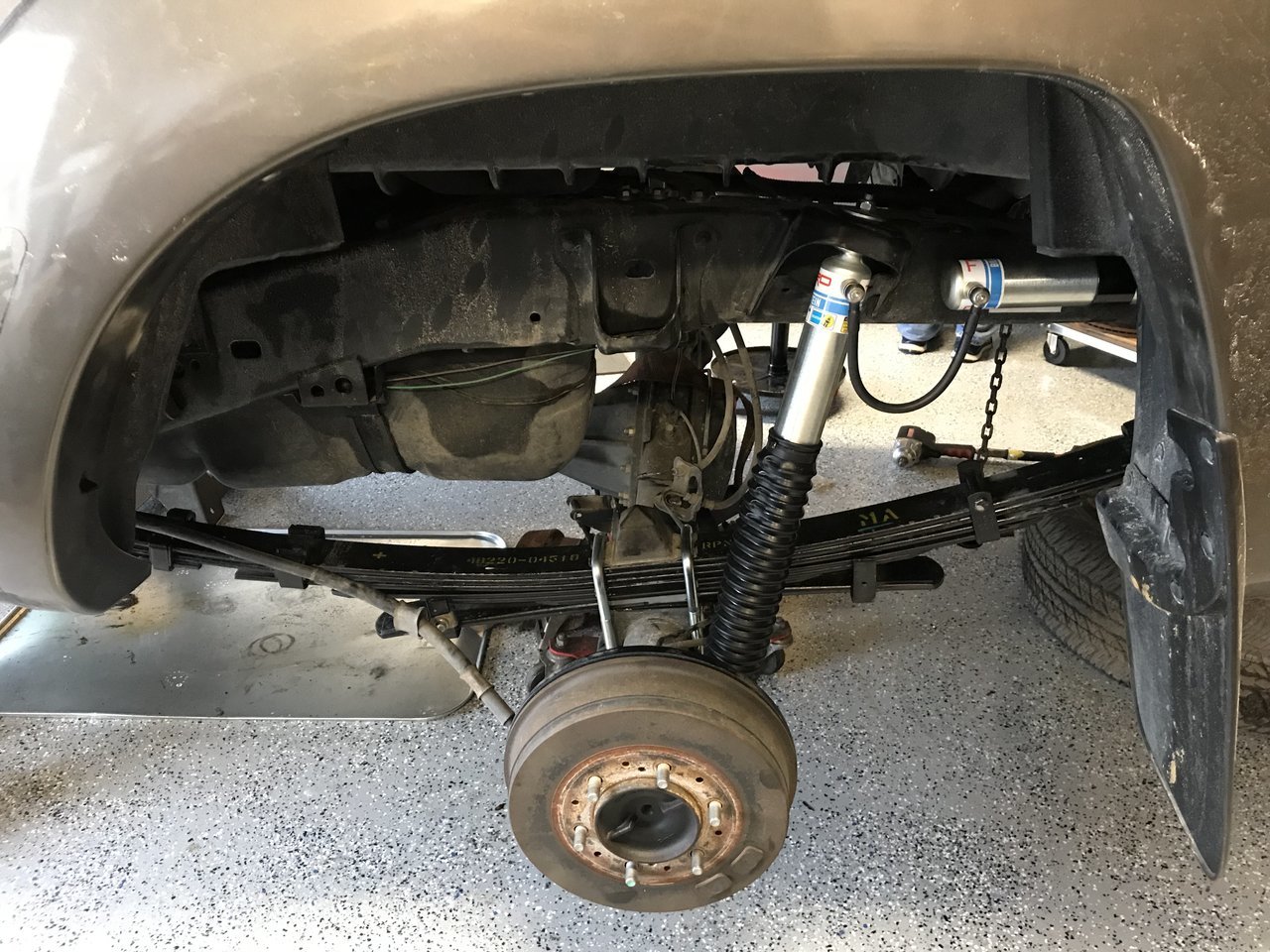

    After a few days, some light off-roading and ~500 miles here are the numbers on from my 2015 TRD OR 4x4:
    Quick Spec Reminder
    TRD Suspension Upgrade kit
    + 1/4" HS top plate spacers up front
    + Wheeler's progressive 3 leaf AAL w/Overload IN in rear
    (on stock 3+1 leaf pack)
    sitting on 265/75-R16 Cooper Discoverer A/T3s
    Front Left - 23"
    Front Right - 23 1/8"
    Rear Left - 24 7/8"
    Rear Right - 24 7/8"
    I think the fuel gauge says a bit less than 3/4 of a tank at the time of measurements and no load in the bed.
    Pic at update:
    Since I didn't take pre-install measurements, I'm using @NMTrailRider's pre-lift measurements as reference...
    so looks like I'm effectively gaining ~ 2 13/16" of lift up front with the TRD setup + 1/4" spacers and ~ 2 3/4" in the rear with the Wheeler's progressive 3 leaf + OL and left with a rake of ~ 1 3/4".

    Let's call it 2.75" up front for you (for ease). 1/4" front spacers = .5" lift. So, you're netting 2.25" lift in front from the coilovers alone. That's the most I've seen yet.
    Now, it's very possible our measurements could vary by 1/4" in user introduced error. But your report/results makes me think 2" is more to be expected than 1.75".
    Am I making sense? It's late in the day and I'm beat. Hmmm. The 2.75" in the rear also sounds high, compared to earlier reports?
    When taking into account two different people measuring, plus two different trucks... I wouldn't bet on these measurements/comparisons as being stone cold truth. I'm not criticizing and more data is always good. Just pointing out the reality. I'm also not saying this isn't the reality. It might be true.
    Pre and post measurements by the same individual on the same truck is important.
    Thanks for sharing this info. Keep it comin, guys!

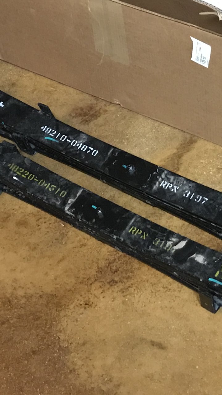

    I received the General Spring HD pack yesterday. Haven’t installed it yet, but supposed to net around 2” rear lift. As far a quality, I’m impressed. Very well built. I didn’t trust adding an aal to my factory leafs.

    Check it out. I will install this weekend or next, but my buddy has these springs and really likes the ride. I have a shell so the extra weight carrying ability will be a plus.

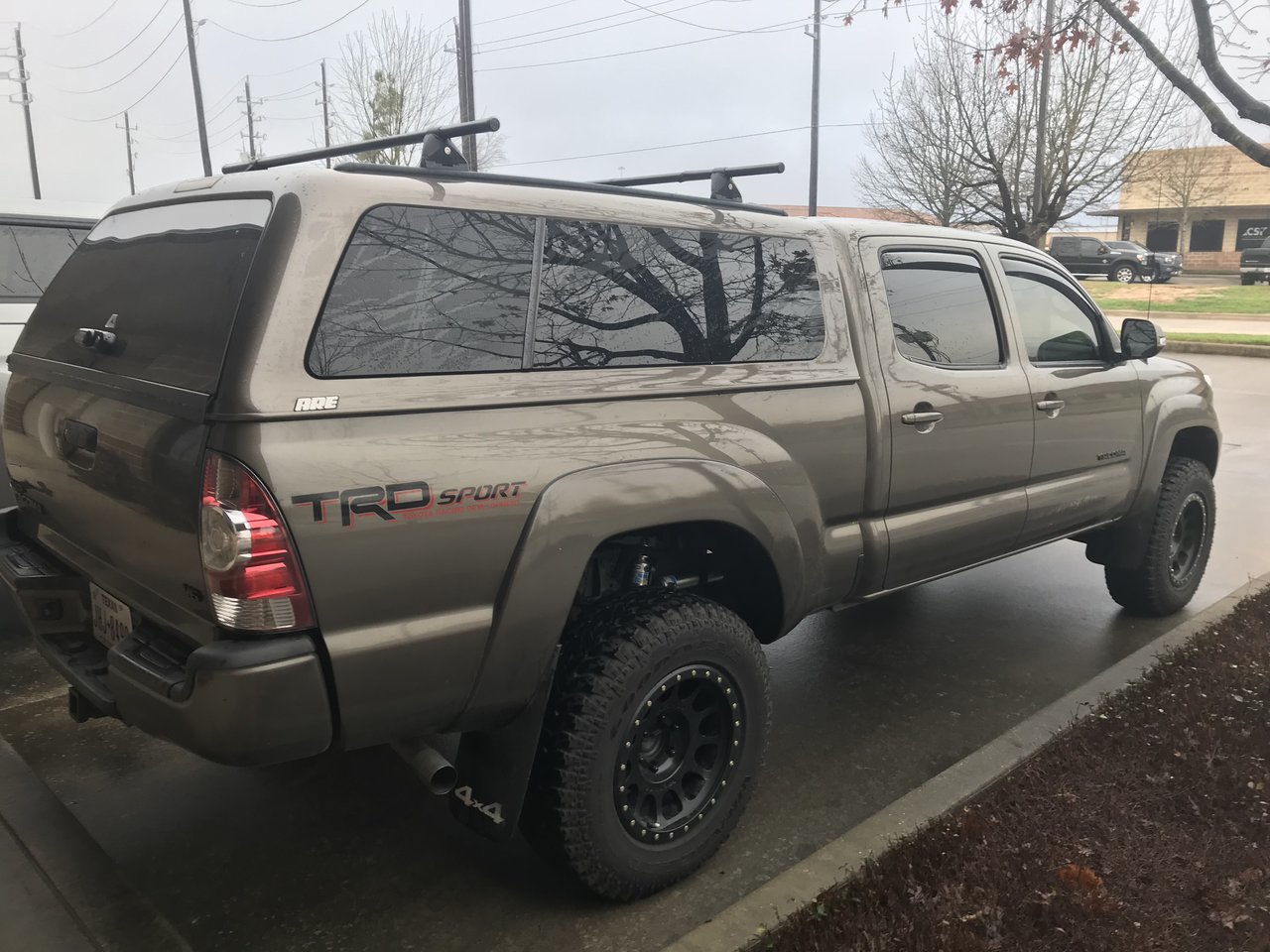

    I have 60k miles on my original 3+1 pack. It's not frowning but it's pretty flat, it's 1/8" inch away from resting on the overload springs. I have a canopy that never comes off.
    I can get a new take off TSB springs for $80 and do an add a leaf ... what do you guys think?

    I've got 15,000 miles on a 2" single aal, with the stock 3+1 leaves, and have had great results. I frequently haul with the truck, on very very rough roads, have a heavy cap with toolbox mounted at all times, have carried as much as 1200 lbs in the bed, and am very pleased with the ride. I see people often say on here that the single AALs produce a stiff ride, but my experience has been the opposite. My stock leaves were almost sitting on the overload with just the cap and nothing in the bed, so the AAL actually lifted the leaf pack up off the overload and produced a more comfortable ride. When I first installed it I figured it would get me by until I could afford to upgrade to a full pack, but now i have no intention to change it in the foreseeable future.
