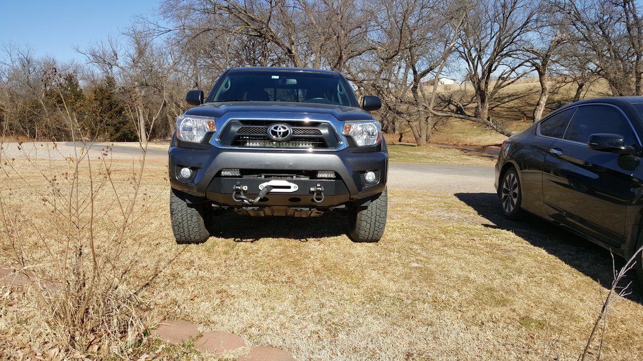

    Ok, i'm going to cross post this to see if i get any hits. I got the Pro setup sitting out back, like many of you, waiting to be installed.
    Looking for some Pro owners that have a little weight up front and what their hub to fender measurements are, if they remember. My weight is 120ish Also what ride is like, etc... If you dont mind. I know Dave chimed in on an earlier post of mine. I'm trying to determine if i should look at swapping my Pro springs for some Baja or equivalent 650's.
    What it looks like now, minus the Duratrac's

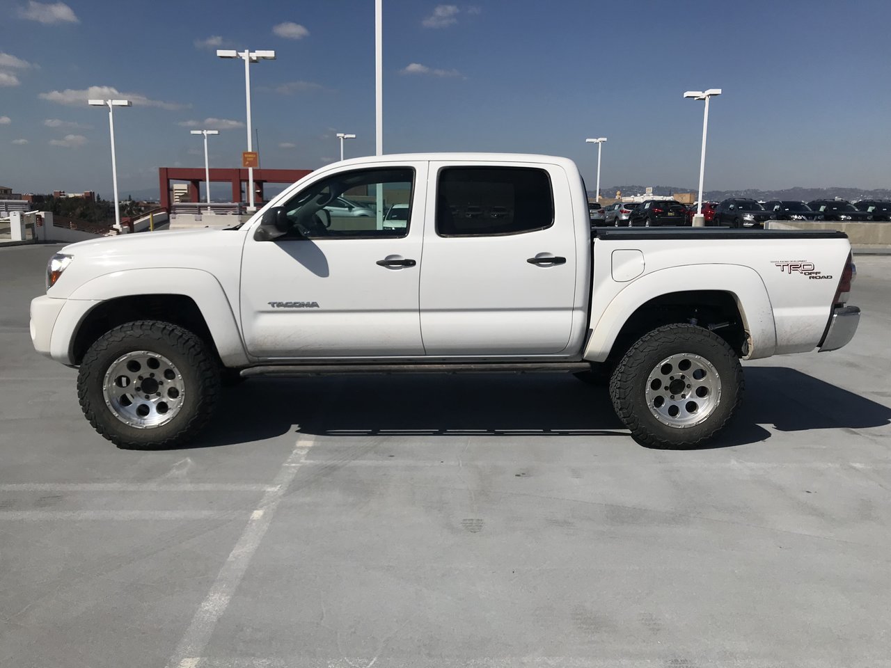

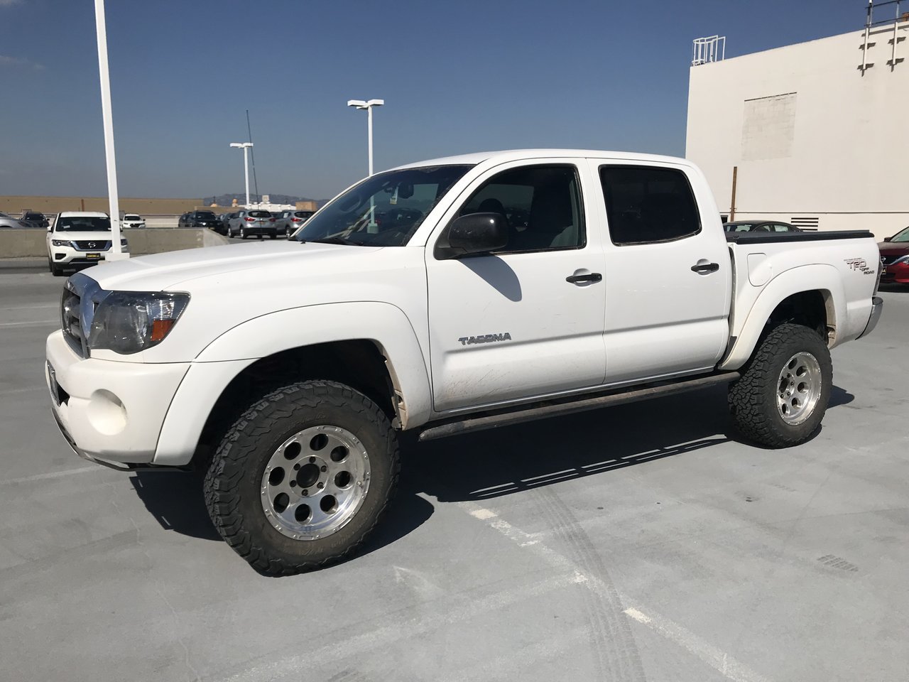

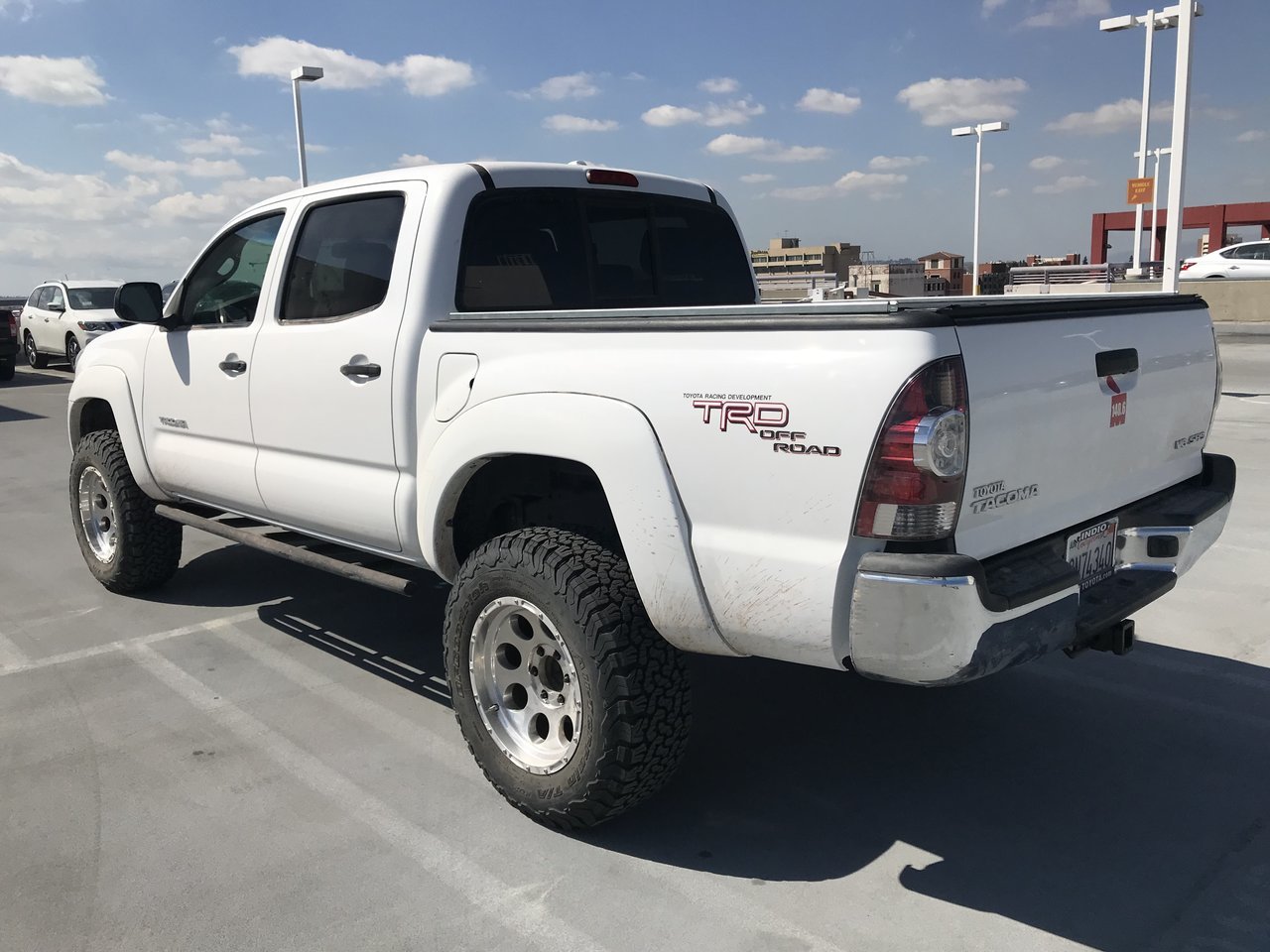

    This is what it looks like with Dakar EL095R (new, medium, all leafs in place) leaf springs.

    That’s perfect. Looks good.

    Thanks buddy, I'm pretty dang happy with how it came out.

    I debated Dakar’s for a long time. Looks like a perfect match. How’s the ride?

    A little worse than stock, but very far from what I would call annoying. I debated for weeks too vs AAL, but then it occurred to me I can sell my OEM-TSB leafs going with Dakar's and probably be into it within $100 of AAL and have an "all new" setup. With Dakar mediums (6 leaf), you can basically turn it into a Dakar heavy duty (7 leaf) by buying the additional spring. (I like this idea way more than a typical AAL)

    great results. Perfect.
