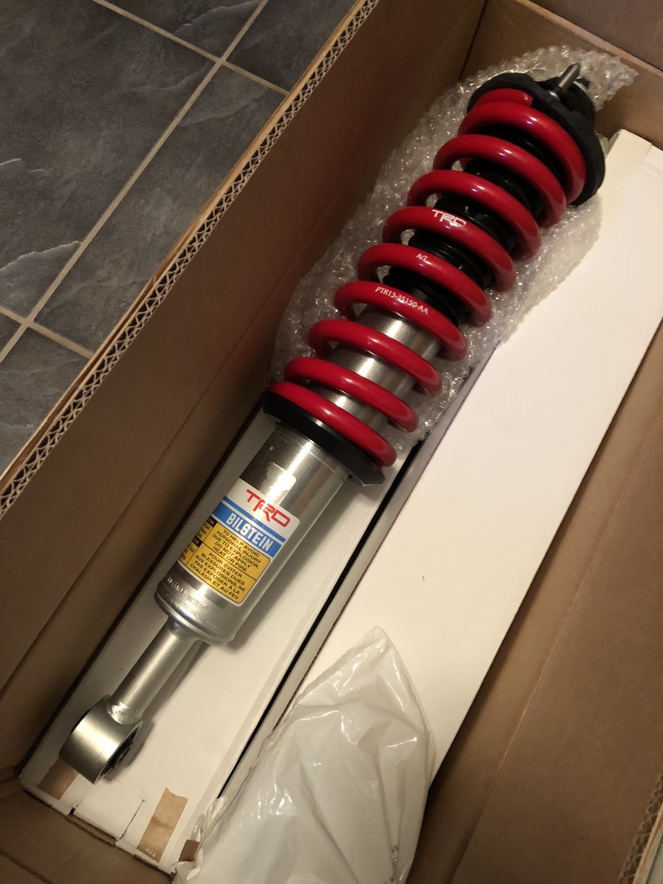

    I just got mine in today too from rogue-offroad. Numbers are good and no issues with the FedEx shipment! Hopefully install the front suspension this weekend and then decide what to do with the rear. Will do an aal if nose high.

    Not going to lie, I am jealous...
