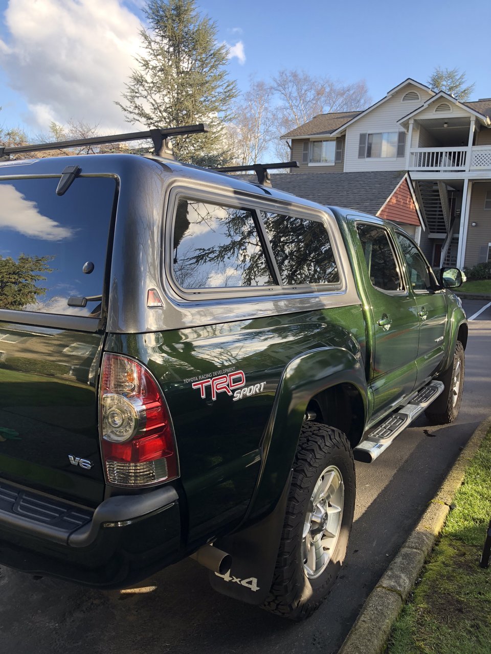

    For anyone interested in the Single Leaf AAL.
    I have nothing to compare it to, since I have never installed the progressive 3 leaf packs or driven a truck with aftermarket leafs, but after installing the wheelers 1.5 inch AAL for my stock 3+1 suspension with 51k miles on it, the rear felt very stiff until I put a leer canopy on the back. What a difference. The truck has not sagged at all and maintained the lift in the rear, rake is very comparable to stock, and the ride is much better than it was when I had no weight in the back. For those of us on a budget, the single AAL isnt nearly as bad as I feared they would be.

    Looks good!

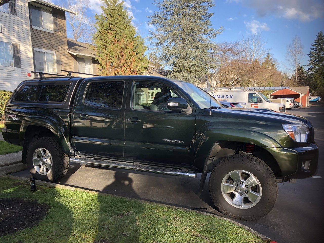

    I don't carry weight around very often, and I want to have a little bit of a rake (after the trd pro lift in front) but less than stock. so I figured the 1.5" lift would suffice for the rear but you are expecting around 2" lift from factory to the Generals without an aal? I looked at my springs and they are a little flat which makes me think I will definitely be a little nose high.
    Current look Completely stock and gas tank on empty. 52k miles
