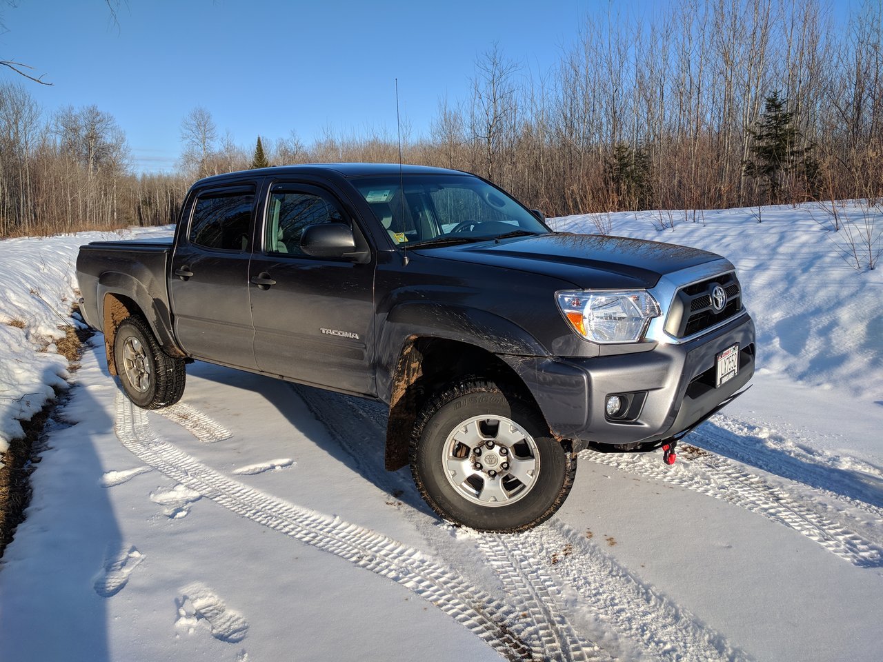

  10. Mar 3, 2018 at 4:55 PM
    #1290
    LarryDangerfield
    LarryDangerfield One Larry a day keeps the money away ™ Moderator
    Apr 16, 2017
    #216434
    8,632
    Tyler
    Northern Wisconsin
    Black 2020 Nightshade Edition 4Runner
    Oh there will be some mods all right
    Picture after seeing what the kit is capable of. Still loving it.

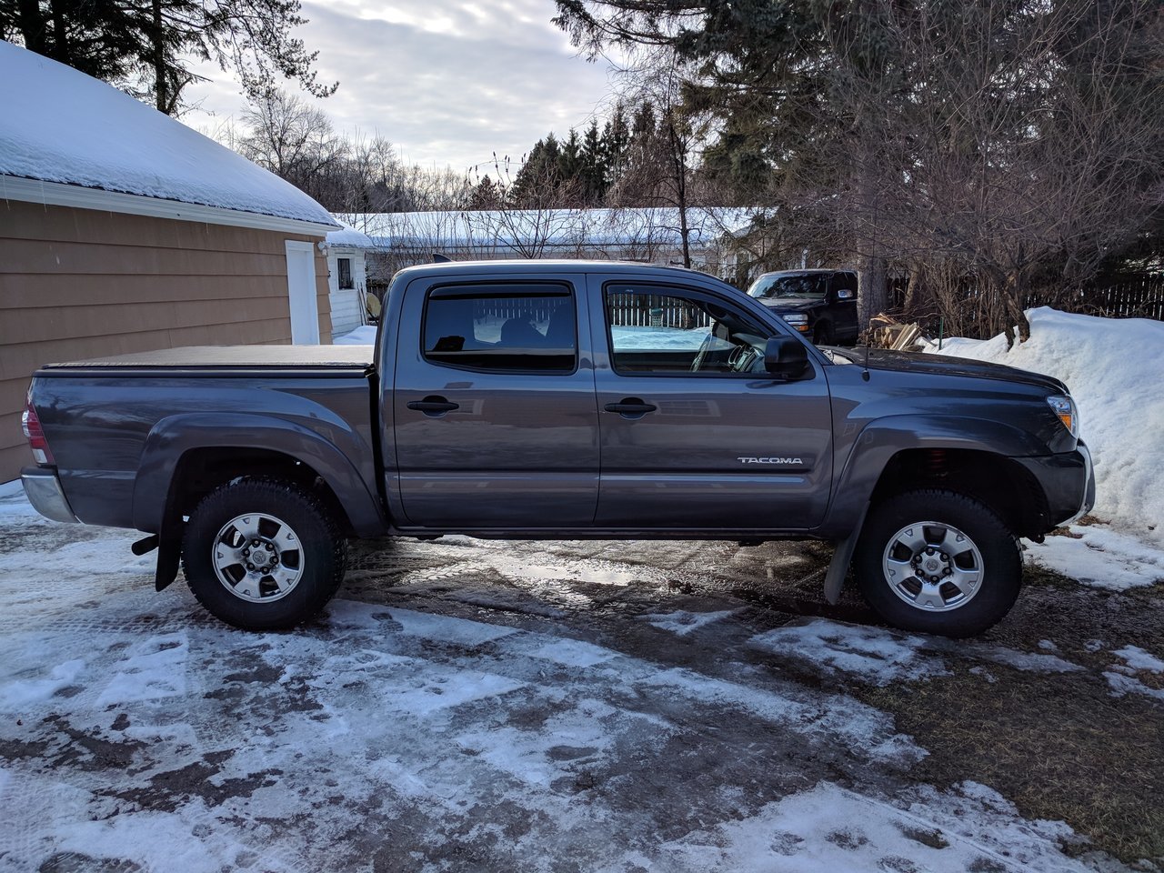

  19. Mar 4, 2018 at 7:57 AM
    #1299
    poseytaco
    poseytaco Well-Known Member
    Jan 5, 2012
    #70047
    776
    Nicholas
    Indiana
    2012 Off-road
    Not the I best pics, but front driver hub to fender 22. Rear driver 23.5. B36D195D-DD21-4113-A2BB-1CCFFE4F5F54.jpg
