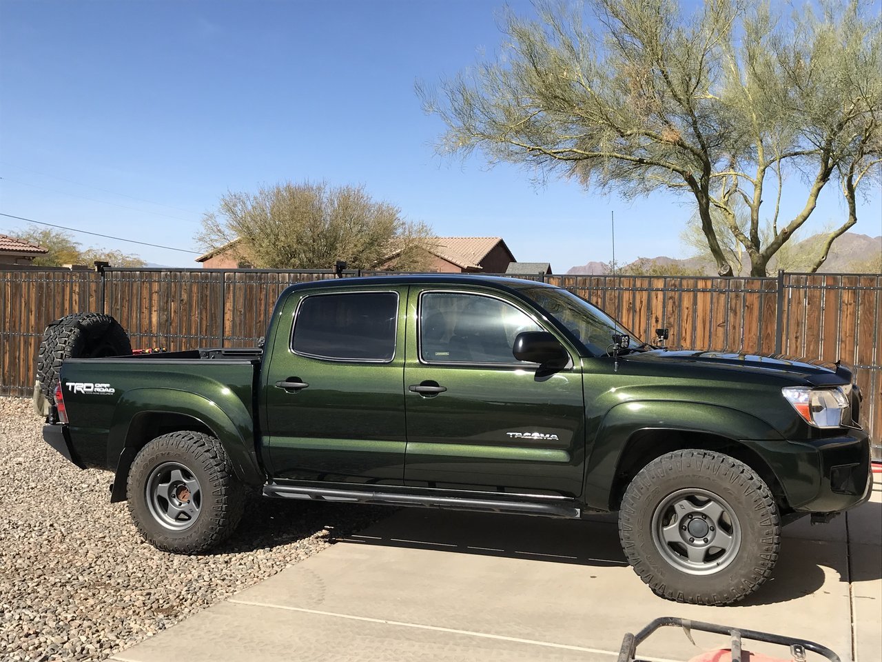

    Got mine done on the weekend.
    Pre:
    Post:
  5. Mar 5, 2018 at 12:09 PM
    #1345
    Sharpish
    Sharpish Well-Known Member
    Jan 4, 2016
    #173981
    3,830
    Brian
    Victoria, British Columbia, Canada
    2012 Tacoma TRD OR 4x4
    That's a solid amount of lift! What did you do to the rear?

    Icon RXT leaf pack with all leaves installed.
  7. Mar 5, 2018 at 1:25 PM
    #1347
    sioux
    sioux Well-Known Member
    Feb 10, 2016
    #177767
    468
    Northern Minnesota
    2012 DCSB SR5 4x4
    Any spacers in the front? Or just the TRD coilover?

    Just the TRD coilover.

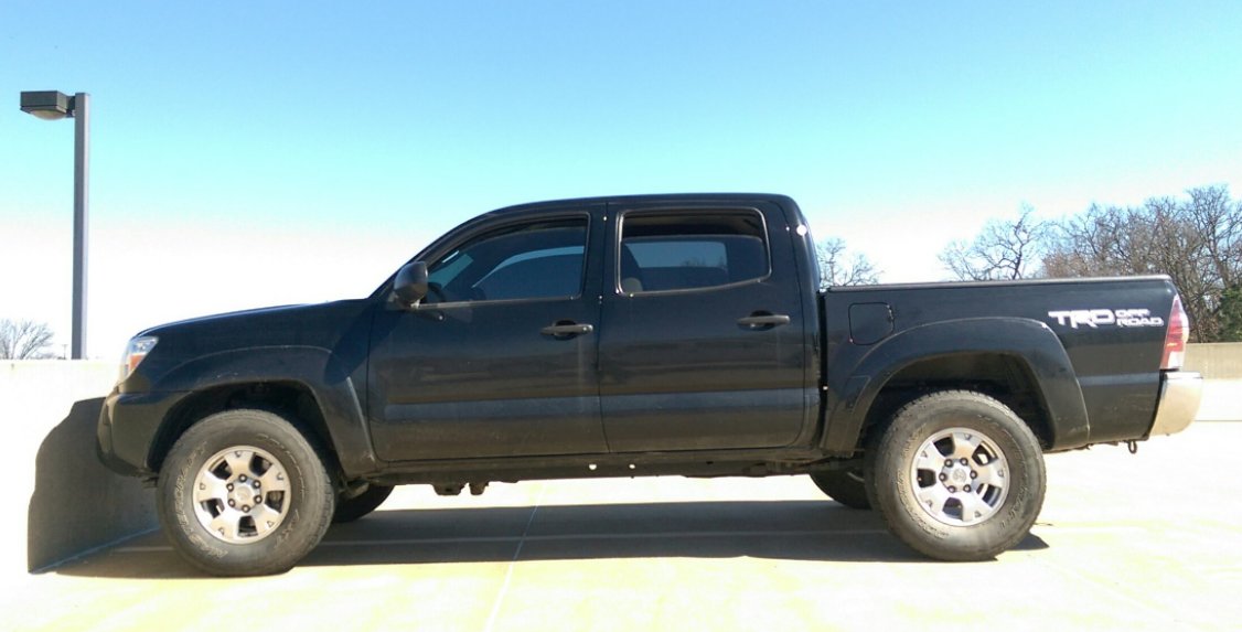

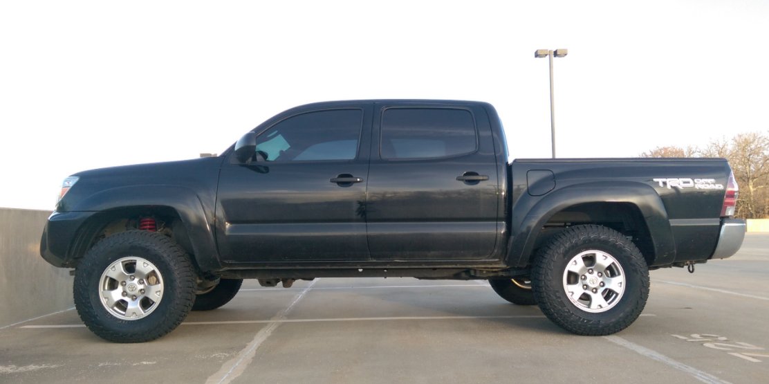

    Update: sadly as mentioned before I lost my pre-lift measurements
    what has been done so far; trd pro suspension kit installed by me = front springs/shocks + rear shocks | no aal, no spacer, stock leaf pack.
    additional item between pre / post lift pictures. new tires,
    previously mastercraft axt's (265/75r16) a litter over half way spent.
    now Falken WildPeaks (265/75r16)
    Current measurements: (a little above half a tank of fuel, no other "heavy gear".
    Before: dirty
    After: still dirty, but at least lift and new tires :) there's a little red showing in the front :)
    near future: I am about to order the 1/4" spacer for the front.
    for the rear, I'm still deciding between a 3-piece aal or General Springs; although I believe I'm leaning towards the general's at the moment. thought's comments?
    no alignment done yet, I will wait until after I tear down the front again to install the spacers.
    currently over 100 miles on the lift, and about 35 or so on the tires.
    Very happy with the ride quality of the lift, although I do feel like the rear leaf pack is the weak point now, but the rear shocks did make a difference, but the front made a much bigger difference compared to the stock TRD OR suspension..

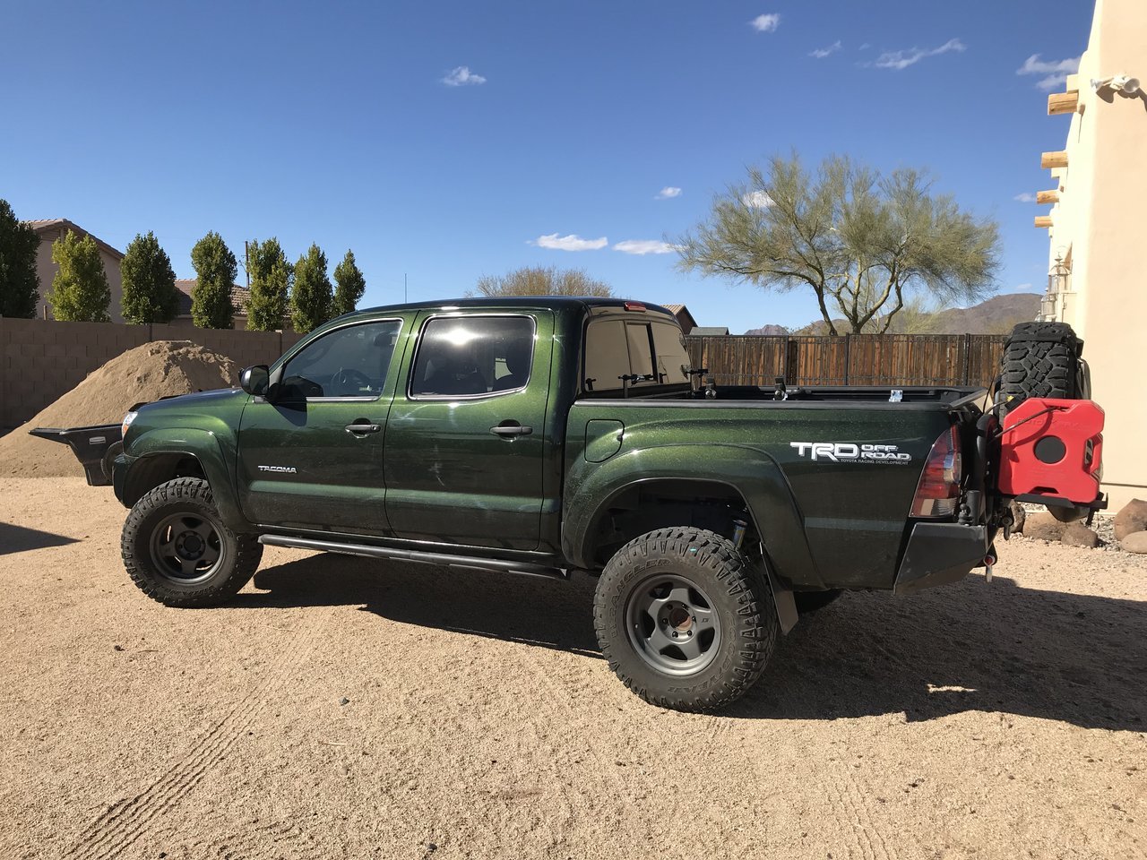

    Man, that’s a great looking truck. What rear bumper is that? It’s exactly what I’m looking for on mine.

    AllPro dual rear swingout.....bought before their customer service apparently went to hell in a hand basket.
