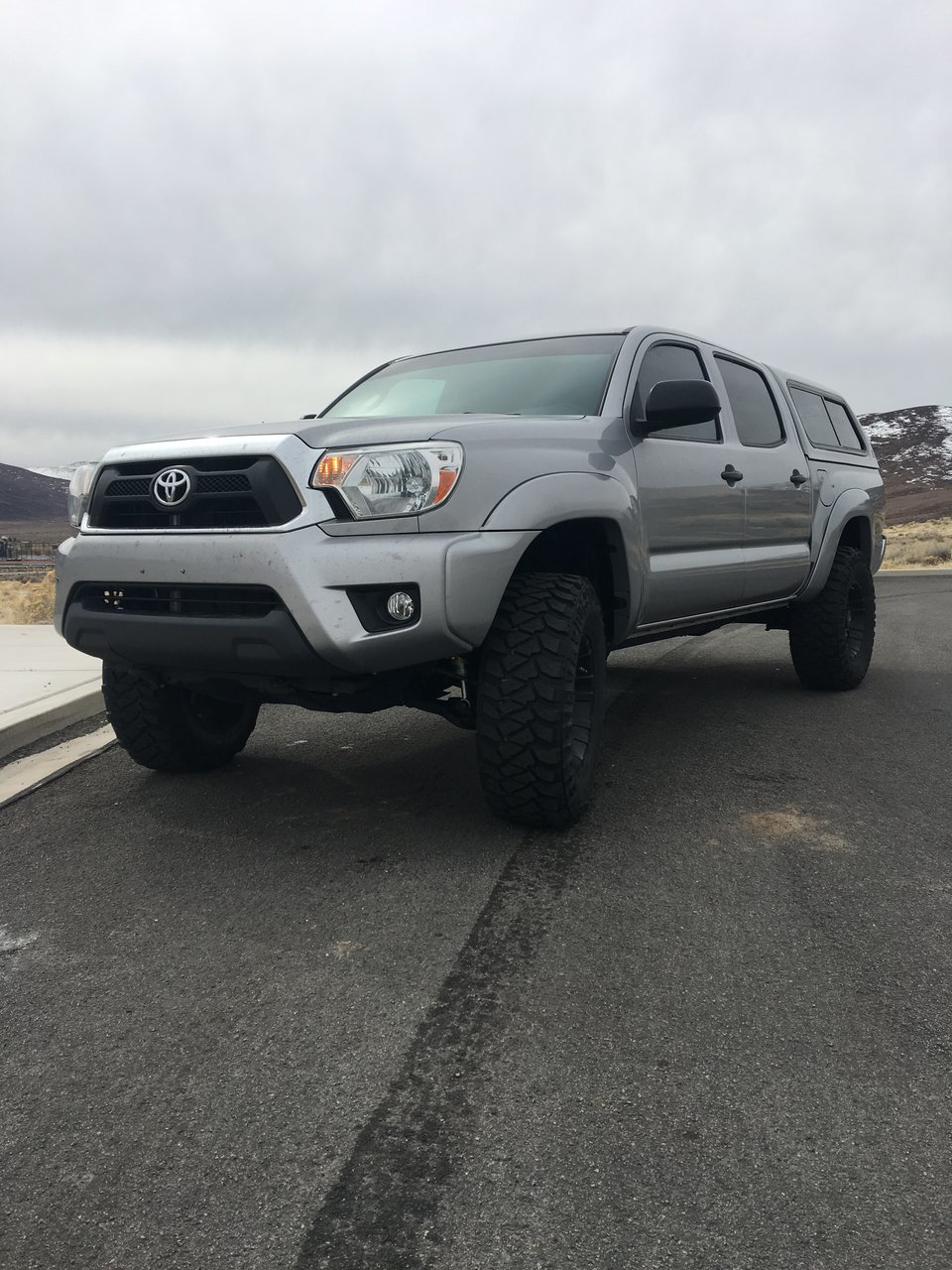

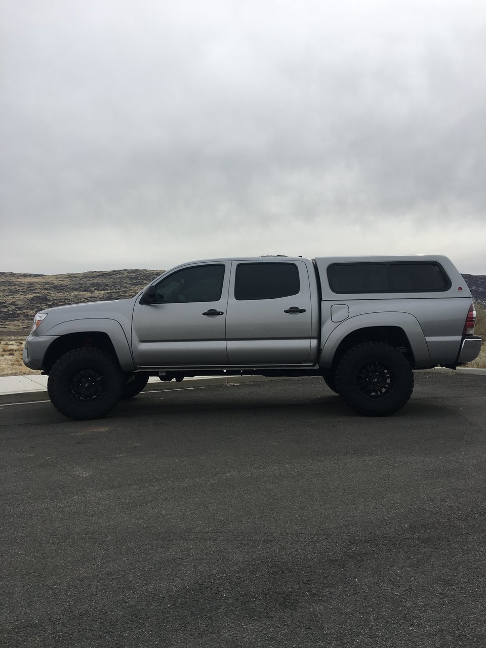

  14. Mar 7, 2018 at 10:34 AM
    #1414
    Jerradlee
    Jerradlee Active Member
    Mar 4, 2014
    #124531
    30
    Jerrad
    Nevada
    2014 Tacoma OR

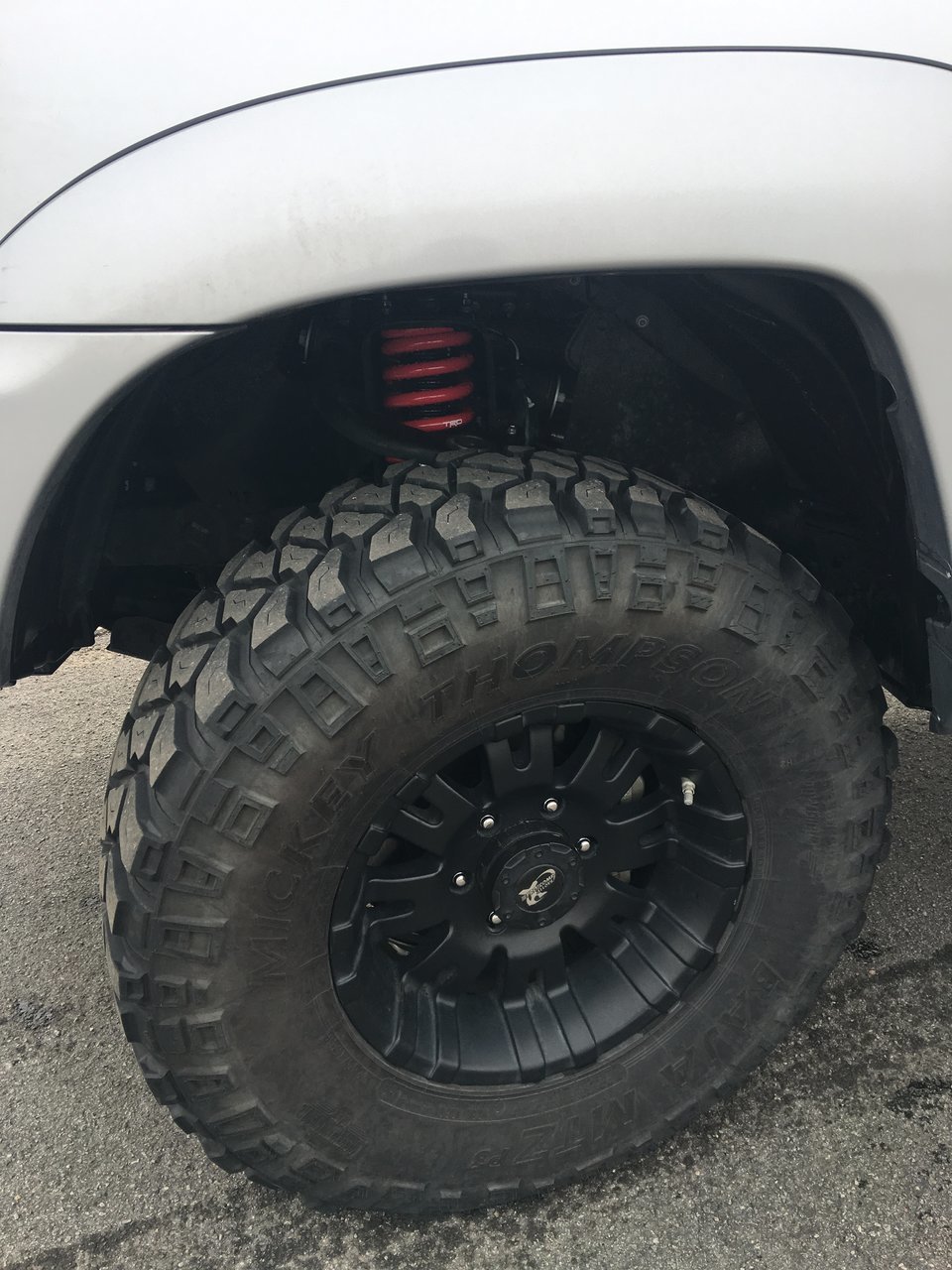

    Windows blacked out, TRD Pro suspension, 1.5 aal, Debadged, pro comp 5001 with Mickey Thompson mtz p3 285/75/16. Leer truck cap
    C6A9B9AF-D3C8-4A41-84E6-25D5626EA7FC.jpg 67BFD7CD-957B-4B83-9F98-5EE8B79EBFDB.jpg 42D22B69-F215-427A-8E21-56D852B104BC.jpg 1CC66FE5-18C8-46E8-8BCE-B46B2E655E2B.jpg I think I’m sitting pretty level.
    TRD Pro kit
    1.5 toytec aal
    285/75/16
  15. Mar 7, 2018 at 10:52 AM
    #1415
    Sharpish
    Sharpish Well-Known Member
    Jan 4, 2016
    #173981
    3,832
    Brian
    Victoria, British Columbia, Canada
    2012 Tacoma TRD OR 4x4
    That looks great! What alignment numbers did you get?
  16. Mar 7, 2018 at 11:01 AM
    #1416
    Jerradlee
    Mar 4, 2014
    #124531
    30
    Jerrad
    Nevada
    2014 Tacoma OR
    Gonna go get my alignment in a couple days. It might just be in my head. But I haven’t noticed the small vibration I was getting at like 35 mph. So I’m hoping everything else will dial in better.

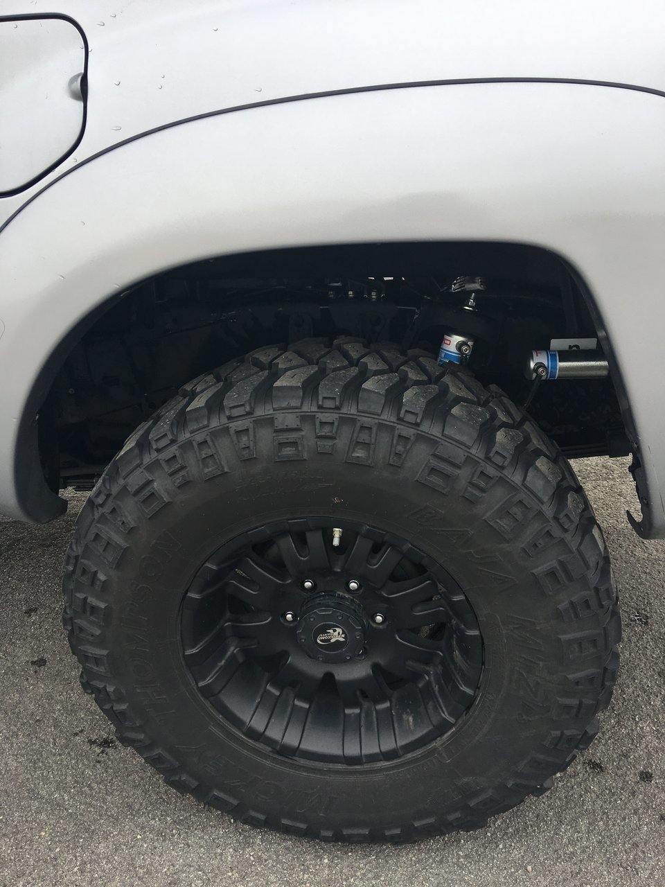

  18. Mar 7, 2018 at 12:51 PM
    #1418
    Supra4x4
    Supra4x4 IG: hash_brown55
    May 8, 2015
    #154861
    3,392
    Andrew
    SoCal
    MGM 2011 DCLB 4X4 Long Travel'd
    Whole lotta stuff
    It really depends on what you're trying to achieve. Adding this spring seat is adding 1" of preload to the coils, which will make them ride slightly stiffer. A top plate spacer moves the entire coilover downward so it increases droop limit at the expense of the collapsed limit of the shock. Depending on the size of the spacer, one might have to lower the bump stop to prevent the shock from bottoming out during compression. In either case a longer spring is better.
    CO Ryan[QUOTED] and Age315 like this.
  19. Mar 7, 2018 at 1:15 PM
    #1419
    CO Ryan
    CO Ryan Well-Known Member
    Jul 14, 2014
    #133913
    1,104
    Colorado
    13 TRD Offroad
    stuff
    Thanks for the info, I have been doing a little more research and now wondering if I should install these things...
    I think I would be ok with the stiffer ride, but is there any risk of damaging the shock with these? My understanding is that by preloading the spring, it essentially stretches the shock out a little further - does this cause potential for problems?
  20. Mar 7, 2018 at 1:34 PM
    #1420
    Supra4x4
    May 8, 2015
    #154861
    3,392
    Andrew
    SoCal
    Whole lotta stuff
    Shocks have a set stroke length, there can be no stretching when it comes to their collapsed and extended lengths. Optimally you want your ride height to be in the middle of the range so your shock has room for uptravel and downtravel. Preloading ultimately compresses the coil to extend shock (therefore increasing ride height), so you lose a little bit of down travel. 1" of preload isn't very much so no there isn't much potential for a problem.
