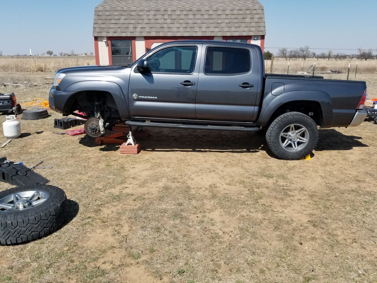

    Shops full. Screw it, doing it in the dirt.

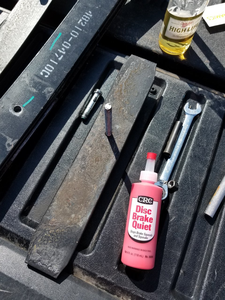

    Had this laying around. What y'all think, better than grease between leaf? Not the beer, lol...:D20180314_152107.jpg

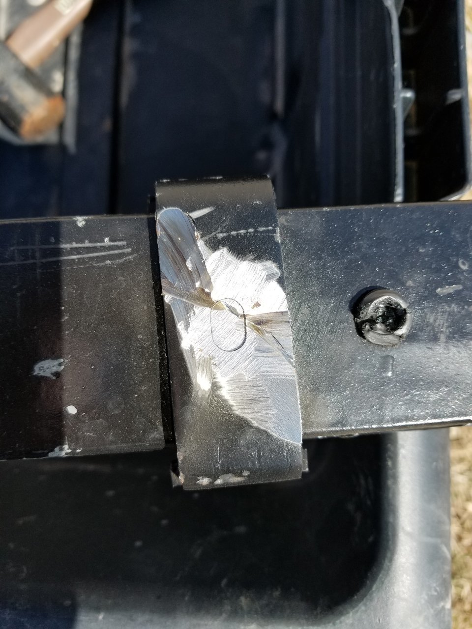

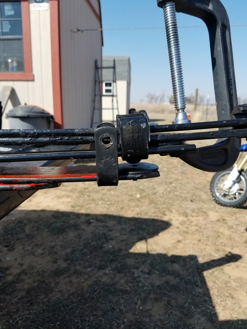

    Here we go again!
    Hell ya! Just because, I always put my tires under the frame. Made me feel a little better.

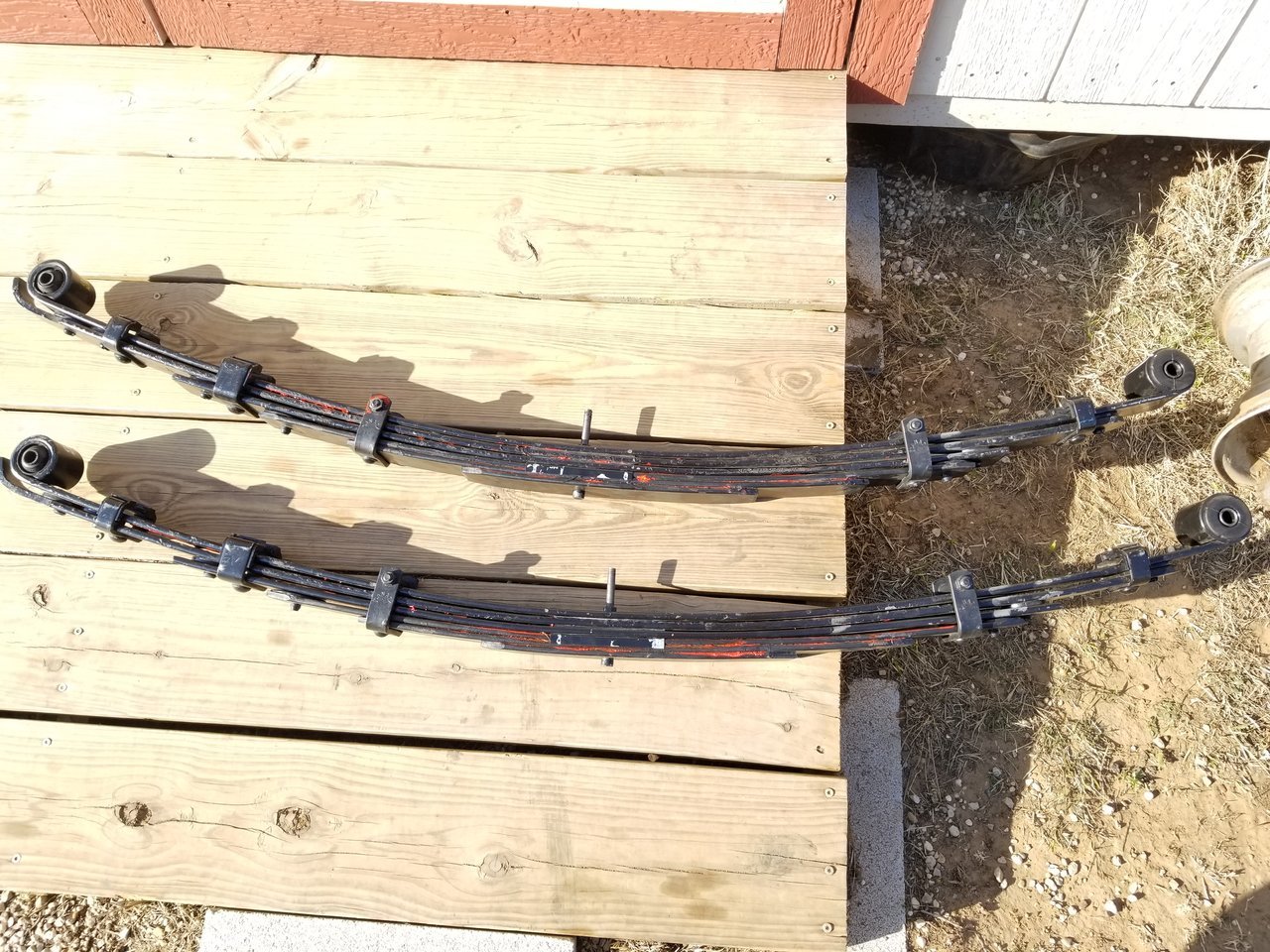

    Ya, I'll probably put that tire on and lower it before I jack up the rear. There is 2 stands and a jack in the middle. Tires aren't a bad idea. I also have to put in some Daystar cradles, build up the bag brackets, and weld the cam tabs. Got a way to go, but leafs are built. Beer helps, lol. :thumbsup:20180314_173532.jpg

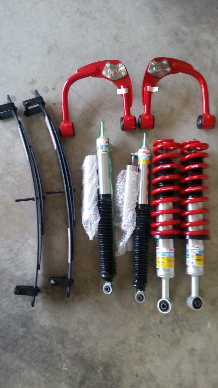

    It's not the Pro kit but the Baja kit. If it wasn't for this thread I wouldn't have found it so I thought I would share. Baja kit (adding 1/4 inch spacer on both sides), Toytec/Deaver 3 leaf AAL and JBA standard high castor UCA's just waiting to be put on.

    Very nice kit!

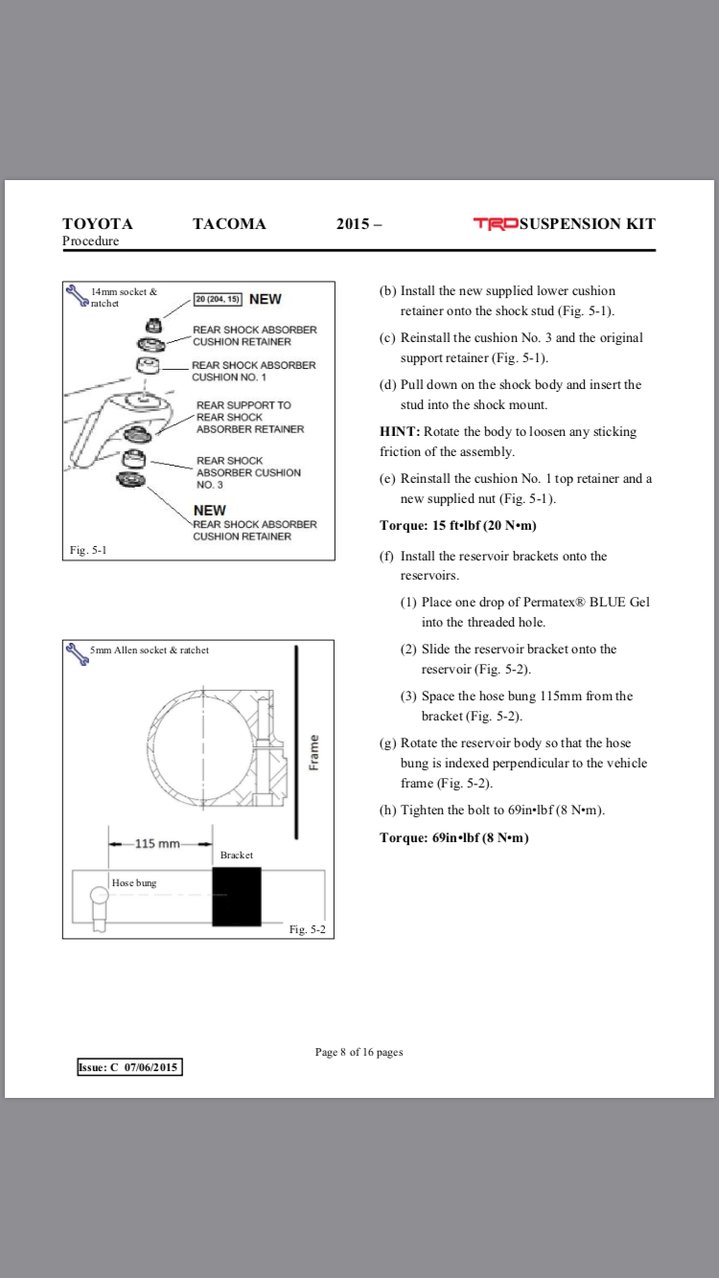

    If it makes you happy go for it. The kit will come with frame mounts already so this isn’t “needed” but if you like it more, rock on!
    The only con I can think of is that you can’t follow install instruction perfectly. The install instructions talk about how the line from the reservoir needs to be perpendicular from it. I’m not sure if it makes any difference what so ever but I personally would prefer to just install as instructed.
