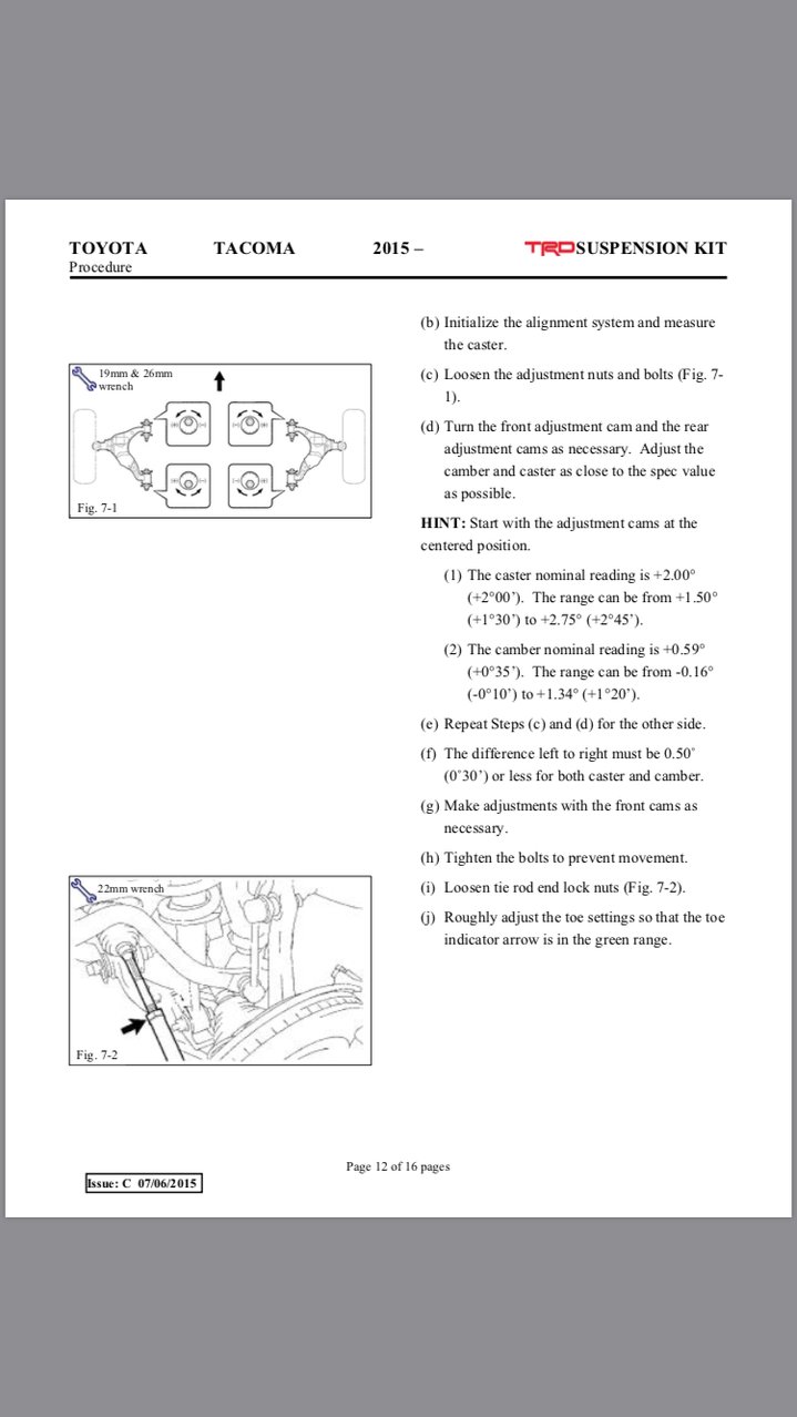

    Dakar leaf pack TRD Pro Suspension Firestone Airbags with Daystar Cradles XD127Bully Wheels 265/75R16 Cooper Discoverer STT PRO RIGID SideShooter Pros on Zroads brackets

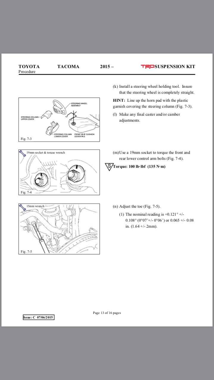

    I installed the lift this week and now I’m going to put my new wheels/tires on the truck on Wednesday. Are there alignment numbers I should be advising the alignment technician about when they’re doing the alignment???

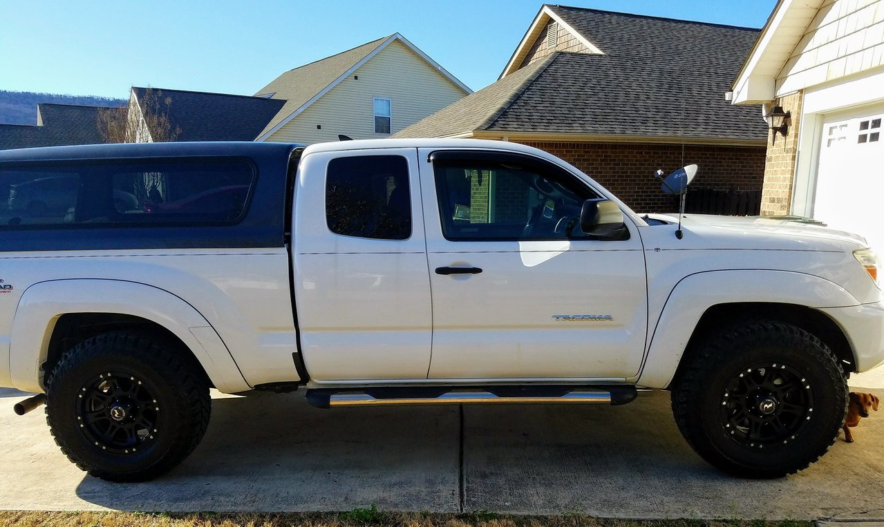

    Checked my measurements after doing about another 100 road miles and a pretty rough off road trip.
    DF: 22"
    DR: 23 3/4"
    PF: 22 1/2"
    PR: 24 1/4"
    Looks like it has settled 1/2" on driver front and 1/4" everywhere else .

    So, all said and done... Looks like you got about 2" lift all around with your set up?
