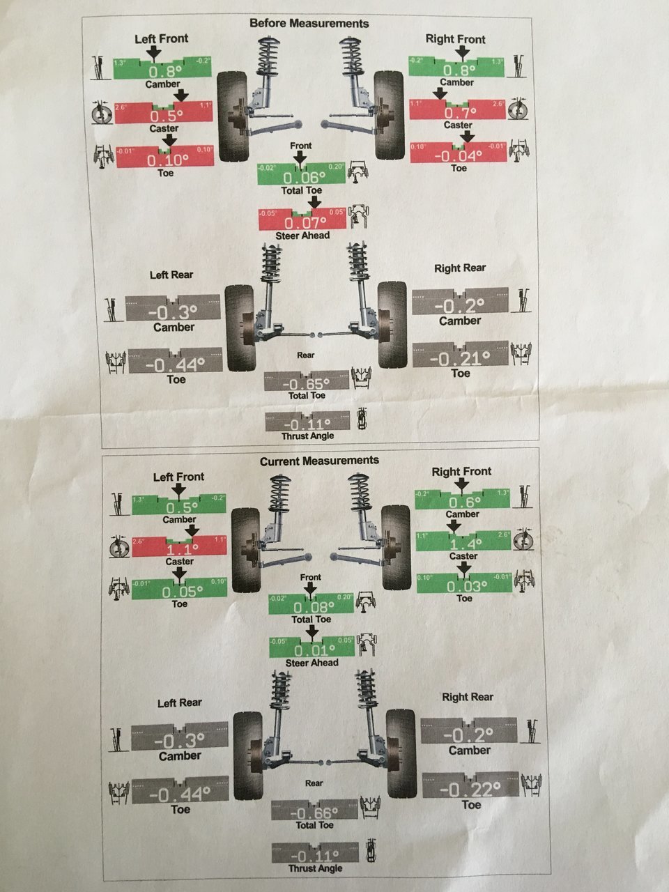

    I thought the same thing, however, I think after going with a performance UCA, we’ll be wayyyy better off...
    FYI: Attached is my alignment sheet from Toyota ...

    Since now I have to buy some UCA, I was thinking of a pair from “SPC”, borderline stock looking.
    http://www.sleeoffroad.com/products/suspension_pieces_ifs_arms.htm
    I would prefer stock UCA, just reangled for a little more droop, I’m sure the stock ball joint can handle the total articulation, just not the range we run with a lift.

    I’m going to drive with this kit a few more miles and see if it settles. I’d like at least 2.5 caster....at 2.75” lift, I doubt I can get that out of the stock uca’s. I have Spc light racing uca’s on my 4runner so I’ll go that route on this access cab if needed. I had a 2007 double cab (5100’s @1.75”) that I could only get 1.5 caster (stock uca’s) and hated how it drove on the highway....constantly correcting steering.
