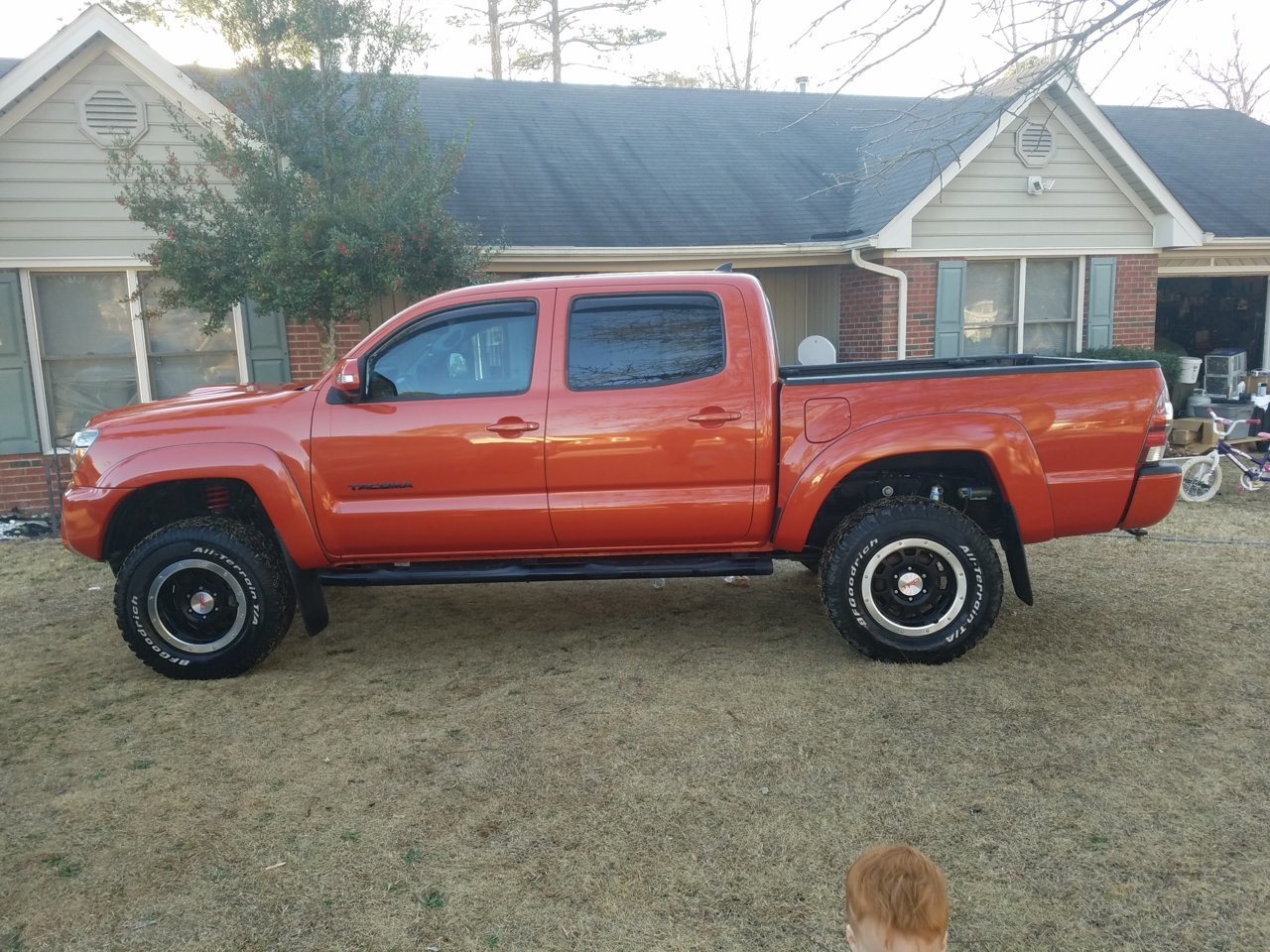

    Completed lift install last night. Running:
    TRD PRO Suspension System (Bilstein)
    TOYTEC TRD PRO 1" front lift (spring perch)
    TOYEC BOSS Rear Leaf Springs
    Before measurements (Hub to fender):
    LF 20.25 RF 20.5
    LR 22 RR 21.5
    After:
    LF 23.25 RF 23
    LR 24.25 RR 24
    Net gain, about 3" in front and 2" in back.
    More info/photos in my build thread: https://www.tacomaworld.com/threads/halle-berry-build-thread.431420/
    sorry for the terrible pics...

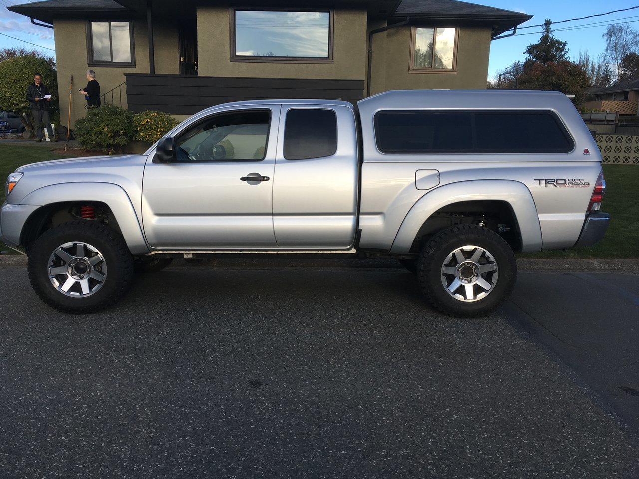

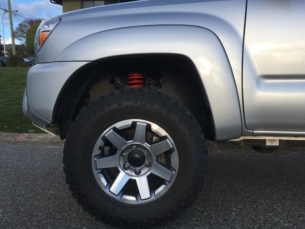

    Today is the big day!
    my brother in law and I are putting in the PRO Kit, new TSB take off leaf and add a leaf.

    8 hours, 12 beers, 2 busted knuckles, and 1000 curse words later ......

    :thumbsup: what's your measurements/gains?

    I will measure tomorrow, too tired right now. Visually it looks huge. I'm thinking 2" all around

    After measurements. No settling yet as it's one day old. I expect the fronts will come down 1/2"
    DF 23 PF 23
    DR 25 PR 25
    Driving impressions. (Limited) thus far. Firm yet forgiving, the usual bumps and cracks that I drive over would be more jarring with the stock suspension, now it's more of a muted thud That feels disconnected from the truck. Definitely a little more "floaty" going through rolling bumps but doesn't seem to have much body roll cornering or nose dive.

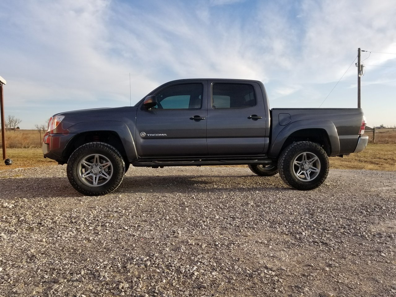

    Have 2 inch, full length add a leaf. Had the 3 leaf and it did not cut it, much happier with the single.
    This is normal 0-5 empty, sits more level than the pic looks just a tiny rake. 20170219_164909.jpg
