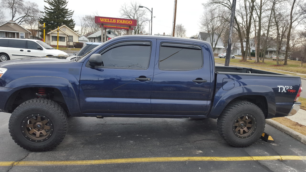

    It's an upgrade on my 2013 so I'm sure you're going to notice realize it a bunch more. I needed the rear end capability increase for towing and this kit was right in the gift horse's mouth as the right option to pair it with. Even though I haven't gotten a decent alignment yet the performance and capability upgrade is substantial enough to provide me peace of mind as to it being a solid investment.

    Think i am going to try one of URD's "fixed" tob designs and see if it holds up longer. Just can't decide if i want to pull the trigger on full hydro setup.
