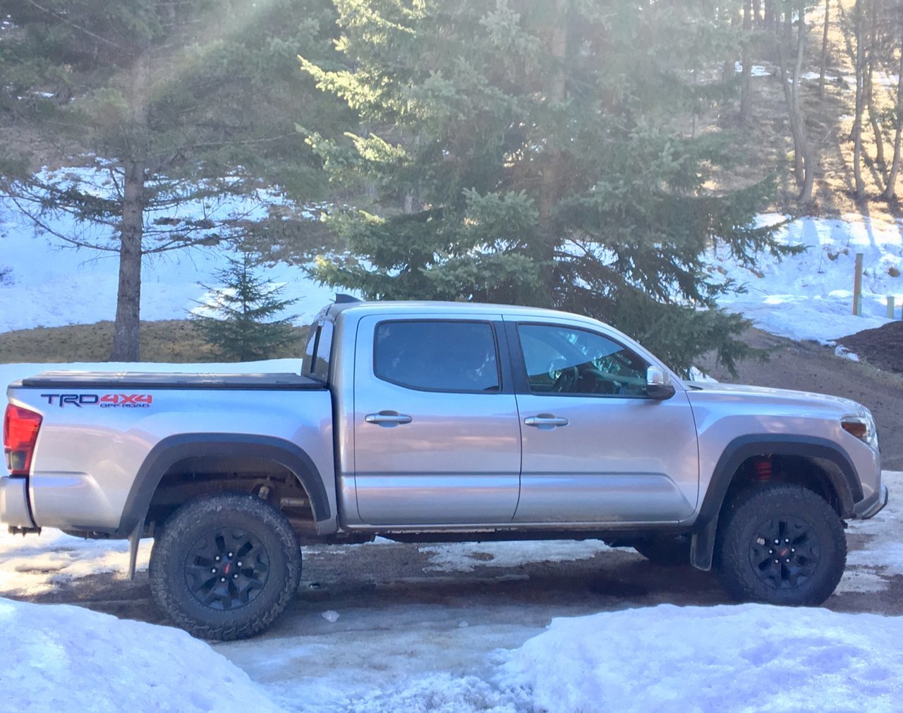

    Finally got mine installed!
    Rear is wheelers progressive AAL with overload in. Front has 1/4” spacers on both sides. I have about 100 lbs in the back and still have a rake of just over 1” from rear to front. Tires are 265/75/R16 Falken Wildpeak.
    Bad news is that my needle bearing has failed already. Has anyone had luck with the dealer replacing or am I better to upgrade to the ECGS?
    Age315 likes this.
  18. Apr 2, 2018 at 7:31 AM
    #1718
    Zacowacko
    Zacowacko Well-Known Member
    Oct 16, 2015
    #166800
    1,142
    Zack
    SW, OK
    2013 DCSB TE 4x4 6spd
    TRD Pro Susp., Icon AAL, Bags w/cradles, US OR Bumper w/Smitty, 2Lo Mod
    Dealer replaced mine after my first lift with the tsb bearing. 18 months and 45k later and still no issues.
  19. Apr 2, 2018 at 7:46 AM
    #1719
    AFPhi404
    AFPhi404 Well-Known Member
    Jan 9, 2018
    #240774
    253
    FL
    15 DCSB TRD OR
    Project 잉크 - Inku
    Yeah should be covered under Toyota's Powertrain Warranty. I want to say there's a TSB floating around for 3rd gens that you can bring to reference.
