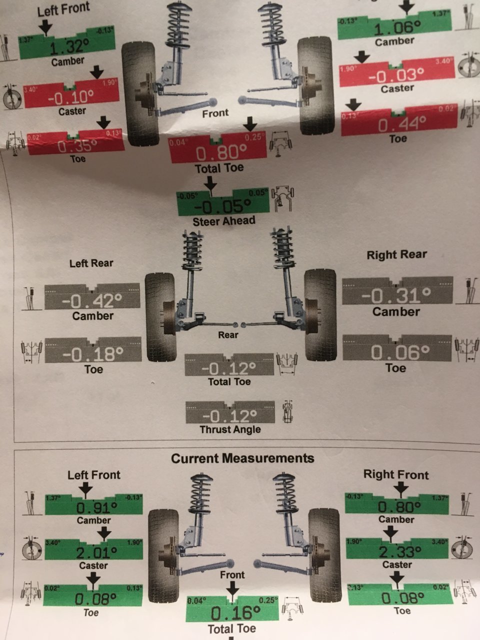

    Just got an alignment. The guy at toyota managed to get me 2.1 and 2.3 caster on the stock UCA .. at the expense of a little camber. (But not much it's still well toward the middle of spec range. ) will post picture later.
    Looks like I'm about a mile away from the cab mount now! Might be able to fit 33's with no chop.

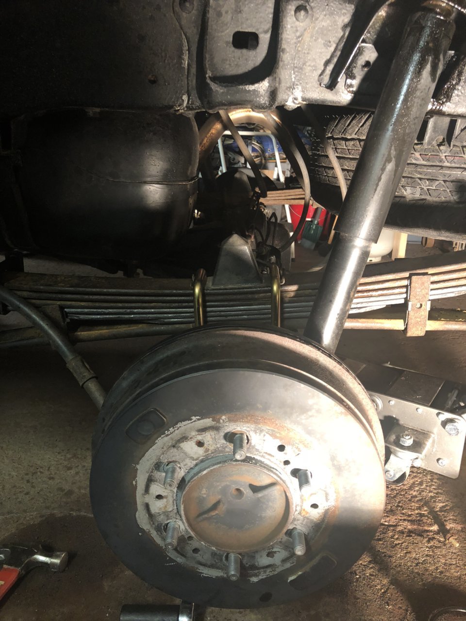

    Just finished up my install today. TRD PRO suspension with the 3 leaf progressive Headstrong AAL (with overload in). Measurements; center of hub to fender:
    Before:
    DF - 20.5
    PF - 20.5
    *DR - 21.5
    *PR - 21.5
    *About 200lbs in the bed (Sand, gear, etc).
    After:
    DF - 22.25
    PR - 22.25
    *DR - 24
    *PR - 24

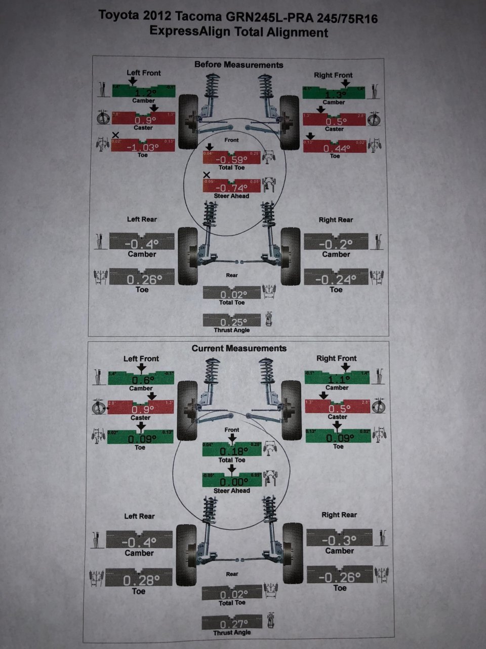

    FYI that's a garbage alignment. They did the old toe-and-go ... here is what you want ....

    When you installed the AAL did you leave in the overload? How does it ride? Good looking truck, BTW!

    Looks good! Overload in or out on that AAL?

    Yes, I left the overload in. I’ll edit my post.
    Only about 30 miles on it so far, but I love the ride. Not harsh at all, but not as bouncy as the SR5 factory suspension. No vibes either.

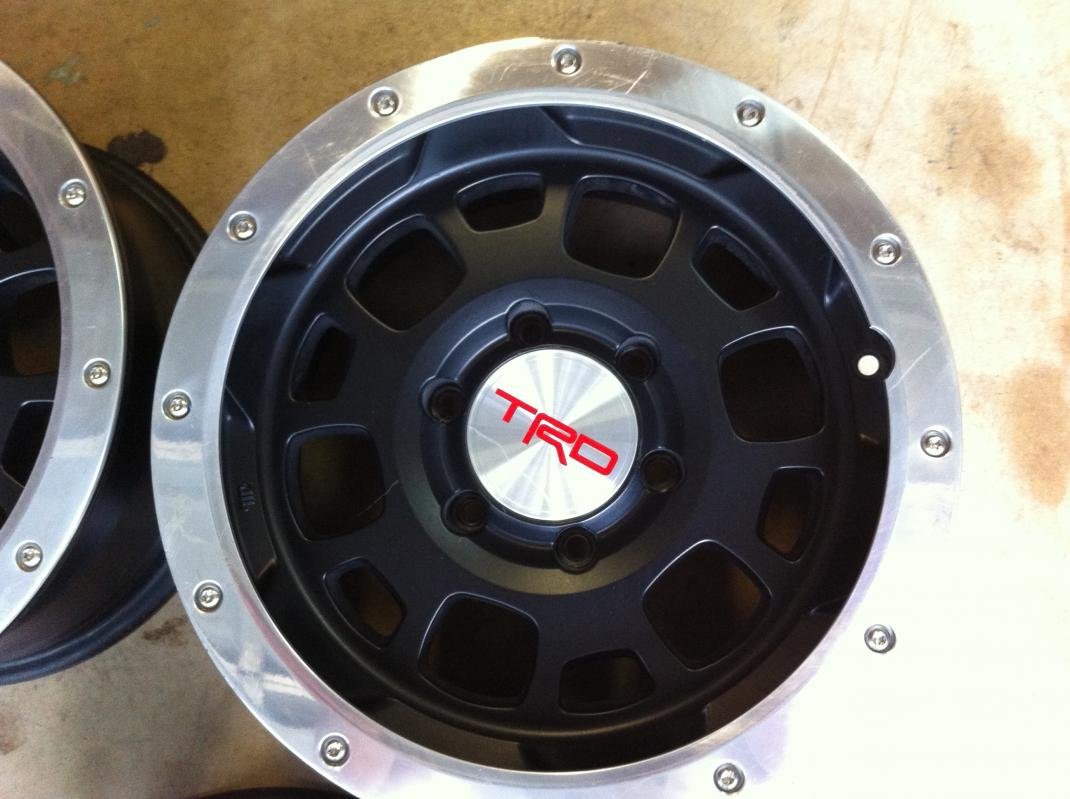

    New wheels are next on my list.

    Really nice looking truck. I like the stock wheel look.

    Thanks! I’ve been considering the black “beadlocks”.

    Nice! I have a similar setup but with 1/4" spacers up front. Now that I see that it's not as rear-high with the OL in, I'm probably going to take the spacers out though since I feel like it's too close to level right now.

    How many leafs and overloads do you have now?

    I have 6 leafs (leaves?):confused:, plus the overload. So 7 total.

    That is a lot.. I've got the dakar HD pack and I have 5 plus 2 overloads. You had the tsb leafs before?

    The truck had the 3 leafs + OL when I bought it in 2016. I seem to remember reading they changed the springs around that time (2012) so I don't think the TSB was needed. I think they were coming from the factory like that. I could be wrong though.

    I do have some weight in the back though. Not sure how much higher it would be with an empty bed. I wanted to keep the OL in since I have some weight all winter, and tow occasionally in the summer (+4,000lb camper).

    No problem. Yeah I would agree with you about keeping OL in I don't have much over 200# in my bed a few times a year.. I'm actually going to drop the 3rd leaf and longest OL out for height reduction and ride compliance.
