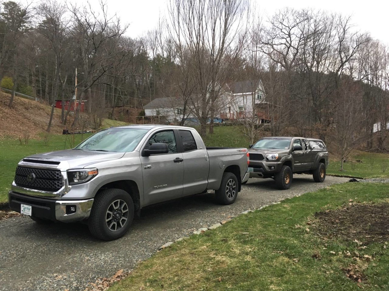

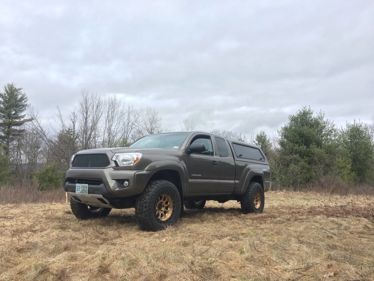

    Current Mods: - Locking Lug Nuts - Weather Tech floor Liners - N-Fab light bar - 32” Led Light bar - TRD skid plate - Leer Cap (Pyrite Mica) - Rigid TSM-22 Tow Strap Shackle Mount - Rigid Orange Shackle - @ACEkraut License plate bracket - Flashwolves LED reverse bulbs - TRD Stainless Cat Back - AFE Pro Dry S drop in filter - Glove box organizer - Center Console organizer - Bed Stiffeners - Color match grille - Custom Car Grills Perf SS Mesh flat black - Thule Cap roof rails - TRD PRO Suspension - Wheelers 2" Add a Leaf - HS 1/4 inch strut spacers - SCS Ray 10's in Brushed Copper - Cooper Maxx St's 275's - Under hood Led Light Kit Future Mods (as of right now): - 20inch LED Bar (Caliraised,Rigid, Baja) - 32inch LED Bar (Caliraised,Rigid,Baja) - LED Pods Side Projecting (Caliraised, Rigid) - Toyota Bed Matt - Quick fist Axe and Shovel mounts in Truck Bed - Cap mounted Awning - 100% No Drill Bolt on sliders - Wet Oak Seat covers (All black with TRD in them) - VooDoo Bed Bars/Basket that works under a cap
    TRD Pro suspension with 1/4 HS top plate spacer and a 2 inch add a leaf in the rear. The tires are 275's Cooper MAXX St's

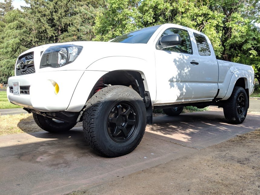

    HBuwHl60hMMvKOHNhhULvmkkiFDWzN2r7c8tJG99_7da270b4d556c63d3dd2df3507236bea33a41af9.jpg
    I am loving the TRD Pro set-up on my 2011 AC 4x4. I previously ran 2.5" Icons on my 03 Tacoma and would have gone with Icon, King, or Fox for my new truck if these hadn't been so well priced. After driving around on the Pro suspension for a few weeks on a variety of terrain I have no regrets.
    I replaced the TRD OR suspension on the truck with 60k miles, and it's definitely more firm but not harsh. Quality of everything was like OEM - because it is.
    At the same time I added SPC upper control arms, and Dakar leaf springs in the back (with the longer overload removed). I also got some 17x8 six-shooters from FN Wheels and 255/75/17 (32"x~10) Cooper Discovery AT3s. The wheel and tire combo is a pound or two lighter than the stock 16" off-road wheels and rugged trails.
    I am very happy with the combination. Minimal lift, great ride for daily driving, USFS dirt roads, and mild trails. Looks killer. Anticipating good reliability out of OEM components.
    If you can still find someone selling a kit for a good price it's a great upgrade.
