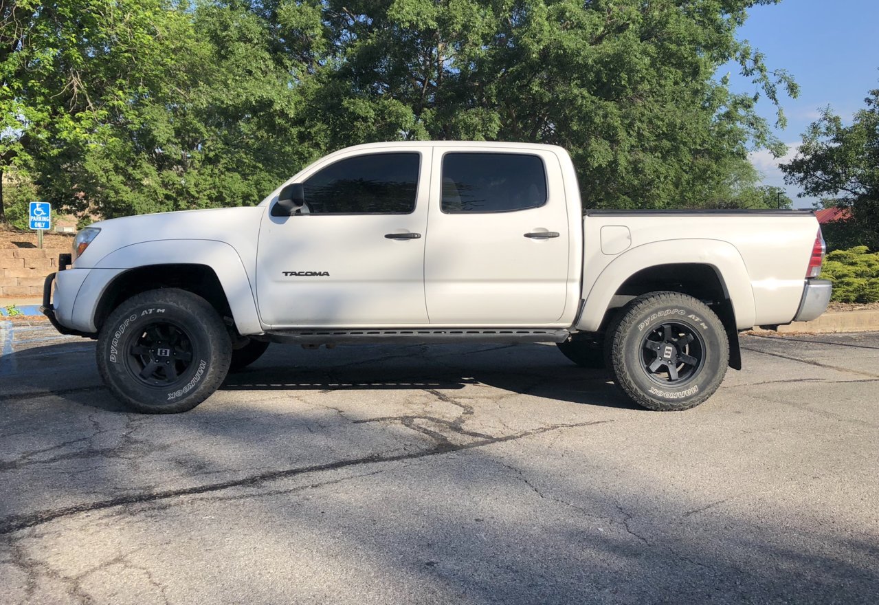

    Anyone install a new full leaf pack with this kit? What kind? Thoughts?

    I have the kit. Haven't installed it yet. Just haven't decided on a leaf pack yet (I don't want an AAL).
    What do you mean by "place holder"? I know I want a full leaf pack, but haven't found one that will give me near factory rake (and won't be too tall). In your opinion, are the Dakar's a good option?

    It says 2.75" of lift. So with the 1.75" lift in front from the Pro kit, wouldn't this give you an extra inch of lift in the rear vs. the factory rake?
    I understand factory rake to be about 1.75" (that's where mine sits now).

    As for rake, yes. The dakars will make you roughly 2" higher in the rear with this kit. I'm running 1/2" spacers which provide me with an extra 1" of lift at the wheel so I'm only 1" up in the rear before I add my shell which should bring it to about level. That's with a DCLB.

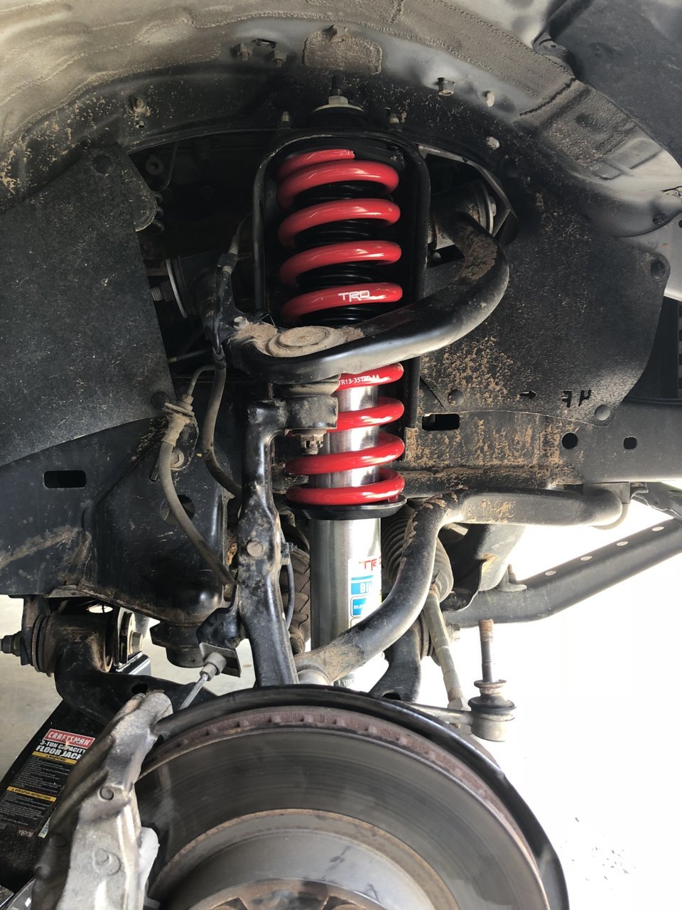

    Fronts done. About 3 hours of work. Now on to the back!

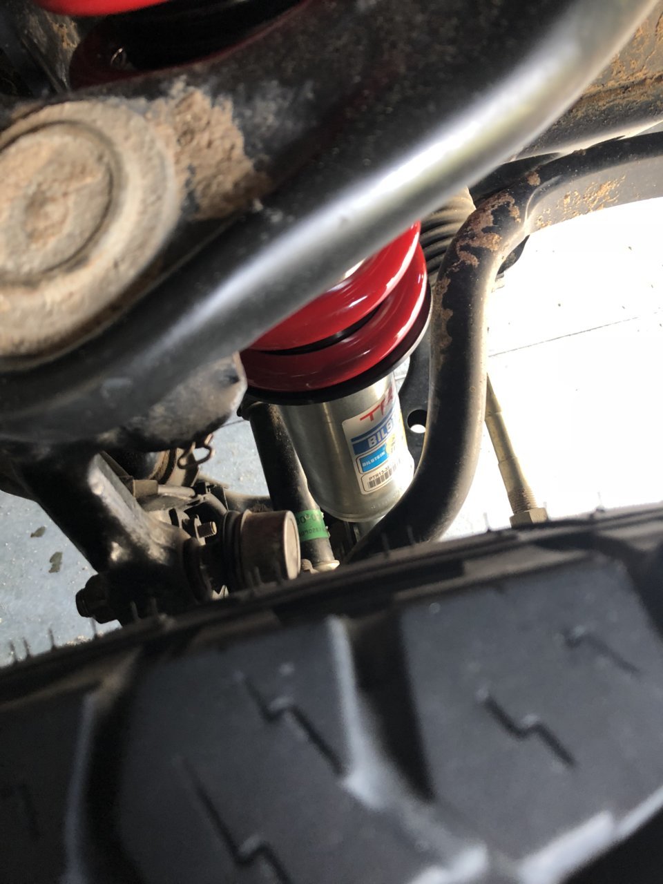

    Sway bar doesn’t seem to be any closer than with the factory coil over. It’s a close fit in general. Plus the sway bar sits below the coil so there’s a little more clearance between it and the shock body. Looks closer than it is in this pic from above. This is with the tire on.
