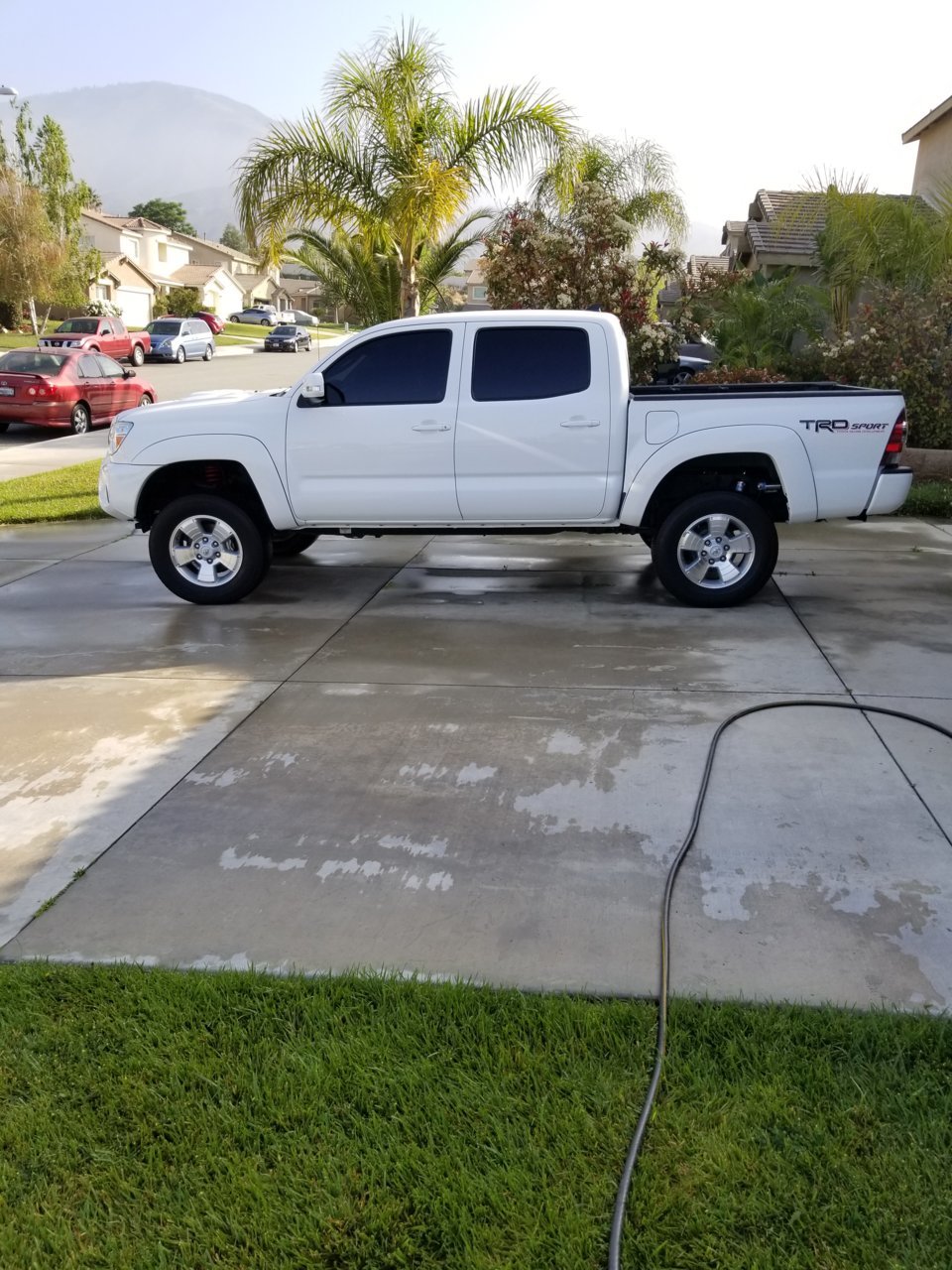

    TRD Pro suspension with 1/4" spacers on each side Icon progressive AAL with the overload left in Method NV305 265/70/17 Falken Wildpeaks AT3W
    I reinstalled my overload, I like it a lot better. It has a full 1" take now. Looks more factory than without it.

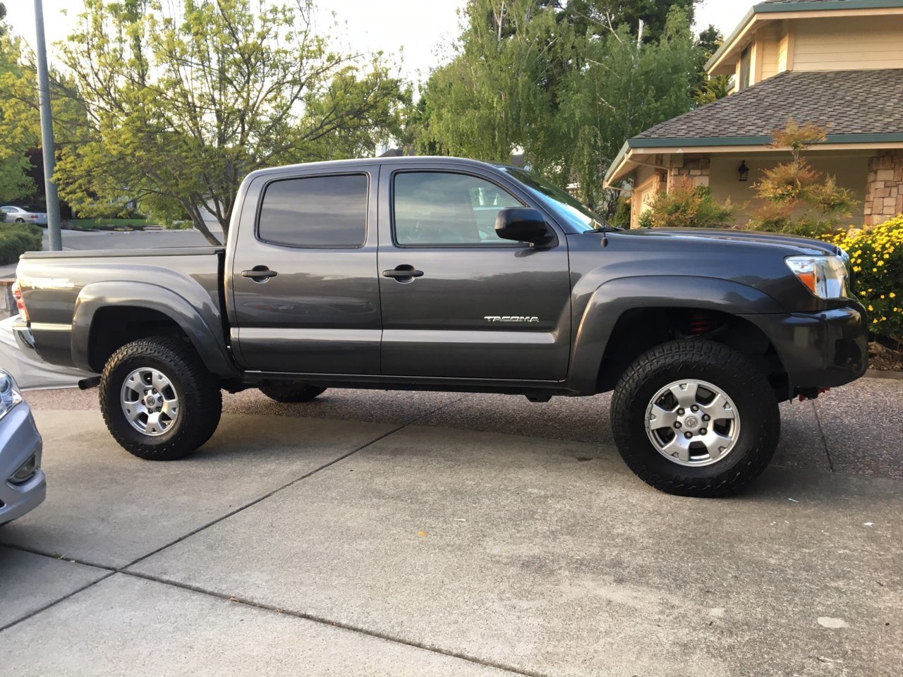

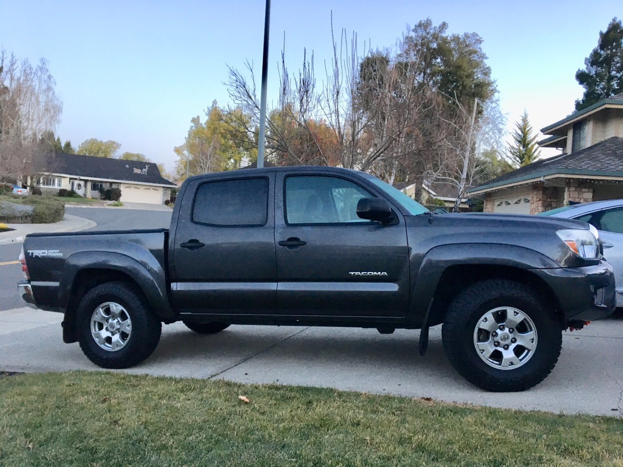

    Installed this kit a little over a month ago with the General Springs HD leaf pack. The stock suspension with 75 k must have been pretty sacked because I was at 20.0" front and 21.0" rear before, and now 22.5" front and 23.75" rear after install, measured center of hub to fender. The ride is great. I probably have a thousand miles on it. There are a couple of whooptie sections on my freeway commute that were "kinda like fun, only different" with the "floaty" stockers.The TRD Pro setup handles them like a..."Pro". The rear leafs had some creaking after a week, but that went away after 3 weeks. Rides smooth and quiet now. No weird vibes and it aligned no problem. Sliders are ordered and next. Can't wait to get it on some dirt this summer.
