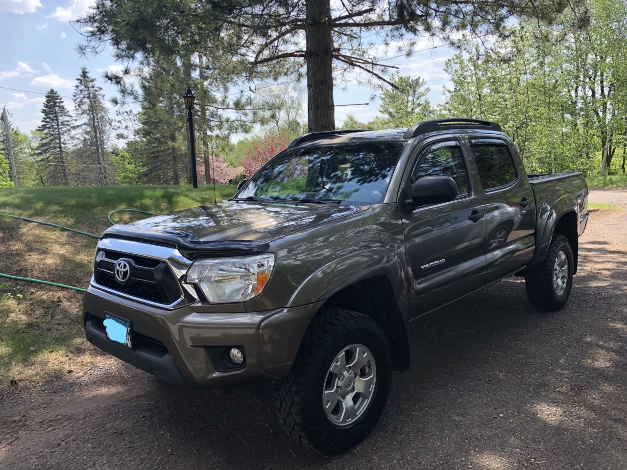

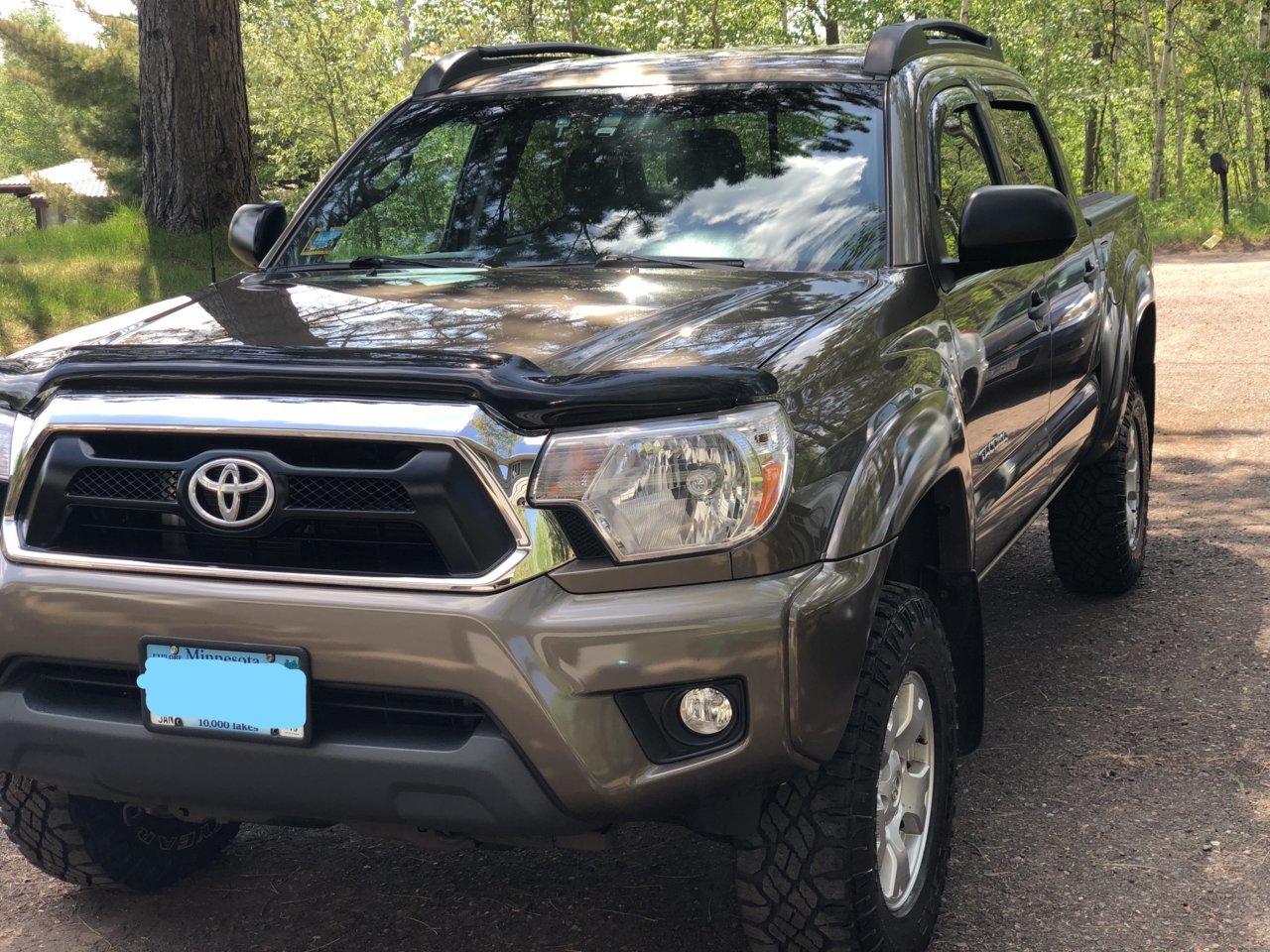

    I hear ya. I was in the same position and finally decided on the HS 3 leaf progressive. I'm happy with my decision and figure I'll replace the entire leaf pack someday if/when it becomes necessary. I'll try to get a pic of how mine is sitting now. I think I had a little weight in the bed in my previous pics for winter traction. Bed is empty now.

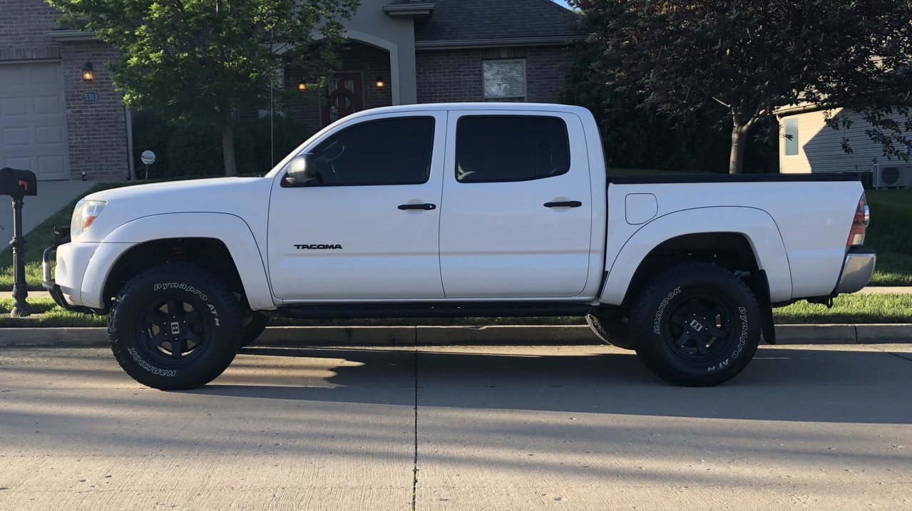

    One more photo to help others decide. I just took this photo on almost-level ground with the image leveled at the bottom of the tires as good as possible from an iPhone. Specs are a 2010 V6 4x4 with the TRD pro kit installed, a 4-leaf TSB pack in the rear with the overload removed and an Icon 3 leaf AAL. 6 total leaves. The TSB pack has an estimated 30k miles on it.
    Measurements show 1” rake; 22.5” front, 23.5” rear, center of wheel to fender. I don’t tow, or have a camper shell, and I don’t haul full bed loads regularly, so I’m fine with this rake. But I’d be just as fine with another 1/2” of rake from my overload leaf, which would have basically been a spacer, since it was flat and wasn’t adding anything to the arch anyway. Hope it helps someone.

    Thanks guys. This does help in narrowing down options.

    Definitely can see a little rake there.

    The angles aren't the greatest, but this is all I've got right now. I'll try to take a side view tomorrow.
