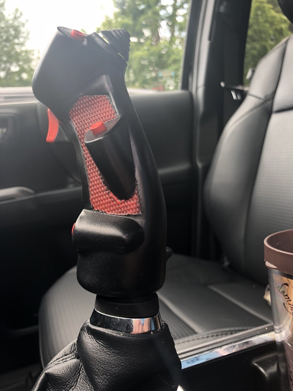

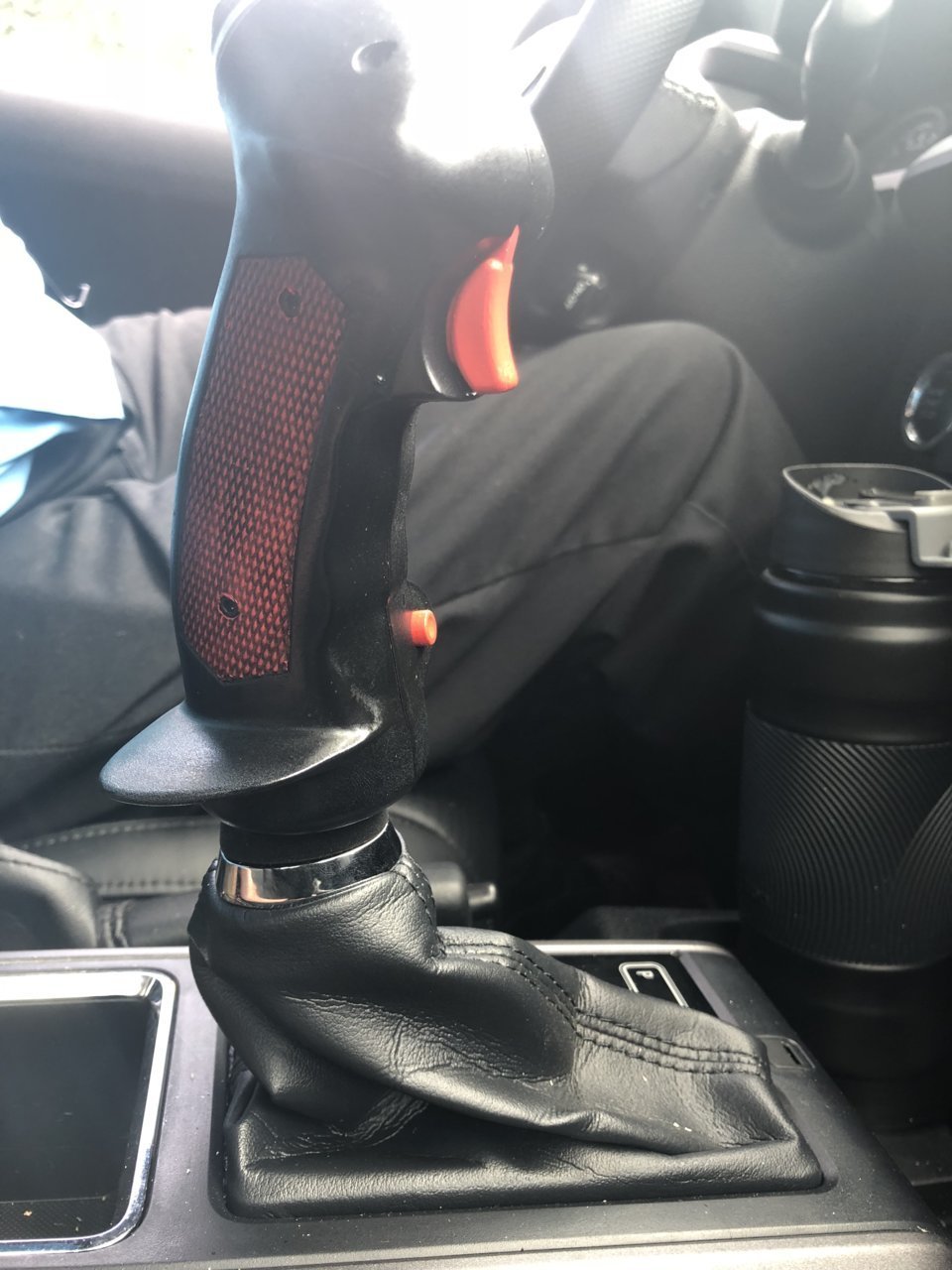

    And just in case anyone is making a custom shifter knob themselves, the connector that he designed for the boot works perfectly with the factory boot connector. Screwed it on with two screws to the shifter and it works flawlessly.
