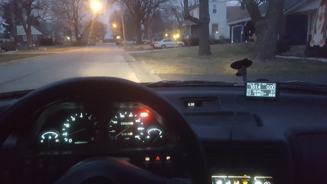

    dont have a working speedo in the oe cluster since it was cable driven. so i installed an ultragauge em+
    a few digital readouts are nice without having to hook up my phone bluetooth to the ecu everytime.
    ECT, MPH, Short Trim, Long Trim, ODO, Trip

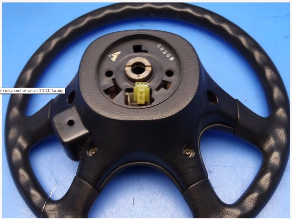

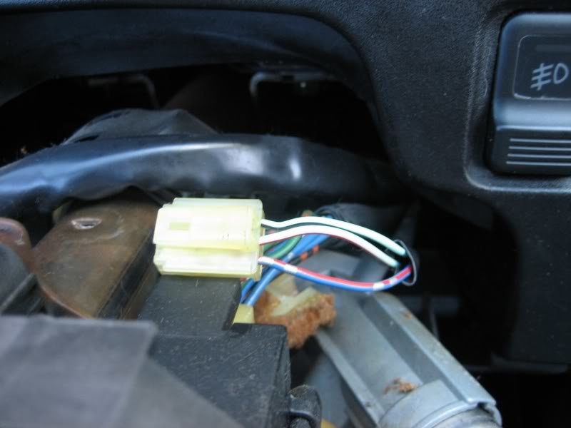

    am i missing something? i know the dc2 had the ring terminal that supplied voltage to the horn/cruise stuff. but my da has this plug at the steering wheel and the same plug on the column side. :confused: my horn works if i jump the correct wires between the two. i tried it but when turning the wire ends up getting pulled.
    i ordered a nrg steering wheel/hub to replace it. im pretty sure im missing something stock and i dont want to track it down.

    Do you have your clock spring between the wheel and column?

    that must be what is missing then. not sure why anyone would have taken it out.

    Yeah not sure. If you don't care about a horn, cruise, or airbags, then it's not really needed I suppose.

    i just want the horn since the car is so tiny. ill put an aftermarket steering wheel in and take care of that problem.
    no airbags in the da from the factory and cruise doesnt work with the swap.

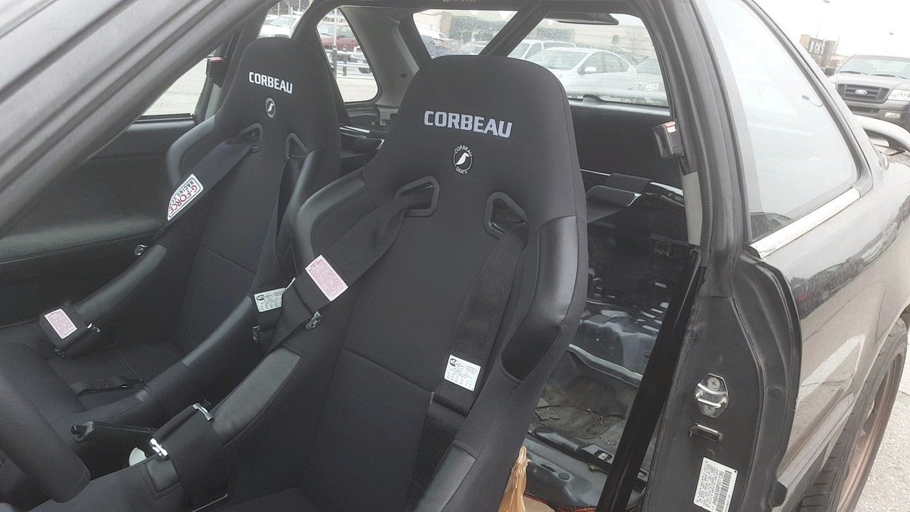

    Installed:
    Gforce 5pt harnesses
    Autopower Roll Bar
    NRG steering wheel/quick release/hub

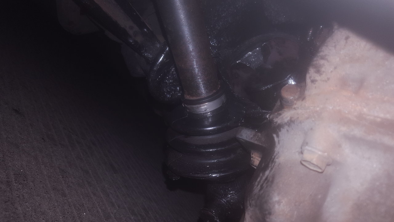

    so apparently driving 720 miles in a day with a torn axle boot (which i didnt know about till ~500 miles in) leads to a destroyed axle..
    completely busted the interior joint on the passenger side. im extremely happy it didnt happen on the highway and only happened while at a stop light a few blocks away from home. Replacement axle is already on order

    you lucked out with that not happening at the freeway. are 2nd gen integra's lighter than 3rd gen integra's ?

    i know, i was super lucky. probably would have taken out the back of the motor.
