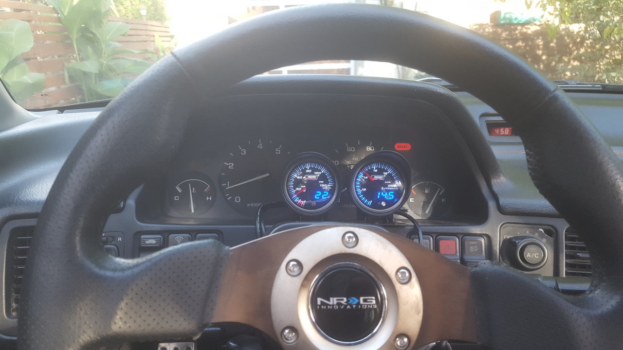

    installed the oil pressure sensor for the prosport gauge yesterday. that wasnt very fun with the engine in the car. no leaks today, haha

    wired up the gauge this evening for oil pressure and moved them closer to the cluster. they block the non-working speedo so no big deal.
