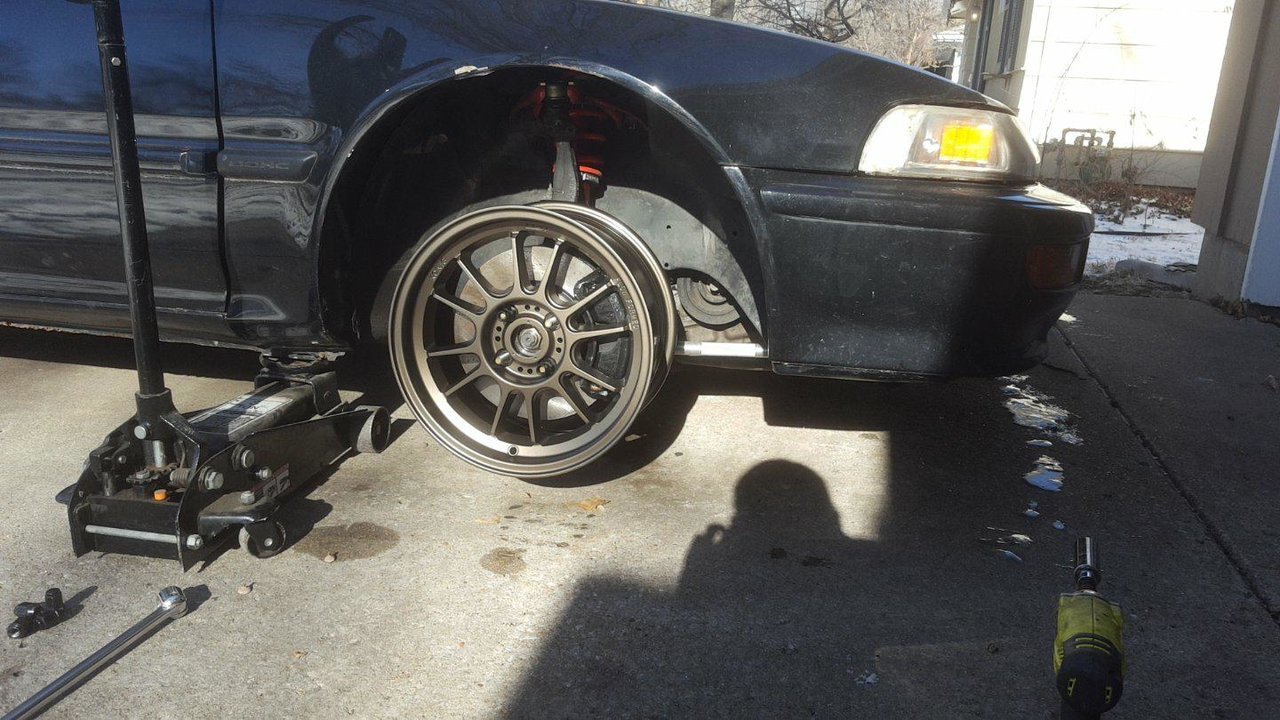

    not that anyone was wondering but 15inch rpf1s do not clear ITR front brakes. so welcome 2inch front wheel spacers.. (1.25 would have worked but arp extended studs prevented that too)

    front wheel spacers installed (2inch), car has a pretty aggressive front look now so i think i need wide wheels and tires then the widebody :laugh:

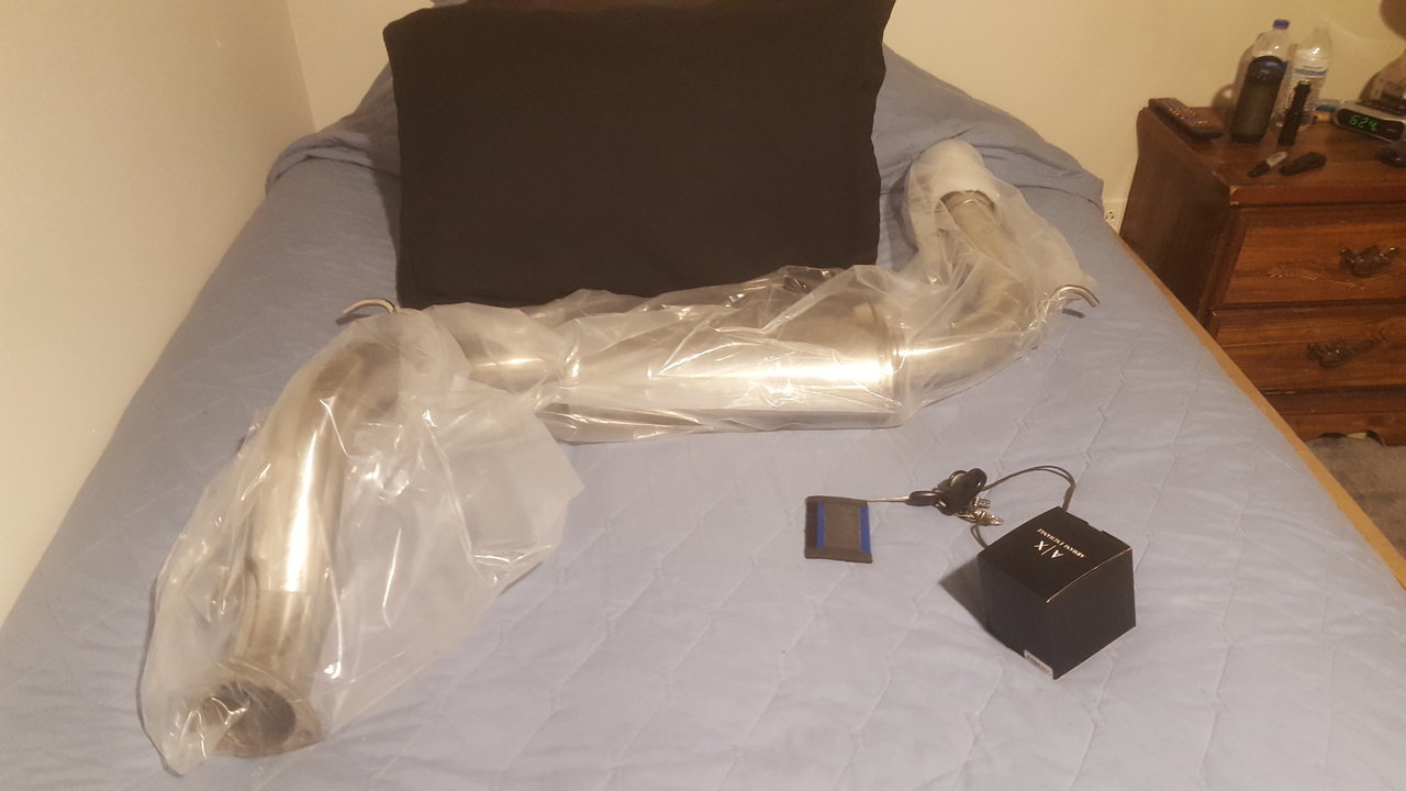

    thermal exhaust arrived today, earlier than ship eta. no complaint from me.

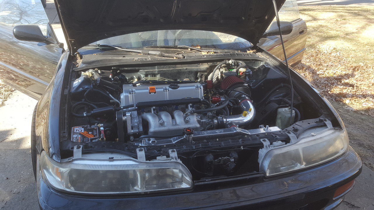

    my engine bay is ugly but whatever

    should be around 230whp.

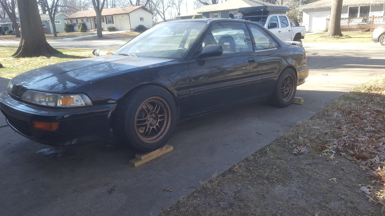

    1st drive with the k was today to get the exhaust modified. still loud. oops. need new wheels that will actually fit under the fender without spacers so i ordered a single konig hypergram 15x7.5 +35 before ordering the other 3. the fenders currently got chewed up a little by the wheels and current height. i dont want to raise the front though since the rear cant go up anymore without longer springs. i also like the ride height.

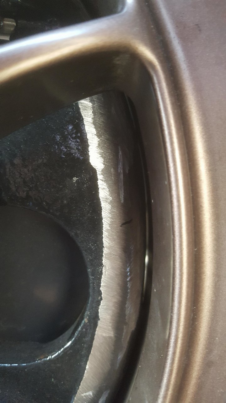

    so konig hypergram fits perfectly without any spacers since it doesnt have a barrel drop center. but i dont want to hassle with selling the rpf1s at this time so i am working on grinding my calipers down to get clearance. not enough to affect structural integrity though. passenger side is now taken care of. tomorrow ill probably start working on the driver.
    havent decided to return the hypergram or keep it for a spare wheel in case something goes wrong.
