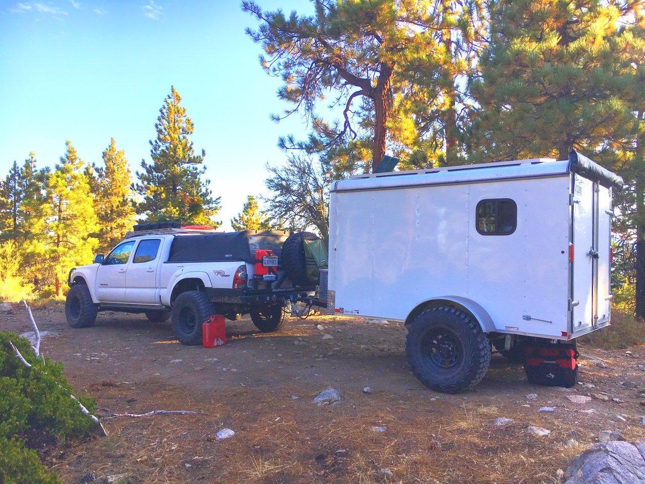

    So I’ve decided to put the trailer up for sale. I have anoher dog now and practicing to have another kid. Things will be a little cramped with all of us in here. It’s perfect for a couple, maybe a kid, and a dog or 2 at the most.
    Here is all the stuff done to the trailer
    Windows
    Tongue storage box
    Deep cycle Battery
    2 renogy 100w Solar panels
    30 amp Solar charger controller
    Insulation
    New 6 lug axle w/ Electric brakes
    Trailer brakeaway kit
    Trailer brakeaway battery charger
    Jeep YJ 4” leaf springs
    WFO Concepts leaf spring hardware, shackles, and axle perches
    E track for bed platform
    Custom memory foam mattress
    (2) 17” pro comp steel wheels
    (2) 35” Good year MT/R tires
    6’ Tepui Awning
    Max coupler hitch
    Weld on swivel tongue jack
    12v Roof vent fan
    Interior LED lights
    Fenders
    I’ve put a decent amount of time into this trailer. It works great and I am reluctant to sell but know that we’re not gonna be able to use it much longer. I’d love to sell it to someone who wants a trailer that is ready to go.
    The trailer is the perfect size to be able to comfortably sleep in but also small enough to where you can go further away from the beaten bath and get away from campgrounds.
    I’m looking to get $6500 but I’m open to offers. If you’re interested. You can message me here or call or text me at 310-741-2871
    I’m located in Lomita CA 90717

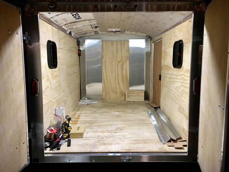

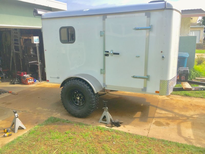

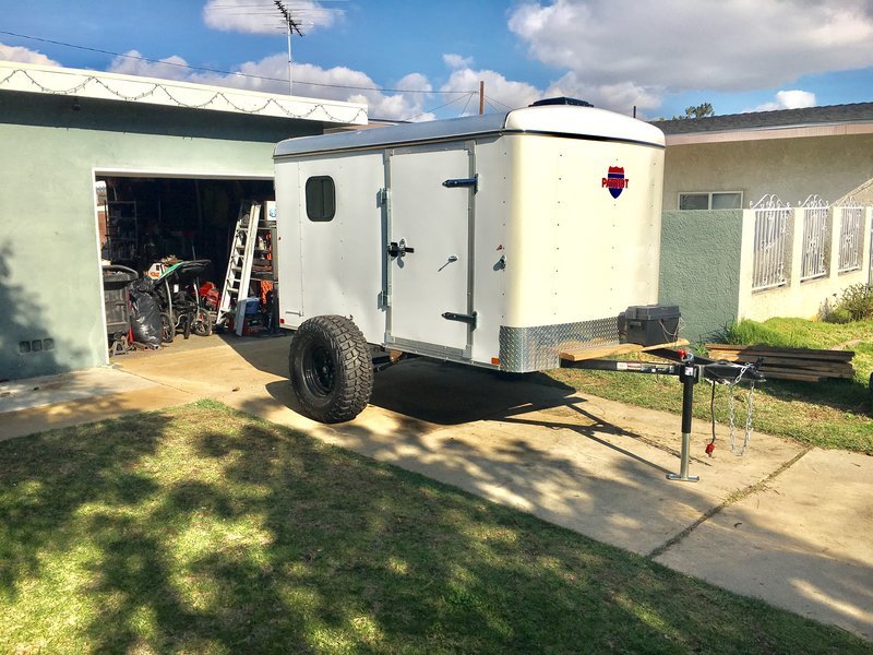

    My little family and I recently went on vacation and on our way back we picked up a 6x10 enclosed cargo trailer with a side door and 2 rear barn style doors.
    It comes with dinky little trailer springs, a 5 lug axle, a ball style hitch, and 14" tires. Plans are to cut the ball style hitch off and weld on a 2" receiver to be able to use a Max Coupler hitch. Then I'm going to buy a new 6 on 5.5 axle to match the lug pattern of the truck. Then I plan on cutting off the tiny trailer springs and upgrade those. Also it will be getting matching 35 inch Goodyear MT/R's. After that small bit of outside work I will be focusing a lot on the inside.
    Inside will get cabinetry, drawers, fold down bed platform, insulation in the walls, 2 windows, lighting, and more. I will also be adding solar panels to the roof.

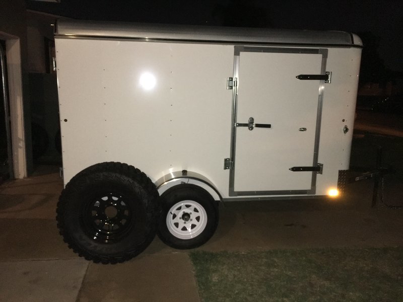

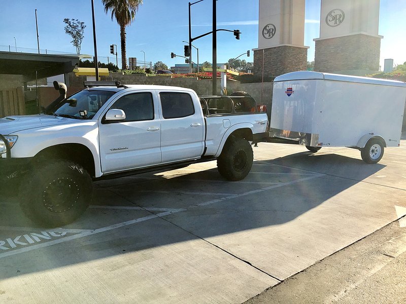

    Just picked it up and on my way home
    35's which will give the trailer 10 inches of additional clearance over the stock tires.
