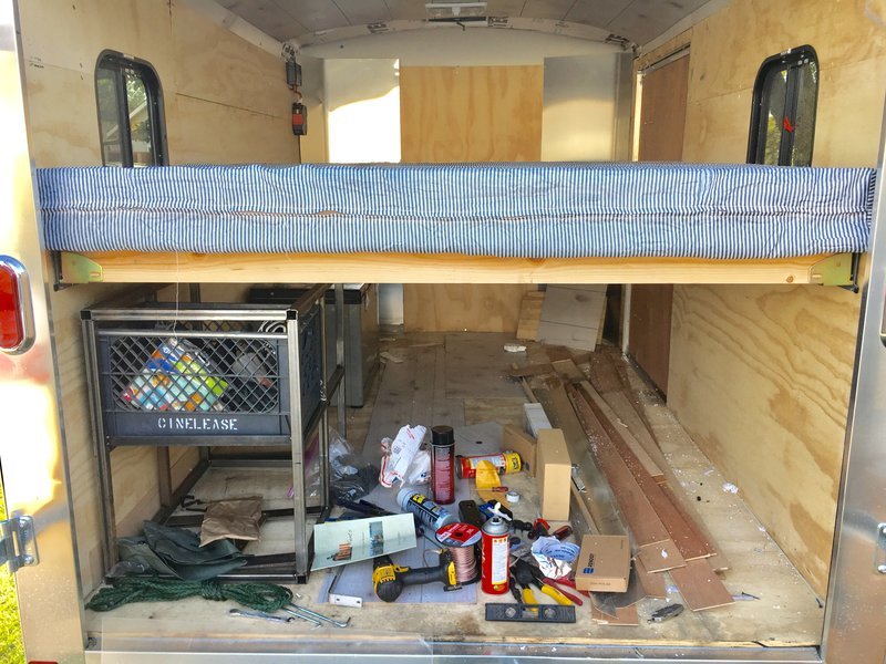

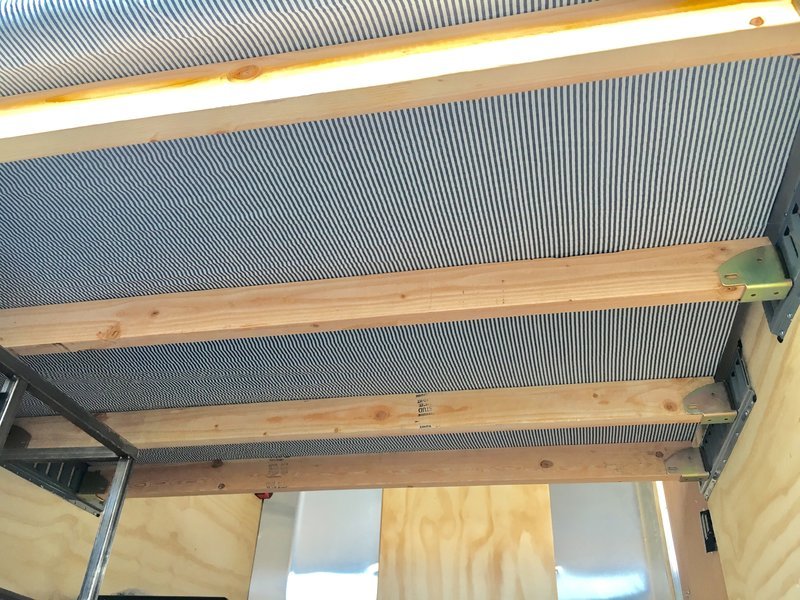

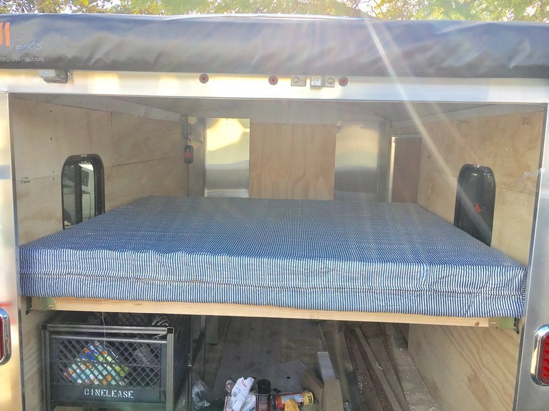

    Just got home from Big Bear and my mattress for the trailer got here! It's so frickin cool! It's probably the thing that has gotten me most excited about this trailer so far because it looks so awesome and makes the trailer feel so much closer to being ready! The one thing I was worried about was that the 4 2x4 supports wouldn't be enough to displace the load of people sleeping without sinking through, but the density of the foam is great and doesn't make you feel like you'll sink through even if you lay right in between the 2x4's
    Excuse the huge mess underneath the bed lol

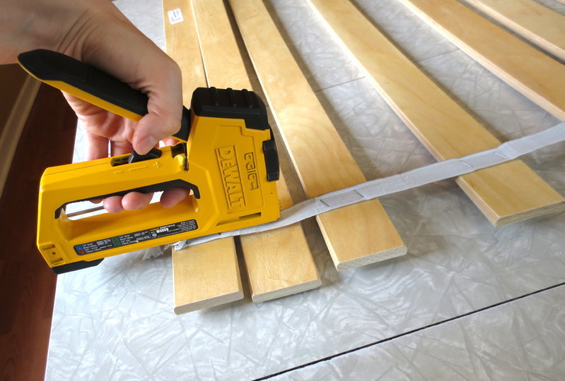

    If you're worried about extra support under the mattress, I would look at doing some thin slats running perpendicular to the 2x4's, use some nylon webbing secured to the slats so you can in essence "roll up" the support slats.
    Something along these lines...

    That's a great idea! I like it! Thanks man
