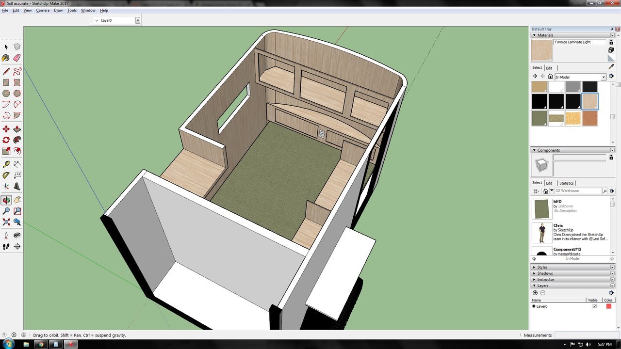

    Here's a preliminary model of the interior. Rear will be a galley. That port out the drivers side was going to be for a through the wall AC but I decided I don't need that.

    What software program is that? I’ve been looking for something like that for some stuff I’m going to build

    Sketchup Make: https://www.sketchup.com/download/all
    It's free and absolutely amazing. It used to be owned by google and called Google Sketchup. I started using it back then. Then it was purchased by Trimble. They made a paid version but thankfully kept a free version that does everything normal hobbyists need it to do. Like all 3D modeling software it takes a bit to get used to but once you know it, it's great.
    My main tip with the software would be to know that when you are creating shapes, you can type in what you want their dimensions to be. So if you click a rectangle you can drag it to the approximate size but then just start typing 6',2' and it will make a 6 foot by 2 foot rectangle. Your default units will be inches so 6,2 would be 6"x2". I couldn't live without sketchup
