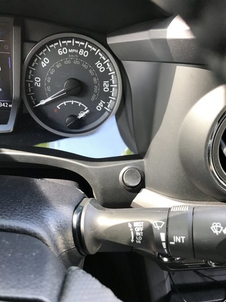

    Just wanted to send a shoutout to jshsltr for this harness and those who contributed info and wiring ideas. I used the harness and a DPDT switch to setup the vechile in motion override and rear camera on demand mod. Ended up using the small Digi-Key switch and placed on the gauge surround behind the wiper Switch as in the attached picture. I set it up so that up is normal factory, middle is nav override, and down is backup camera on. Works like a charm and at $20 is hard to beat.

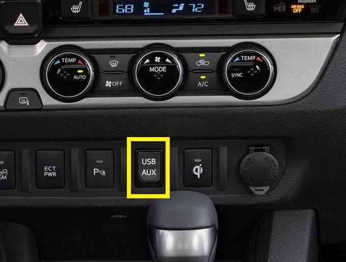

    That is the 1st I've heard of the AUX supporting video. I was under the impression you had to get the A/V source to appear on the head unit or does the source appear when the video is detected in the AUX port? Is there any confirmation of this? (Photo for ref.)

    @jshsltr Tested last night with an old camcorder, no video is detected (Audio only) on the HU using the 4-pole 3.5mm connector in the AUX port. Plugged the same test rig into an old insignia headrest LCD and it worked fine. Any ideas?

    The only other way I have found to input an A/V signal is using pins 13/14 and 26/27/28 on the harness. The pinout is available in this thread. I attached rca cable to those pins on my harness, but have never added an A/V source to verify function.
