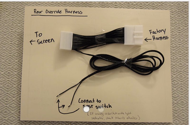

    Interested in this harness, will be using for anytime rear camera, and gps override. Do you offer a kit with it already being modified just so I can connect the harness, then connect my switches? Something like this IMG_1940.PNG.jpg
    I rather support a TW member than a company I found on google.
  14. Jun 8, 2017 at 1:40 PM
    #234
    jshsltr
    jshsltr [OP] Well-Known Member
    Sep 3, 2012
    #86120
    1,056
    Josh
    St Louis
    I can definitely make a kit up just like this. What type of switches will you be using?
    You can PM me the details if you like.
