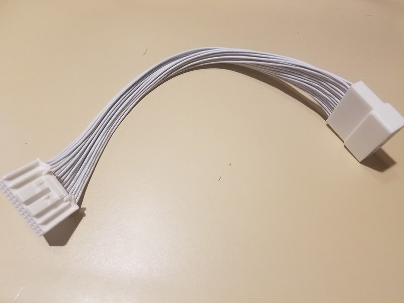

    I have a switch in mine, but have left it in override position for extended period of time and have not seen a difference except for the capability to use the previously locked out functions. You can easily make this permanent without a switch by simply cutting or removing the 17 wire from the harness.

    If you remove the wire, you can always put it back or add a switch if there ends up being some negative affect in the future.

    Ordered. Now I gotta figure out how to do a rear camera on/off switch and add an aux input to the headunit...

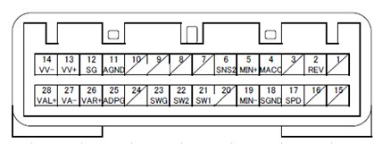

    This will help. As viewed from the back side of the HU end of harness.
    For the reverse camera you need to feed 12v to pin 2. Cut the wire to pin 2. Solder diode between the leads (striped end of diode toward HU). Then connect switched 12v source to the HU side of the diode.
    The aux video input is on pins 13,14. You can cut off the female end of RCA cable. The shield wire goes to pin 14. The signal wire goes to pin 13.
    Aux audio can also be wired of desired. L+ audio signal on 28, R+ on 26. The shielding from both audio cables should be tied together and connected on pin 27.
    I believe (but not tested) that the aux jack on the usb block is tied to these inputs, so if you leave the factory harness side of these inputs disconnected, the aux jack will not work.
    Also, I have read that the aux video will not work while the vehicle is in motion unless the SPD lockout override is done.

    From my reading of the FSM, this is correct. Those two audio wires go to the AUX/USB assembly.
